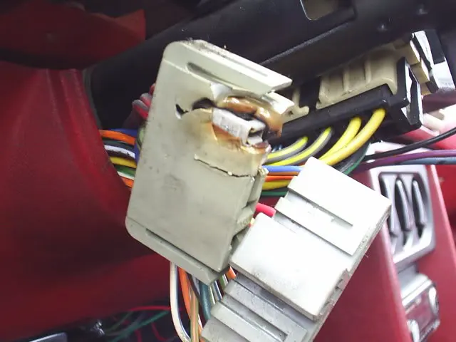

The problem is a failed multifunction switch or wiring that has overheated and melted the plastic connector shell that holds the electrical contacts.

Same EXACT problem you had. Almost certain its the multifunction switch. If you take it apart, i bet theres some burnt wires in there, probably even melted the plastic.

ahhh memories...

ah yes very familar sight BMORRIS
