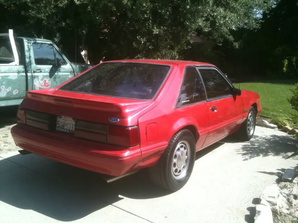

Hey guys I just wanted to introduce myself. I bought a 92 LX hatch last week for $1800. I just got her registered as no-op and I'm getting ready to fix her up a bit. The car has a few mods already but I don't mind. It's pretty hard to find a stock one for a good price anyway. Here's a picture of the car. Just one for now until I can get my camera back.
I've got a good bit of bodywork ahead of me. There's dents on the bottoms of the quarterpanels and I'll need new bumpers. I plan on doing the body work myself and then having my dad spray the car. Not sure on the color yet. I'm also not sure what to do with the motor. The motor and transmission feel fine (no smoke, the clutch doesn't slip, no grinds) and the car runs well though I think I noticed a bit of a surging idle. There's a little oil leak somewhere but that's nothing some fresh gaskets shouldn't fix. I've worked on 4 bangers both pushrod and overhead cam in the past but a v8 should be a real treat.
