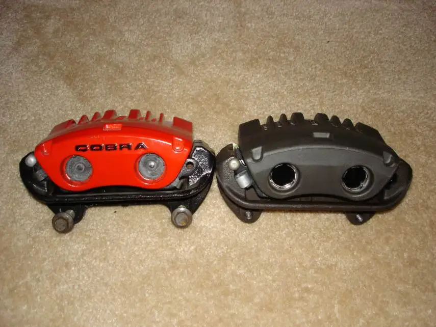

Well smart guy, since you’ve got your facts mixed up a little bit, here’s something for you to think about!!! Based on the weight of the car and the rotational mass of the stock wheel/tire combinations, the dual piston calipers that came with the car do a much better job of slowing it down when you compare the old single piston versions on the earlier SN95's, or the single piston disk/drum brakes on the Fox's. This is the reason I asked!
On top of that, the multiple piston design doesn't necessarily do a much better job of "putting on the binders" so to speak, but allows the operator to modulate the brakes more precisely under braking reducing the possibility of fade. It does this by applying pressure to the brake pad more evenly over the entire area of the pad, rather than just the center of it. It’s the larger rotor that controls the majority of the ability to “slow the car down” by allowing room for larger brake pads and more over all surface area. This allows for more material on the rotor and the ability to more efficiently dissipate heat.
My question was legitimate, since it’s well known the stock brakes do a decent job of slowing the new edge mustangs down in comparison to the earlier versions that were bolted basically onto the same car. You state you have limited funds, so you might want to consider things like an alternative designed rotor, ceramic brake pads or just simply changing the way you torque your wheels on.
