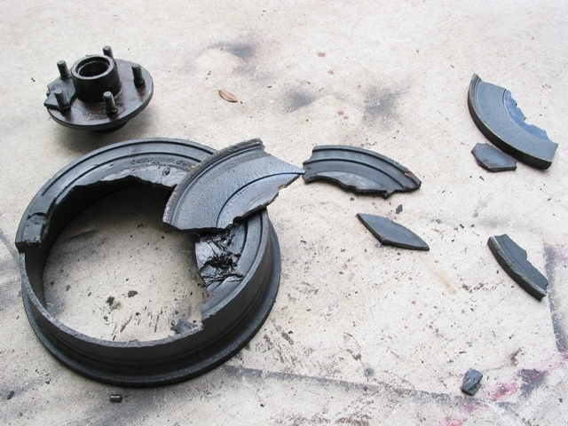

Do you think the drums could be broken with a 5 pound sledge? I hadn't thought of that but it IS an option. If I still can't get her I'll find a shop with a hydraulic press.

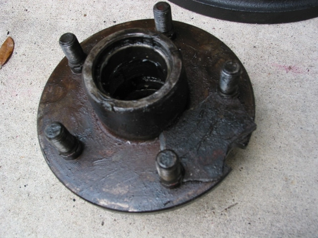

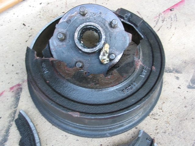

I didn't even try the torch or the claw hammer...went straight for the BFH. Had them apart ("apart" is an understatement) in about 3 whacks each, less time than it would have taken to make that pot of coffee :D

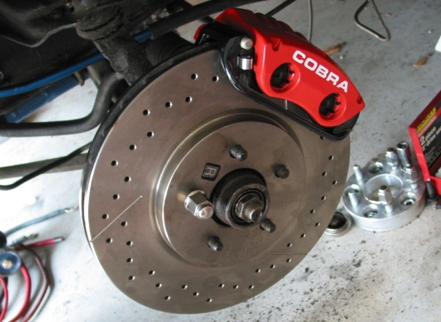

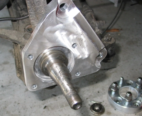

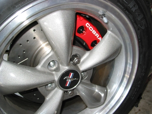

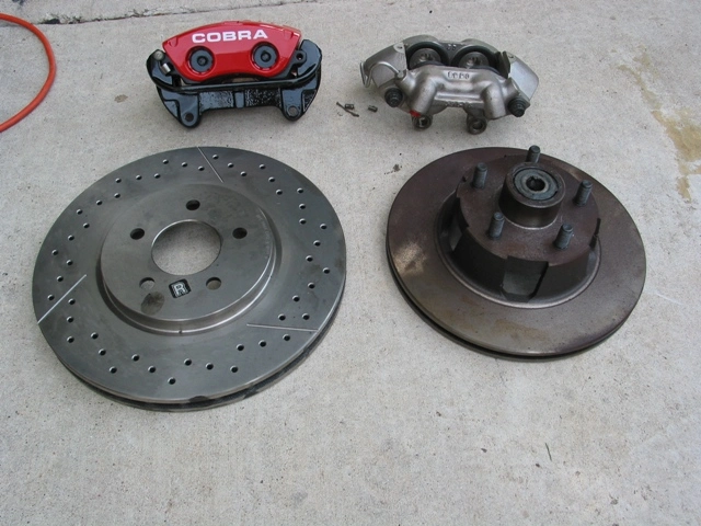

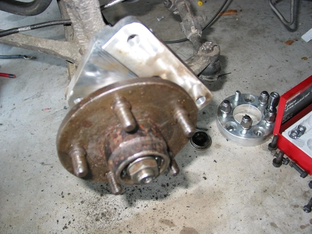

Did a test fit of the 13-inch Cobra rotors and calipers this morning. There's an issue I'll have to ask Steve about but figured I'd share some pictures...
Old versus new.
The adapter bracket.
The drum brake hub.

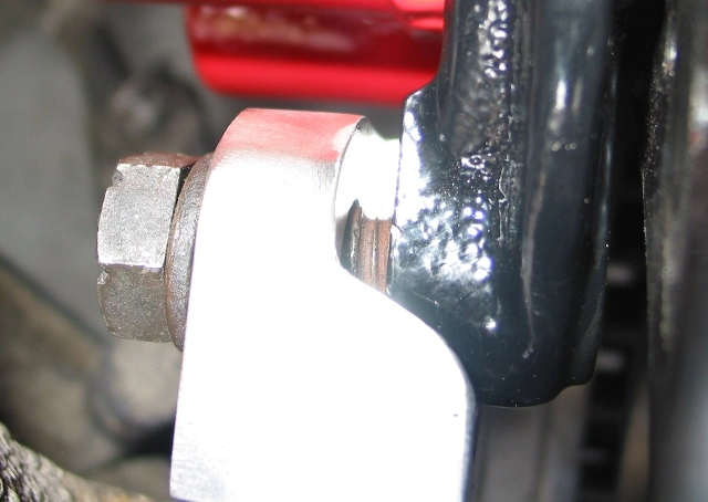

The issue I have to ask Steve about.

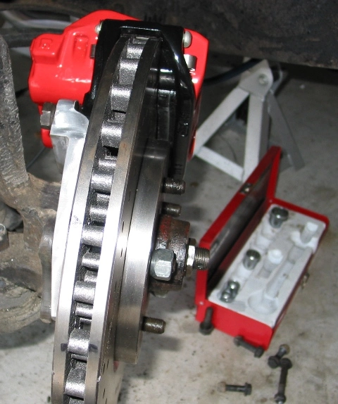

Rotor and caliper in place.
Just another angle.
Wheel on.
