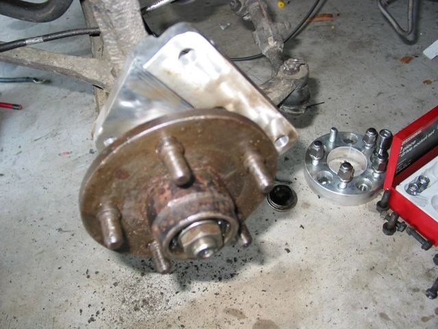

Did a test fit of the 13-inch Cobra rotors and calipers this morning. There's an issue I'll have to ask Steve about but figured I'd share some pictures...
The drum brake hub.
Please tell me you, at least, wire brushed that hub before you re-installed it. I would have media blasted it. :)

Hehehe, it was just a trial fit, to make sure everything was copacetic (which it wasn't). I intend to disassemble the entire thing, heck it even has the old bearings in there, without the cage-nut or cotter pins :D
Update: I got in touch with Steve and he said there should not be a need for shims at all. After he looked at my pictures he said it looks like the rotor is not seated all the way down on the hub. If you look at that picture that Agent Smith...errrr....jeepers posted you can clearly see the shoulders of the wheel studs. According to Steve the rotor needs to be pressed onto those studs. That would explain the gap alright.

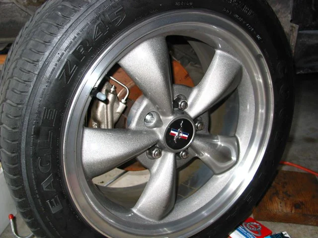

Ok, what's the finished product really look like?
Pretty much like that last picture, the rotor is an additional 5/32 more inboard I guess :D
One addtional benefit for me since I have late-model wheels is that it moved the rotor much further out making it look better than it did with the stock rotors. Compare to this older photo:
