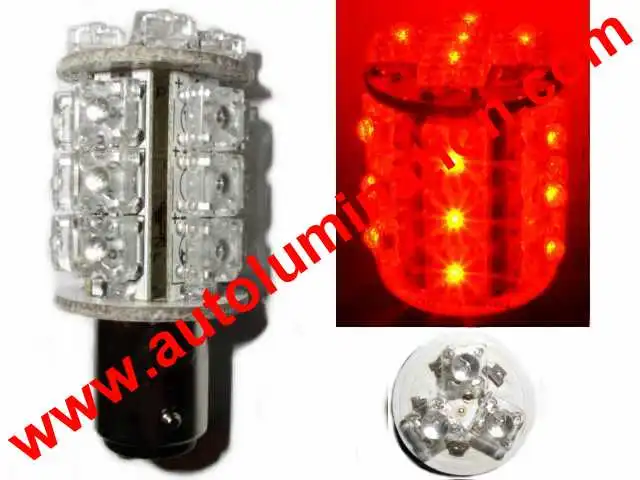

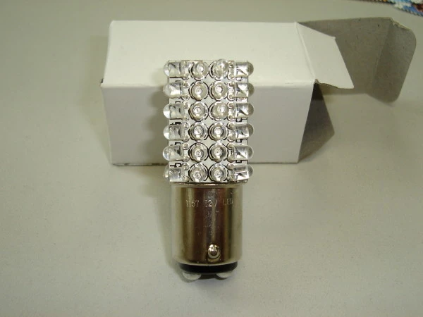

forget the led bulbs...i went and tried some of the ones you can get almost anywhere and they just shine bright, but straight out the back, and were pretty much blocked by the long plastic strip on my Cobra lights. they dont reflect around the housing good at all
Well the style that face only out arent going to reflect off the housing very well at all.
Stick to this style LED bulb and you will have better luck.

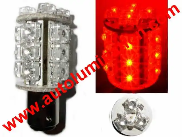

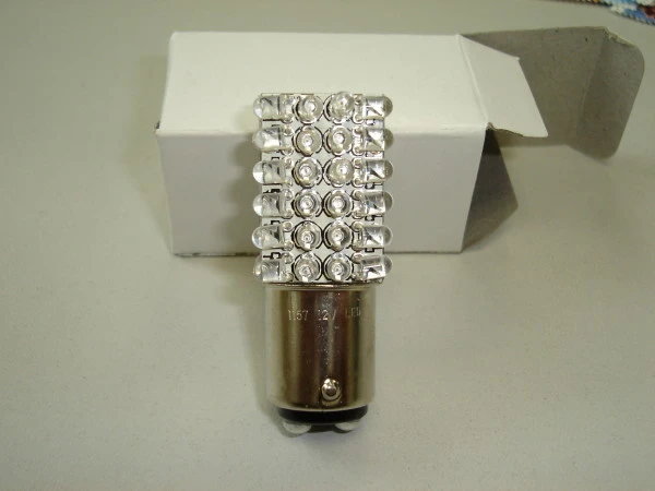

The problem with those LED's is that even though they spread the light all over, the original bulb is still brighter.
I have first hand expeirence. I swapped the reverse lights and lisence plate bulbs on my GT to LED and test ran the bulbs in the taillights. They are the same 18-20 LED bulbs as above, but just not as bright as the original old-style bulb.
They look cool as hell though :)
They are white, but look purple in the pic.
(taillights are normal bulbs, i didn't take a pic with the LED's in, but they are a tad bit dimmer)
