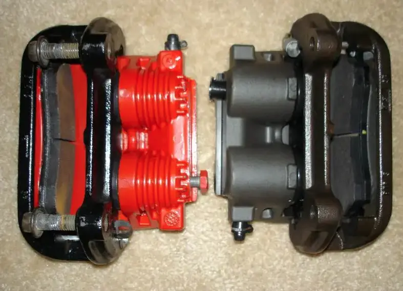

Easy way to tell is to cut the wheel and look behind at the piston bores. 94-98 are ribbed, 99-04 are smooth

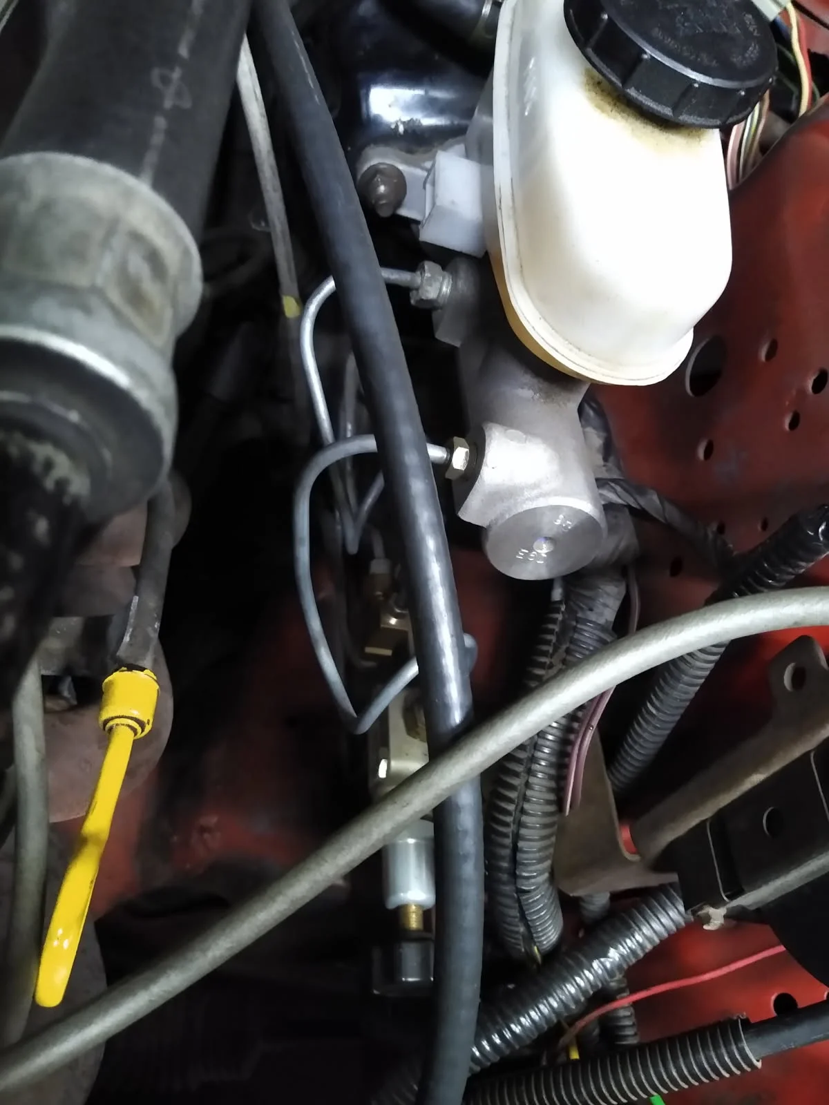

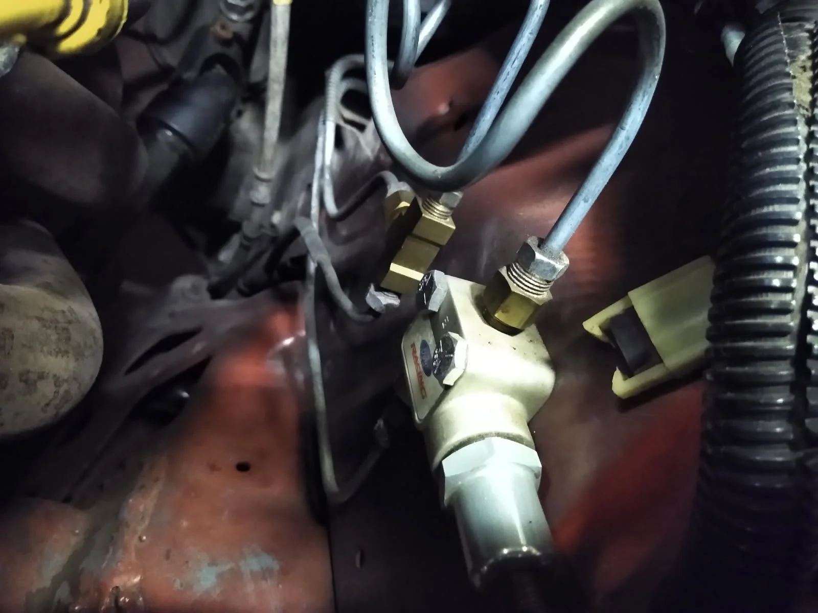

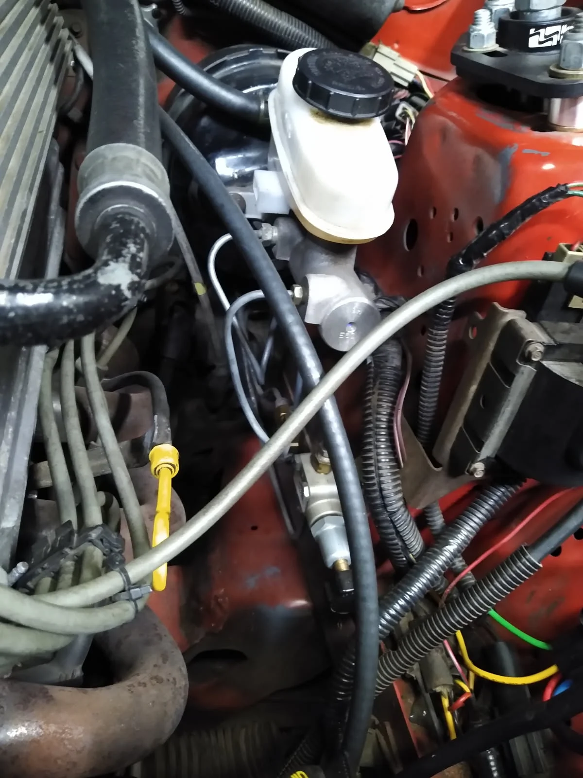

The FRPP prop valve bolts up using the same holes the stock combo valve used. Other than MM kit MMBAK-9 all of the brake lines are stock and untouched.
Went this route because the prop valve on the passenger side looks like s*&t IMO, looks unfinished and out of place.

Looks like stock combination valve is still in there to me and the manual proportioning valve was just mounted in front of it in lieu of the typical installation spot over on the passenger side firewall.
