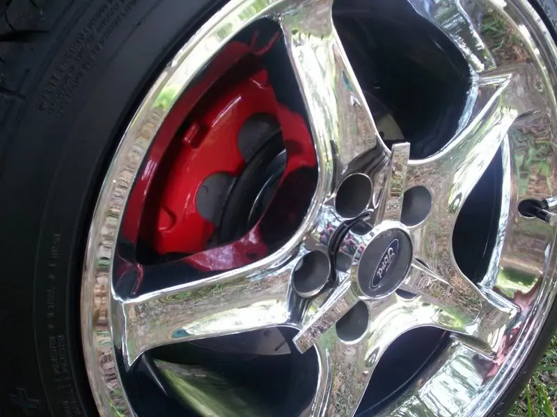

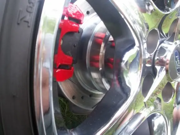

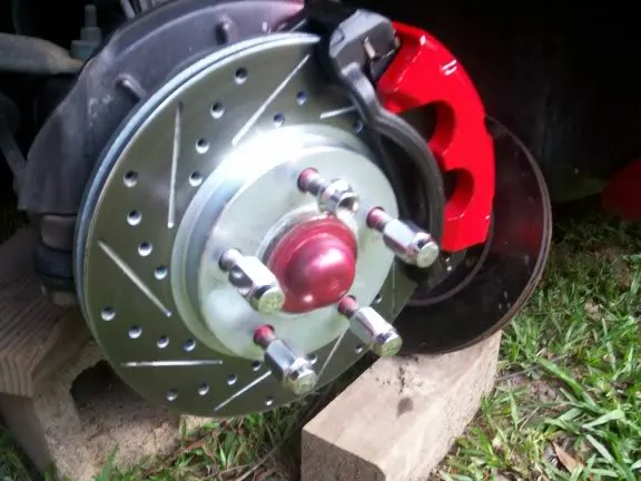

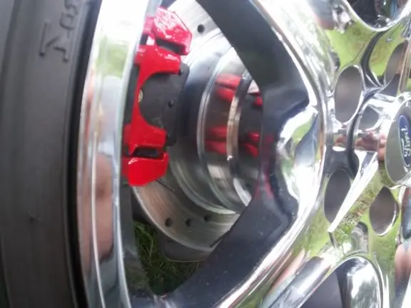

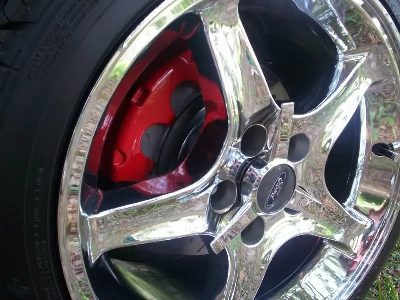

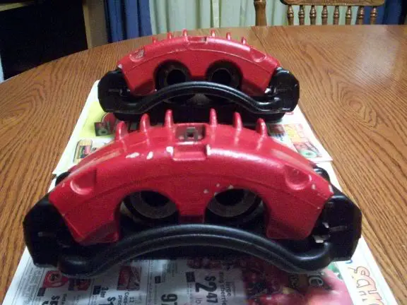

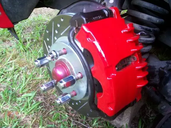

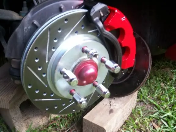

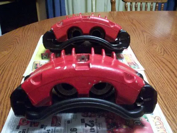

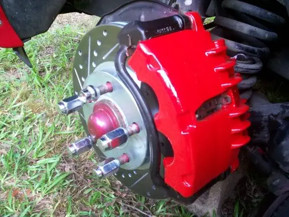

i added some drilled and slotted rotors and a pbr dual piston upgrade, the calipers i used were removed from a 2000 mustang GT...read about it in the link below it cost me less about $300 and i was impressed with the results.
http://sn95brakes.com/sn95brakes.php
rear brakes remained factory but i added the drilled and slotted rotors...
