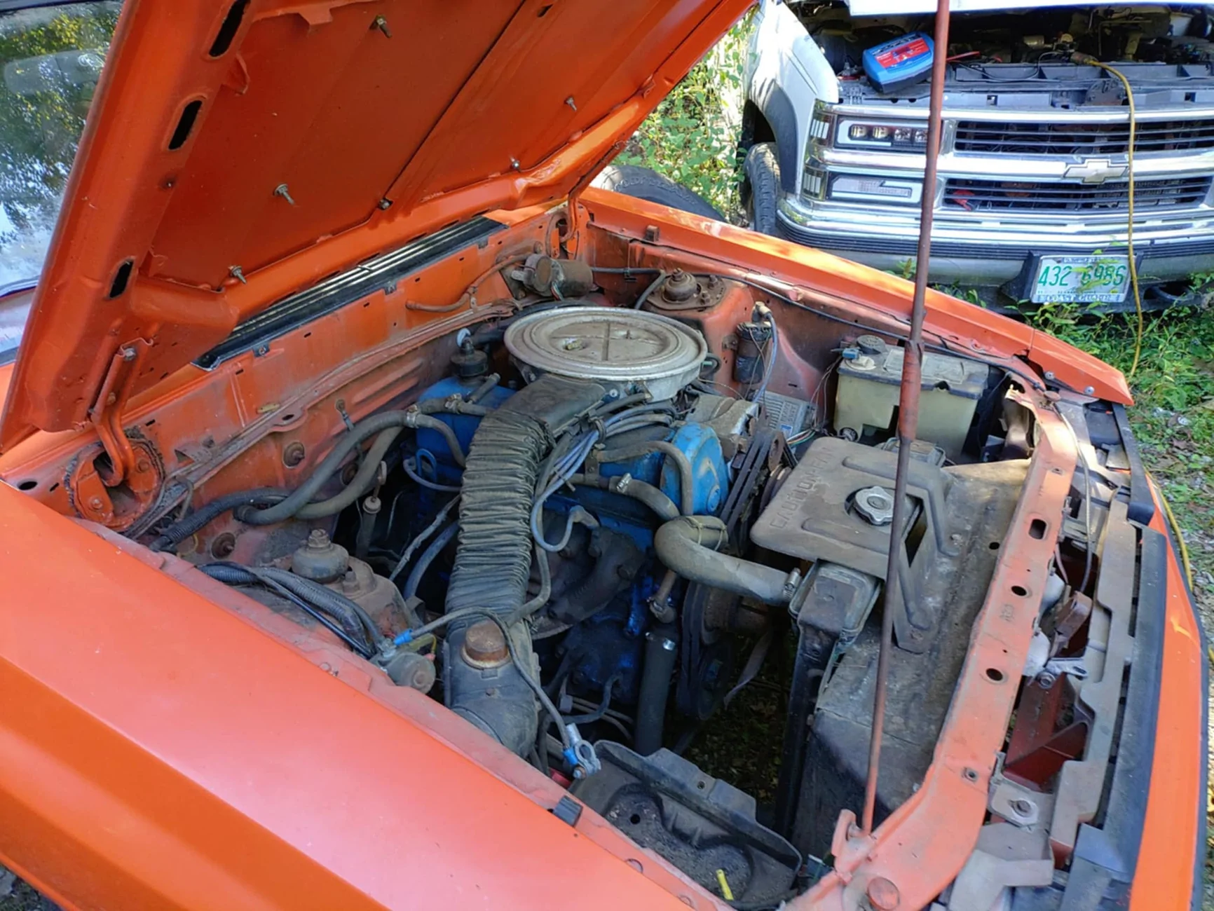

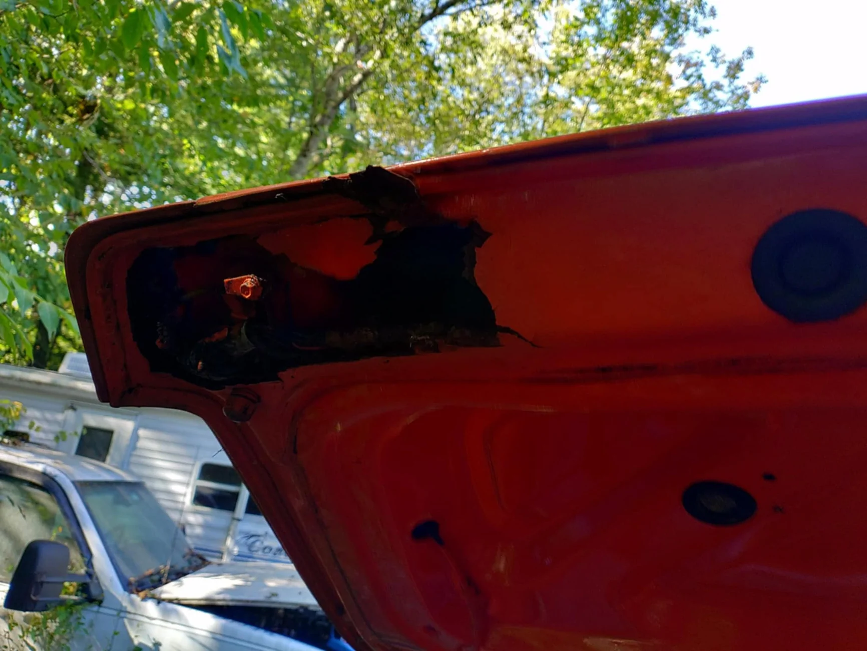

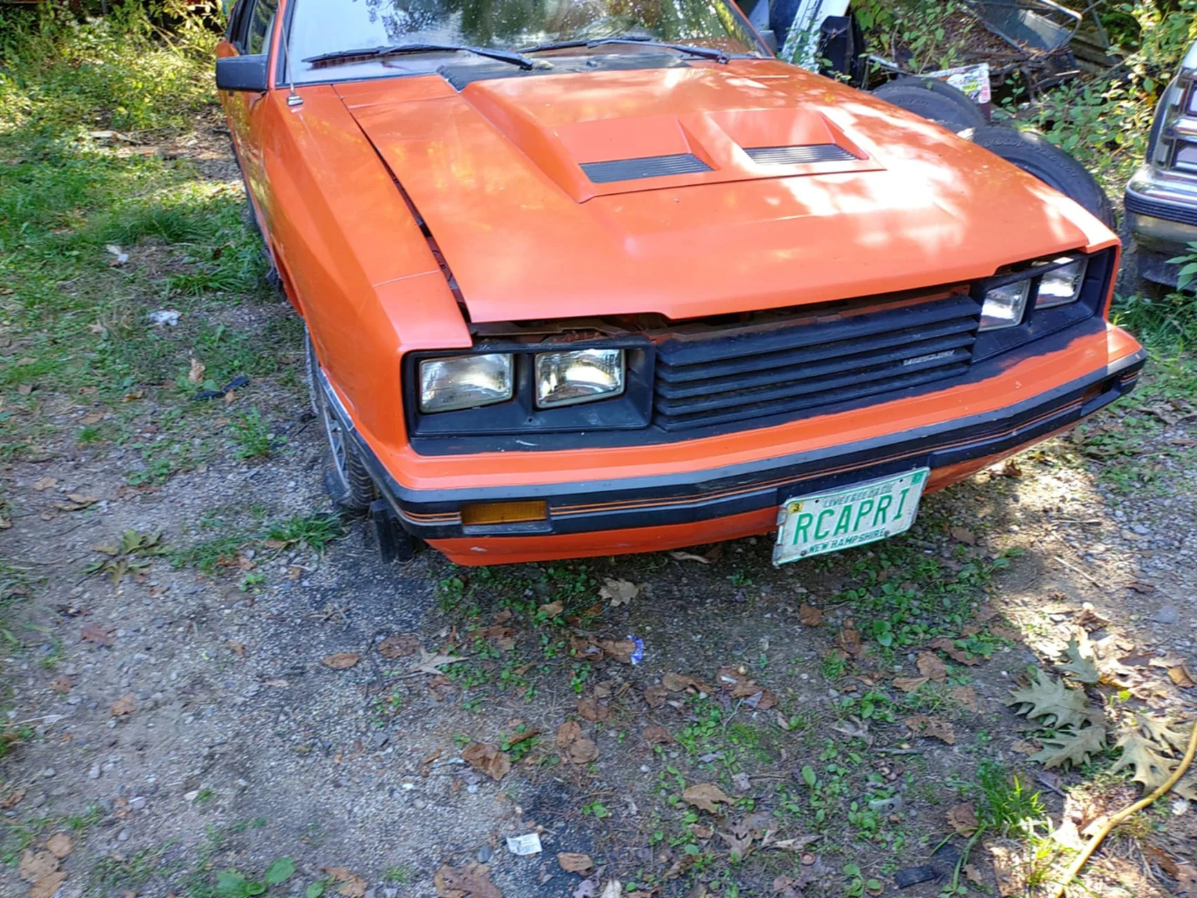

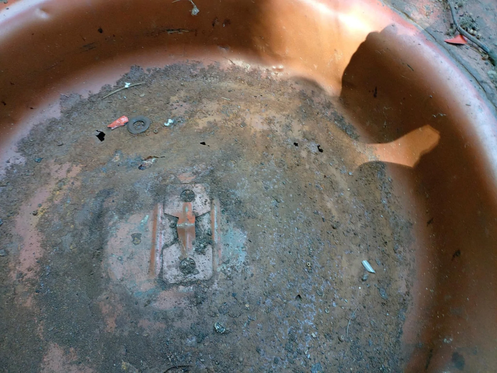

My wife's dad bought it new, 1980 Capri RS with 2.3, right before she was born. It was the car she came home from the hospital as a newborn in! However, after many years NH winter weather got the best of it. It got hit 20 years ago, so he started a restoration, paint came out nice and he had plans for a V8 swap, but lost interest .. However he never fully sealed the hatch wing, it got water in it and in the mean time some furry friends found their way in ... built a nest and full rot of the hatch .... Last fall he offed to sell it to me for a project car with my kids... he just wanted spending money so I gave him a grand

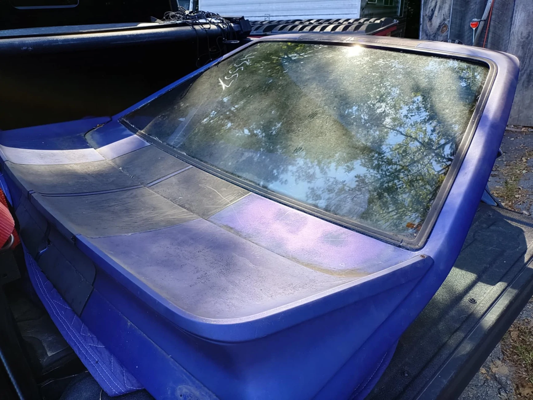

It had a 85 hatch on it that I modified to fit the 80 latch when we we dating back in 2002 when he first started the restoration
So today I brought her home a present a 87 hatch with no rust

wish me luck plan is to build the Capri I would have had in in High school (plus maybe some creature comforts AC and EFI) oh ya it will have a V8 subs and the full 90's fox body fun

Didn't even pump the old gas out? (I would still do that BTW).

tank was empty, it was drained years ago. the oil was just changed when parked. I took off the coil wire and I set up the old lone wolf push button to tun it over a couple times to build some oil pressure. put the coil wire on and hit it with ether and she started right up. I really just wanted to ensure the ignition system and such was intact. It will get some fresh gas and new fluids next weekend and wee will see if it can start and idle. I'm not so worried about any of the drive train as its planed to be all swapped out
Make sure the inside of the tank is clean and rust free before going too far.

I have a filter on the tool box, not my first rodeo
besides The tank is empty-ish... I have a bucket and a electric fuel pump gonna to do a fuel cycle and strain.
I use old gas to clean tanks (among other things ts almost impossible to get rid of)
-Disconnect fuel line prior to factory pump
-put 2 gallons old fuel in tank with a stable and dry gas mix
-Connect 12v el-cheap-o in line pump to fatory fuel line via rubber hose and clamps
- output hose from el-cheap-o pump to 5 gallon bucket
-tun on pump enjoy turpintine-esq smell
-strain bad fuel - fill repeat
-after the darkness truns more or less yellow stop and drain.
-fill with 3 gal ethanol free gas run pump to prim and clear lines of old gas
-reconnect lines with in line fuel filter after mechanical pump
-enjoy
