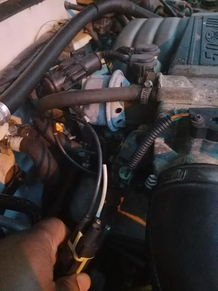

Hey guys.... what is this white vacuum line? What does it control? Do I need to replace it or can I plug it on both ends?
Looks like that runs to the egr valve .
Get a piece of hose the same dia as the plastic line and slide it over both ends to re connect it
I broke mine last summer while cleaning the engine bay so I slid a piece of shrink wrap over it as a temporary fix.
