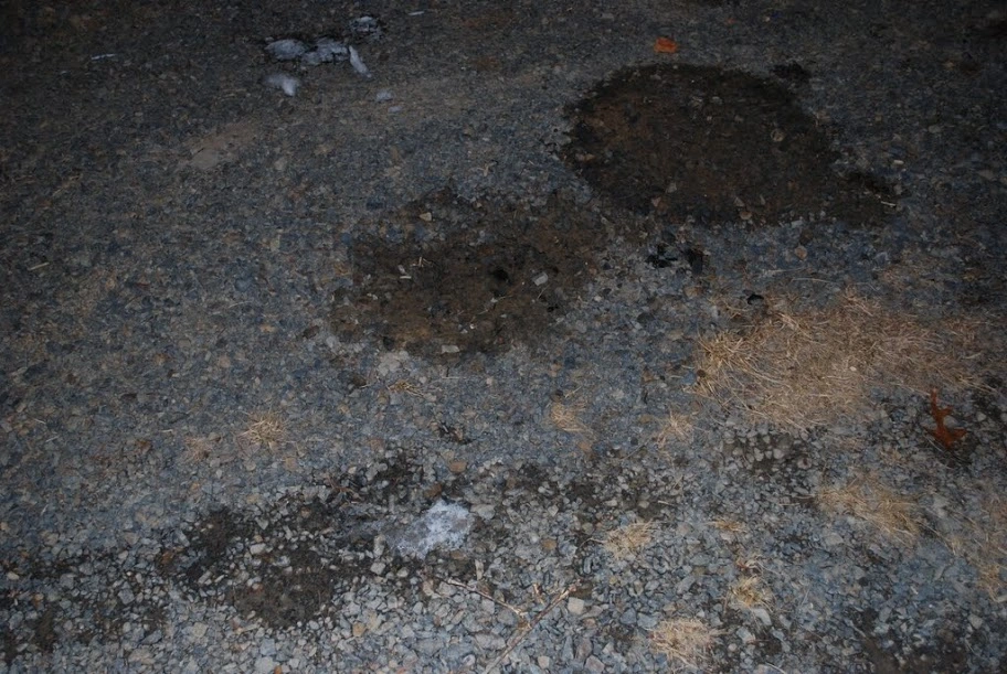

This is a picture of the oil spots it left in the driveway, rightmost spot would be the front of the car.

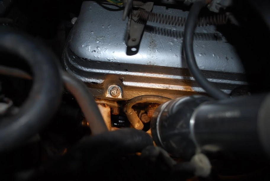

This is passenger side head near the rear. You can see the oil pooled at the bottom.

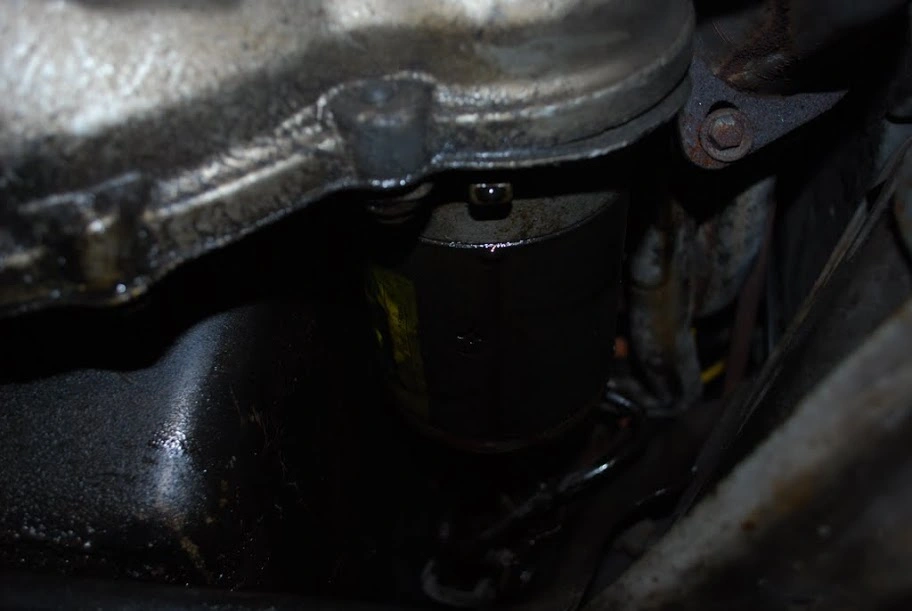

This is looking from the front of the car towards the back, passenger side.

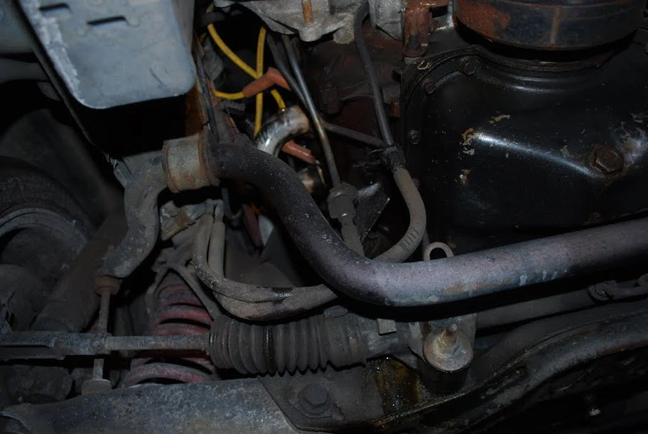

And this one is a picture from the rear of the engine looking forward on the passenger side.
It's hard to tell from the pics. Are you sure it's not just the valve cover gaskets ? I can't think any other source of oil leaks on that side of the engine. Check your oil for coolant and check your coolant for oil. Check for bubbles in your coolant while it's running (don't get burnt with coolant !). If you suspect a head gasket get a leak down test run on it.
Pretty good related thread here on oil leaks: http://www.stangnet.com/mustang-forums/831184-common-5-0-oil-leaks.html
My wife has done a bit of research and has advised me that she found some stuff that looked like my problem. Something to do with the PCV valve being clogged, and just having a bad valvecover gasket. My wife said it was coming from the valve covers before I took the pictures, and after I went back outside to look i'm inclined to agree.
Well I just got finished changing out the valve cover gasket. The bolts holding the valve cover on weren't tight at all, to the point where I could just about turn them by hand. I'm pretty certain that will take care of the leak.
