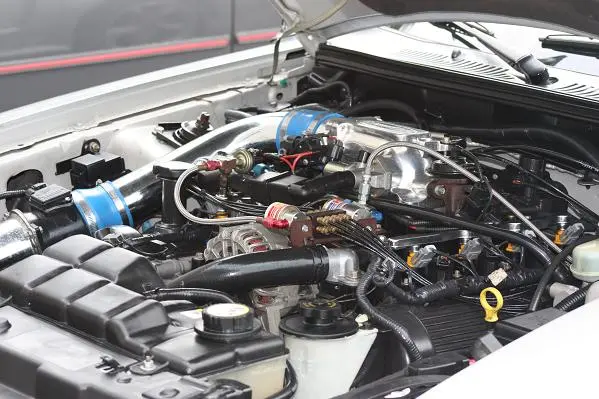

Pics of car
See if I remember how to post picks (if so I will show off a couple shots of my Mustang)!
Under Hood Shot
Dusk Shot
