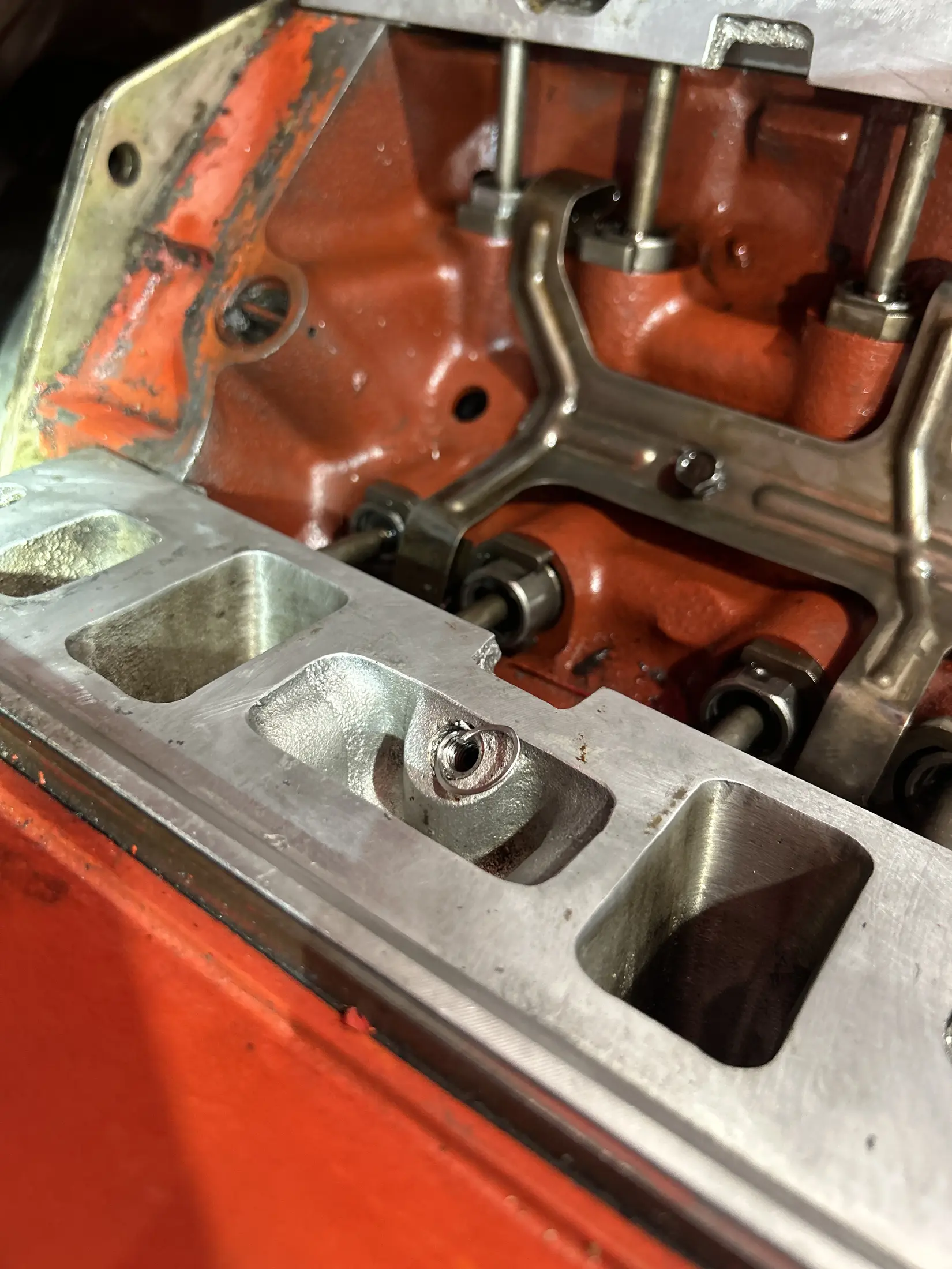

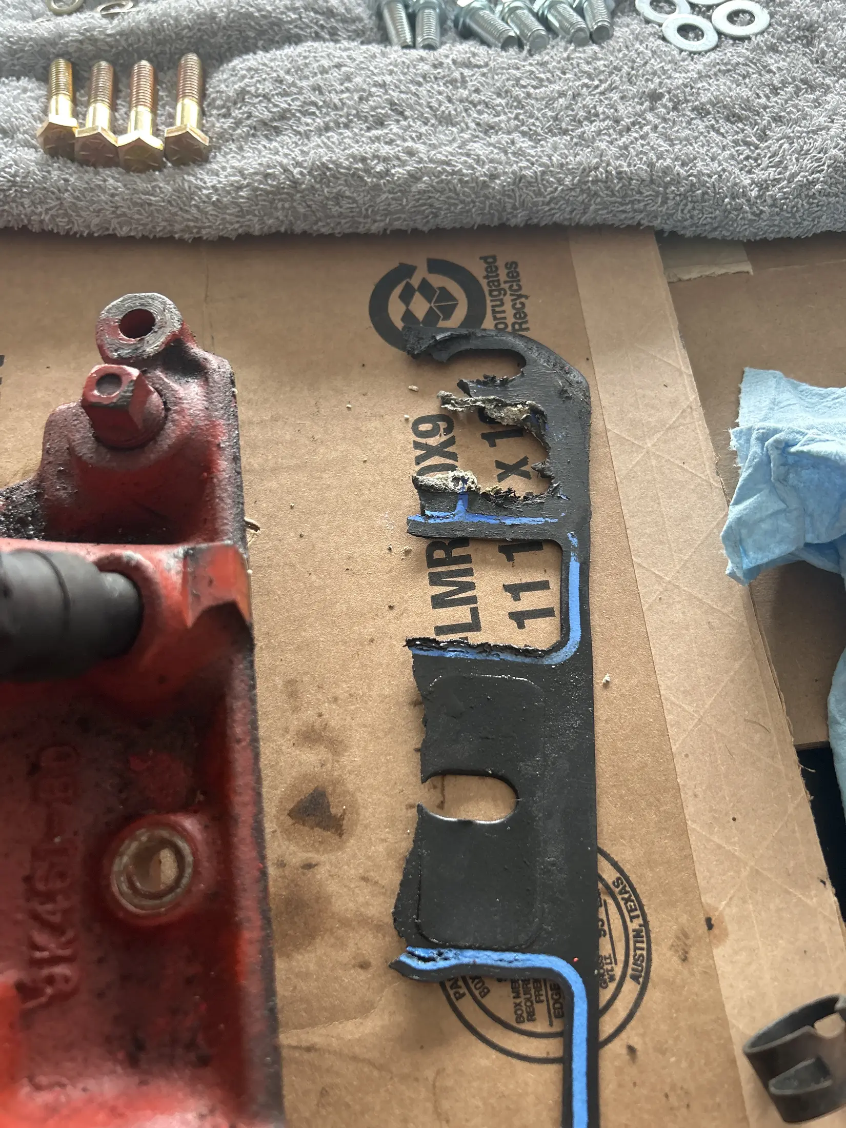

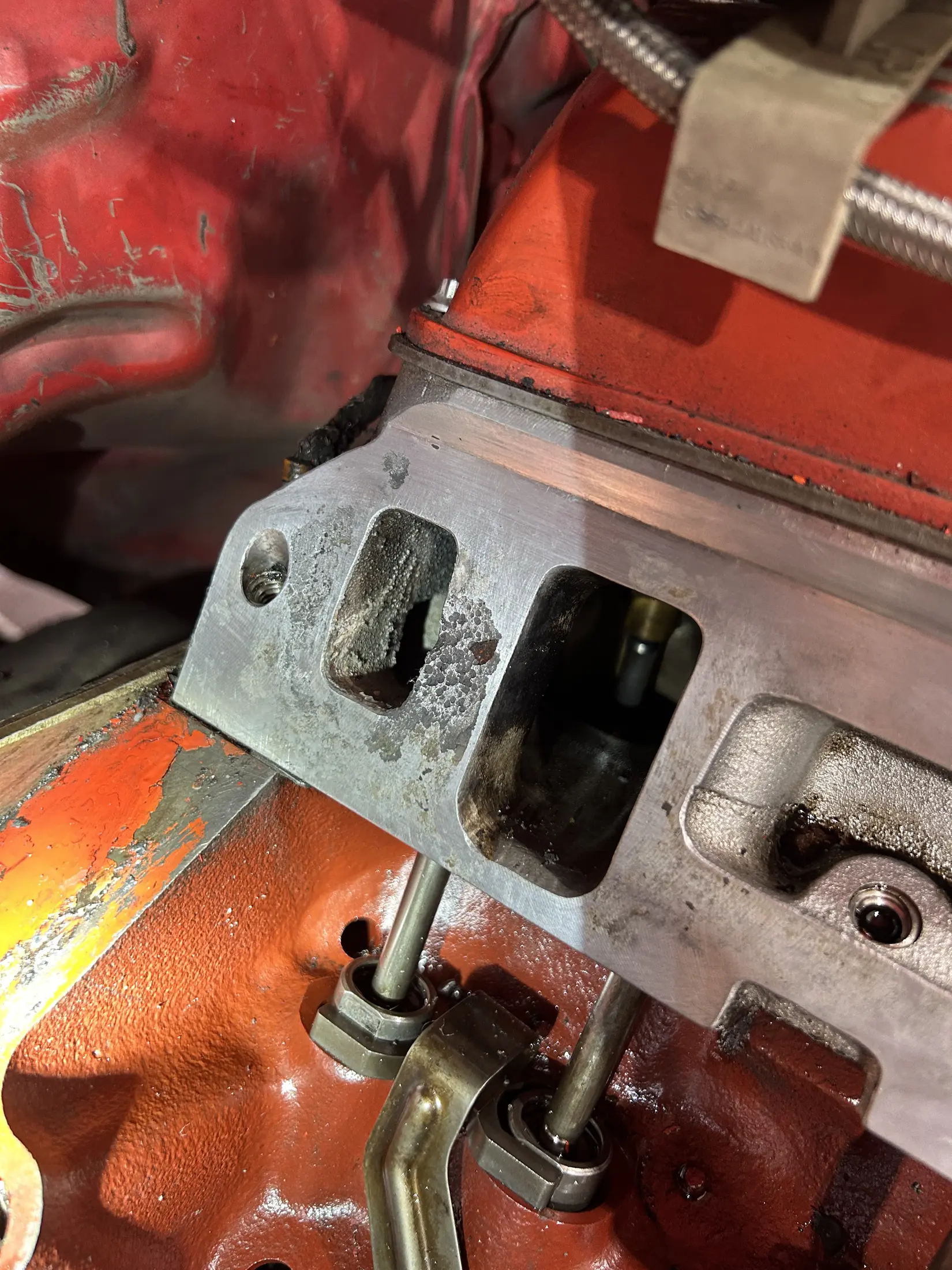

Pulled intake on the car yesterday to get it cleaned up and resealed and found #1 cooling jacket has minor pitting, #8 has pretty severe.
The intake bolt that goes through the coolant pipe didn't feel good when removing and upon inspection looks like a helicoil has come loose? Assuming since Edelbrock aluminum head and relatively low torqued to hold an intake probably wasn't helicoil from Edelbrock and is a failing repair?

Worst jacket back of driver side head, heads are ported worth saving or would newer heads flow better?
Falied helicoil repair?
Front pass side by #1 cooling jacket just minimal
You can remove the failed heli-coil and replace that yourself. YouTube that.
I would pull the heads with that many years and have them gone through and fixed properly. Do you know the pecs on the cam as the machine shop will need them to put the right spring gs on the heads.
As for replacing the heads it all depends on what is on there. I would have them put on a bench and flowed before I made any decisions.

F303 is what I read when car was in the magazine. Appreciate it. Leaning towards pulling both pressure check, rebuild and weld/mill. Still way cheaper than $4k all in to swap to new tags and ancillary required parts. Just have to fine competent machine shop. Not easy especially living in rural SE OH.
If this were my engine, in a car that was not being raced, but a daily driver that was used for normal driving, I would clean the cylinder head and intake gasket surface thoroughly, lay a bead of Permatex Ultra Grey around the coolant port, use a good Fel-Pro gasket and bolt it together and drive it. Then, years later, when I wanted to rebuild the whole engine or perform significant upgrades, then I would address the corrosion concern.
That area only sees coolant pressure and engine temperature. A good gasket and Ultra Grey silicone will last just fine.
