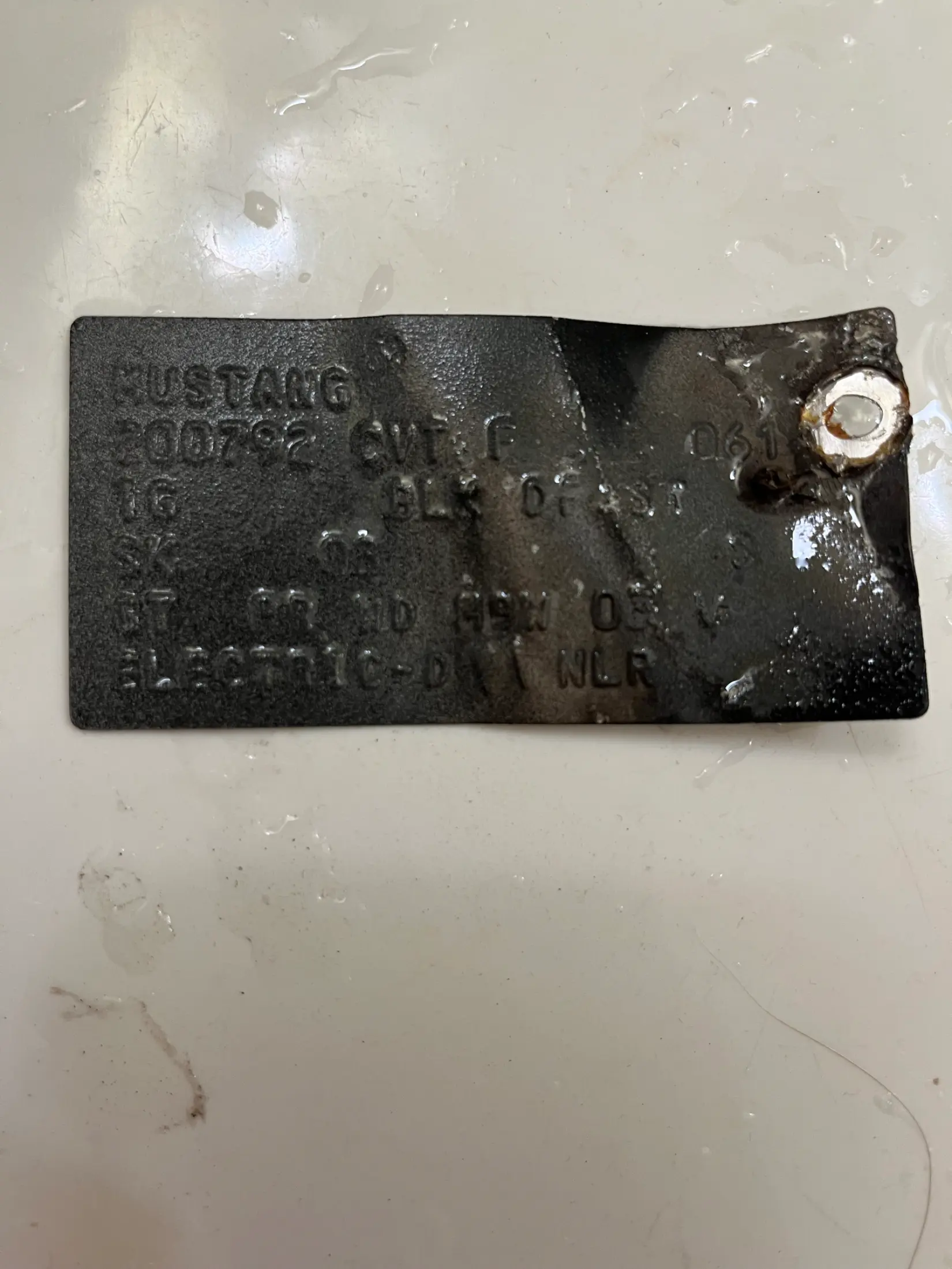

It’s been a while since I posted here so if I posted in the wrong section I apologize. Me and my buddy just got this 83. It still had its original buck tag on it. The car has somewhat of a strange history and we were wondering if someone could decode this tag for us. Would be interesting to know what the car came with from factory.

I can get a vin number from the title. However as the car sits it is white and has a red interior. I believe it to be a 1983 if that helps more. It is a convertible.
Are you looking for the color code, specifically?
It would be cool to know just to know. I was told from the guy I bought it from that the 302 and 5 speed weren’t original to it and that it was some ex drag car or something. He was very sick and unfortunately passed shortly after I bought it. I think he may have been a little confused on the history of the car. After looking it over it looked like a very untouched original car. I thought the manual steering was odd. I was glad to find the buck tag just to see if it was in fact an original GT or not.

Looking at the buck tag I would put forward that the color is 1G, not 16. That would make the original color Silver Metallic. Check the less visible areas of the car that wouldn't normally get recoated with a typical paint job and you may find some Silver.
