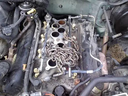

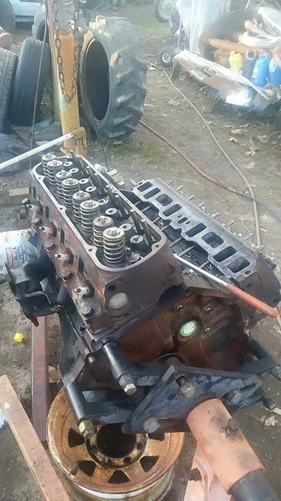

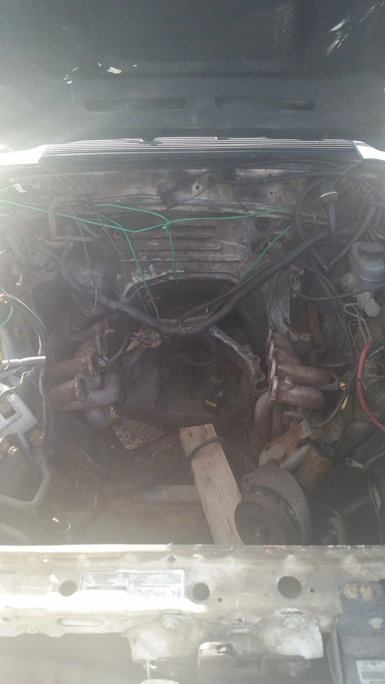

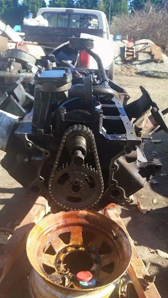

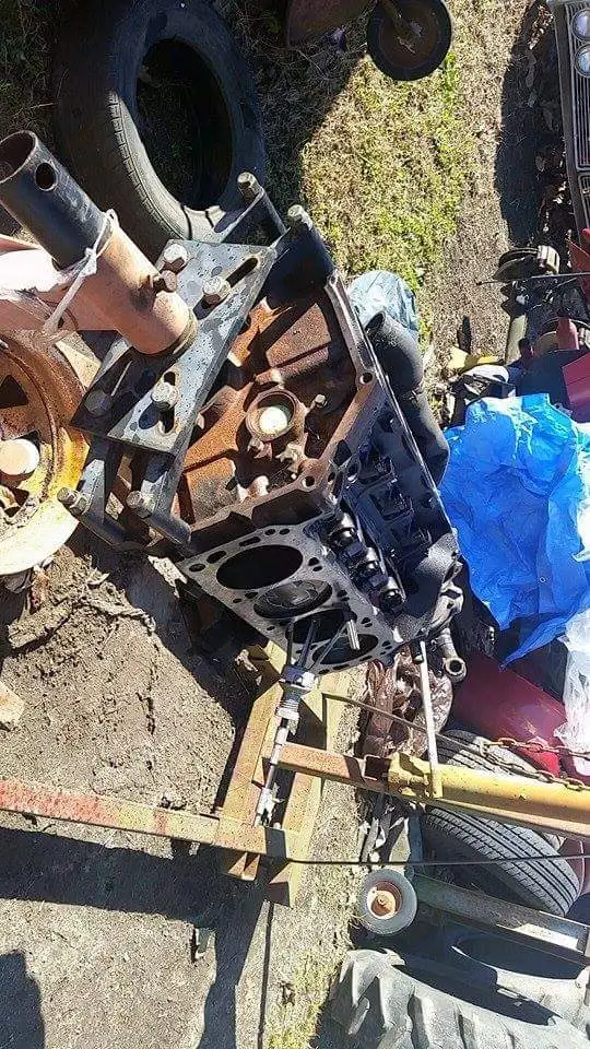

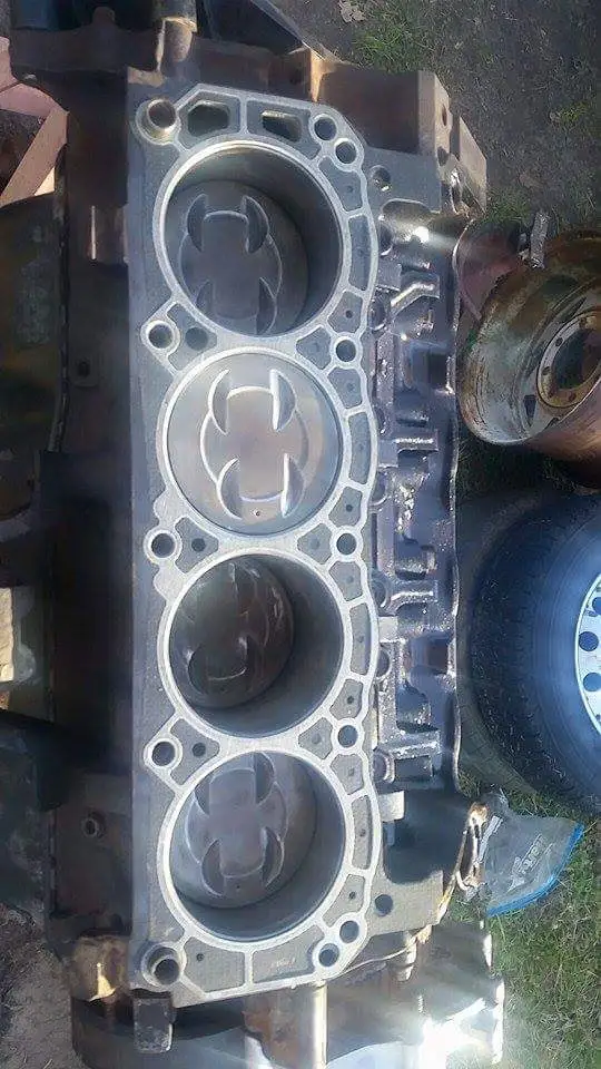

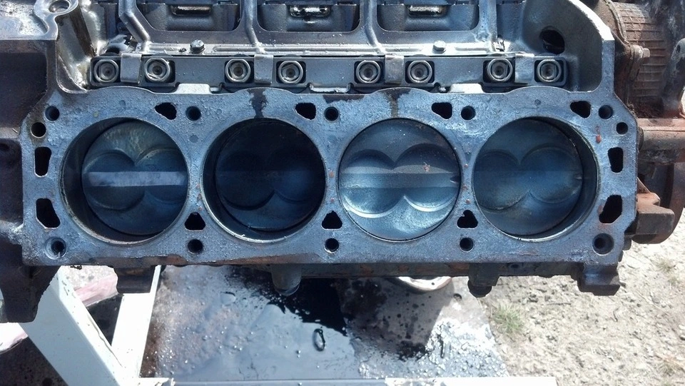

After getting the engine out, everything looked good. However the block had a lot of rust and sediment in the water passage ways and really needed to be honed and hot tanked.

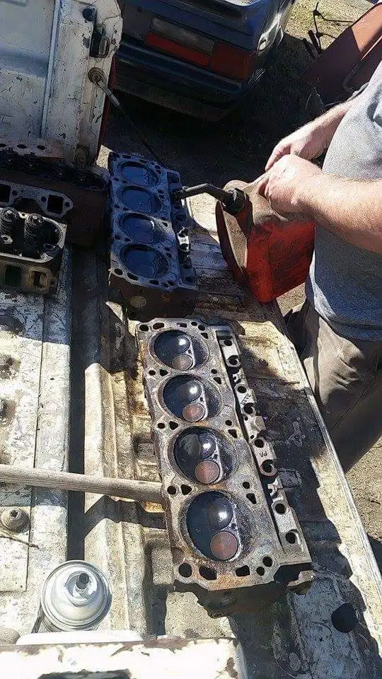

I did another form of a leak down check on my heads using the gasoline and water and soap method. As it turns out my valve springs were weak and not hold the valve completely close.
Well my break for school was ending and I decided to nickel and dime parts and store the engine until I could afford everything. Some random pics of the engine with some lithium grease sprayed to prevent corrosion.
http://s1087.photobucket.com/user/Black1987coupe/media/IMG_20140315_143540_956_zps5oxipk64.jpg.html
http://s1087.photobucket.com/user/Black1987coupe/media/IMG_20140315_143621_561_zpsr8cg69e8.jpg.html
http://s1087.photobucket.com/user/Black1987coupe/media/IMG_20140315_143710_051_zpsprliwtco.jpg.html

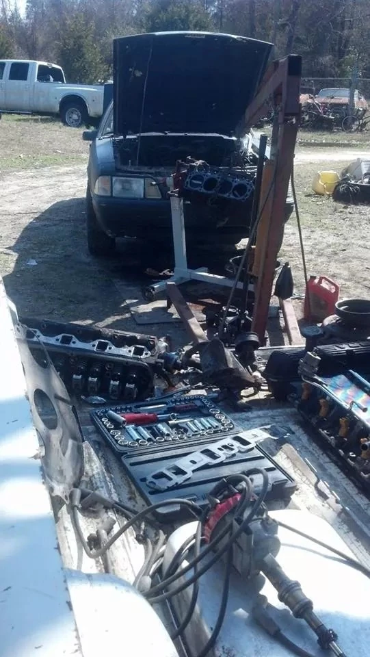

Now that I was back in school for my final 2 semesters. The car just sat for almost a year and half like this:
Until this past Christmas, after moving and started a job 2 hours away from my folks house were the car sits.

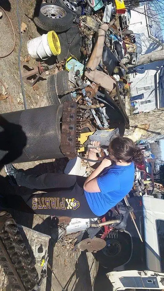

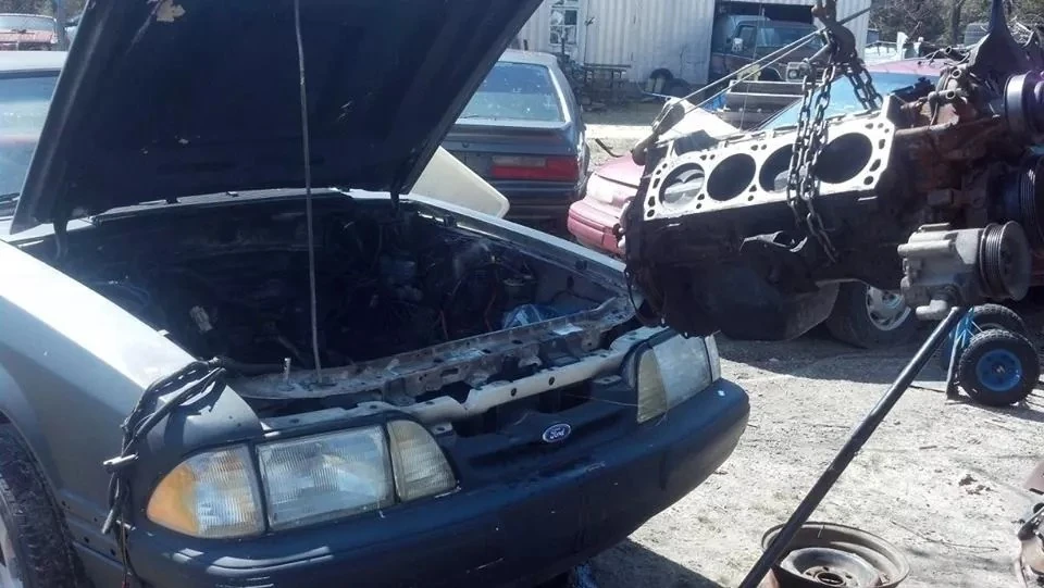

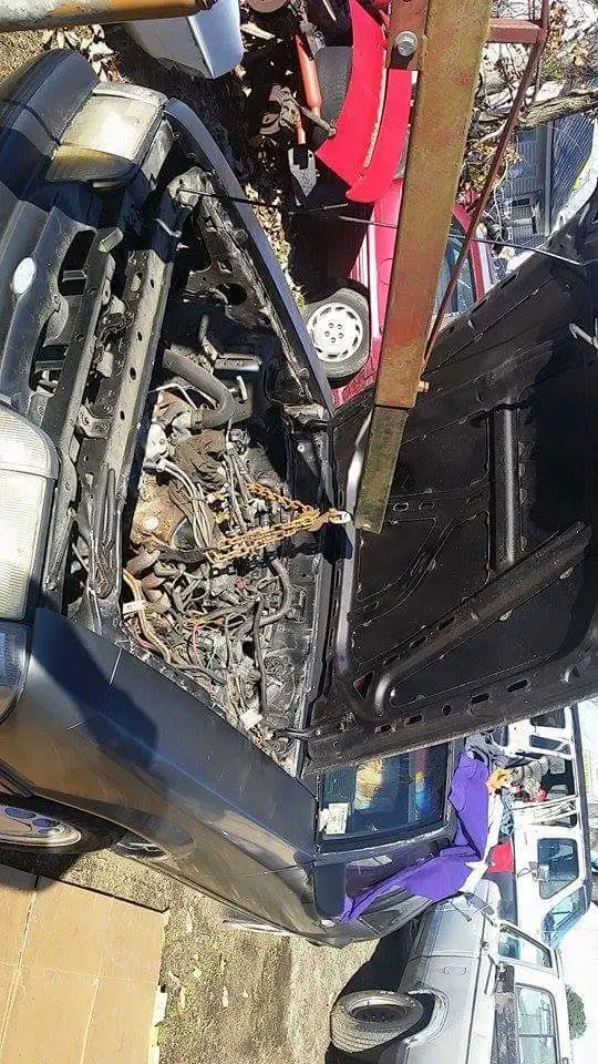

My wife after eating Christmas lunch, asked my father were I kept my old engines and pointed to a gray 89 I had bought and was like that has a long block you can try ( I had bought that engine and never tested it for a 95 shell I had laying around).
She proceeded to go over start unbolting the engine to swap into my 93

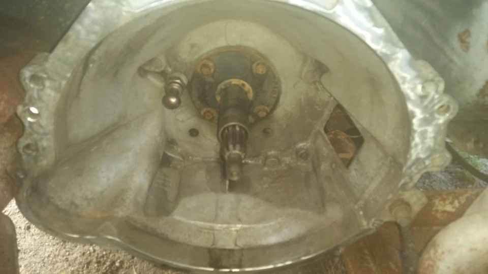

FYI if storing an engine in a car, either put the intake on or use duct tape. The painters tape and clear tape leak and you get water in the firing cylinders.

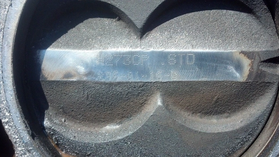

Moving on this motor was supposed to be out of a 95 GT with a small cam (convinced this is a factor of why my MPH was so low). Anyways, we pull the motor that day and make a weekend out of it.

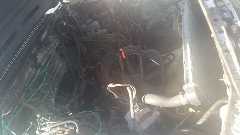

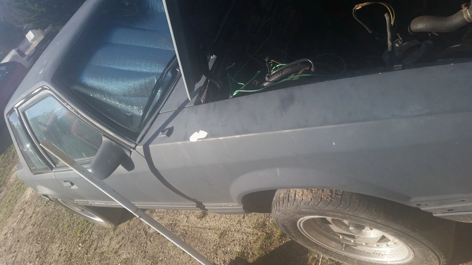

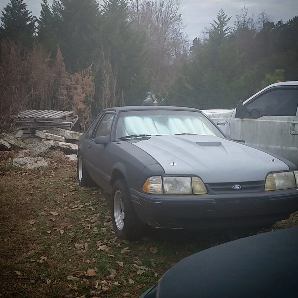

To say the car looks rough is an understatement, but there is zero bondo/filler and is super straight with good floors.
http://s1087.photobucket.com/user/Black1987coupe/media/20150316_092139_zpsb5qqem9e.jpg.html
http://s1087.photobucket.com/user/Black1987coupe/media/20150316_092832_zpsquv4k4w1.jpg.html
http://s1087.photobucket.com/user/Black1987coupe/media/20150316_095342_zpsxcwjxiy1.jpg.html
http://s1087.photobucket.com/user/Black1987coupe/media/20150316_095352_zps6qqdr1x8.jpg.html
http://s1087.photobucket.com/user/Black1987coupe/media/20150316_095355_zpsvasl9ia3.jpg.html

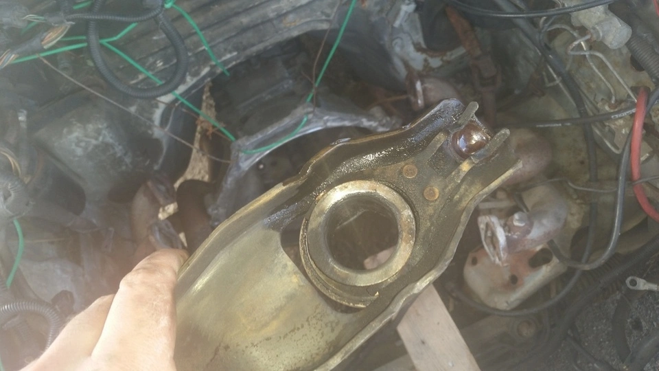

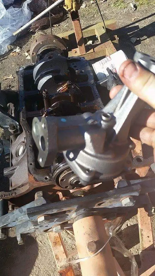

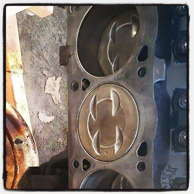

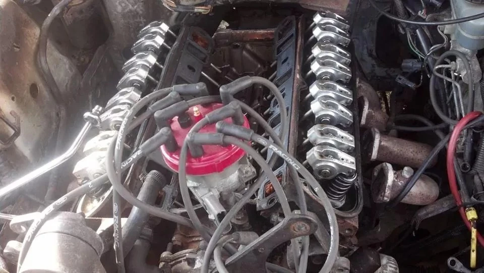

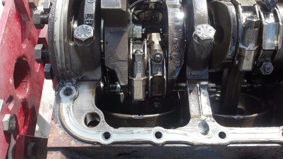

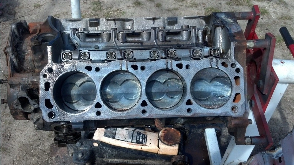

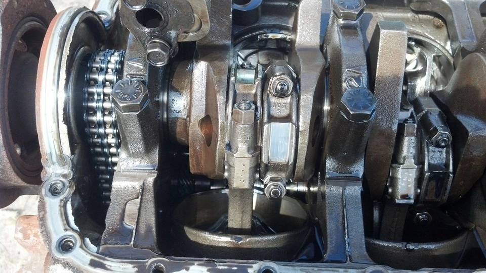

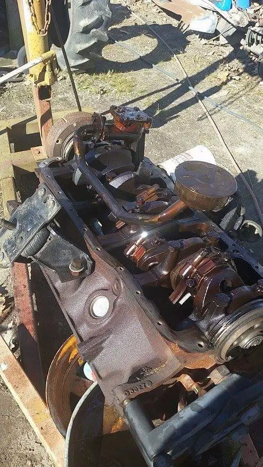

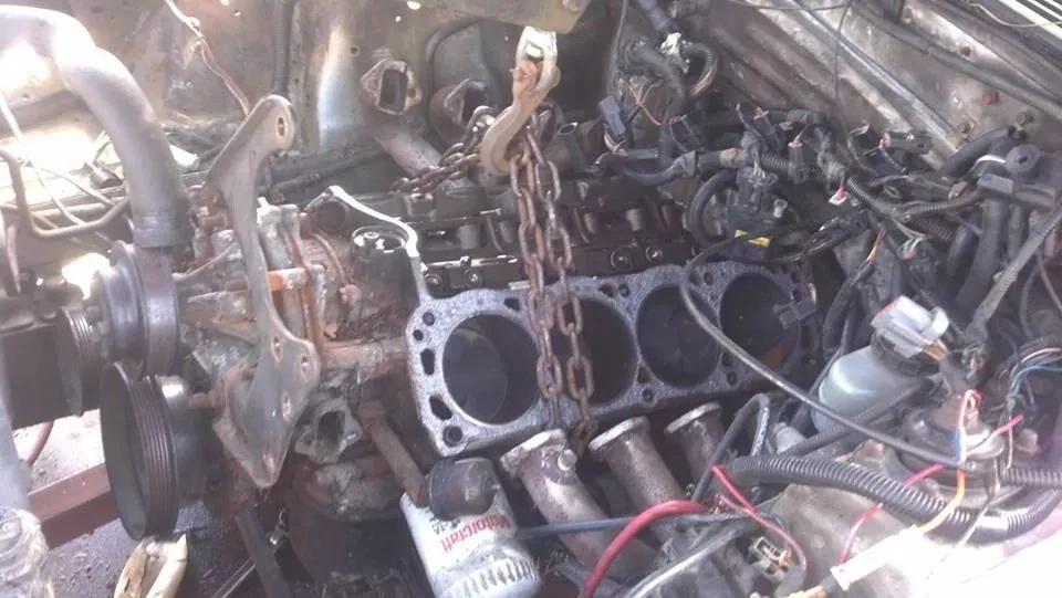

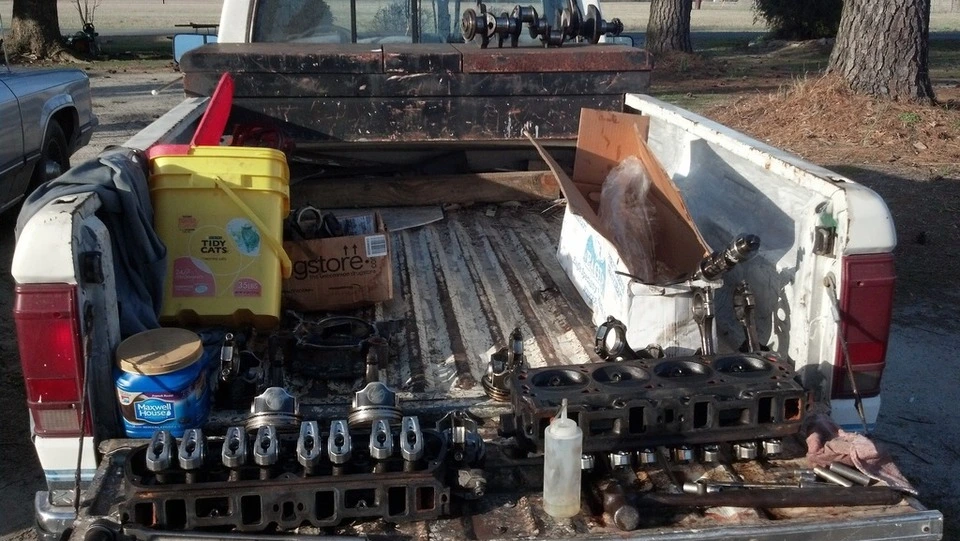

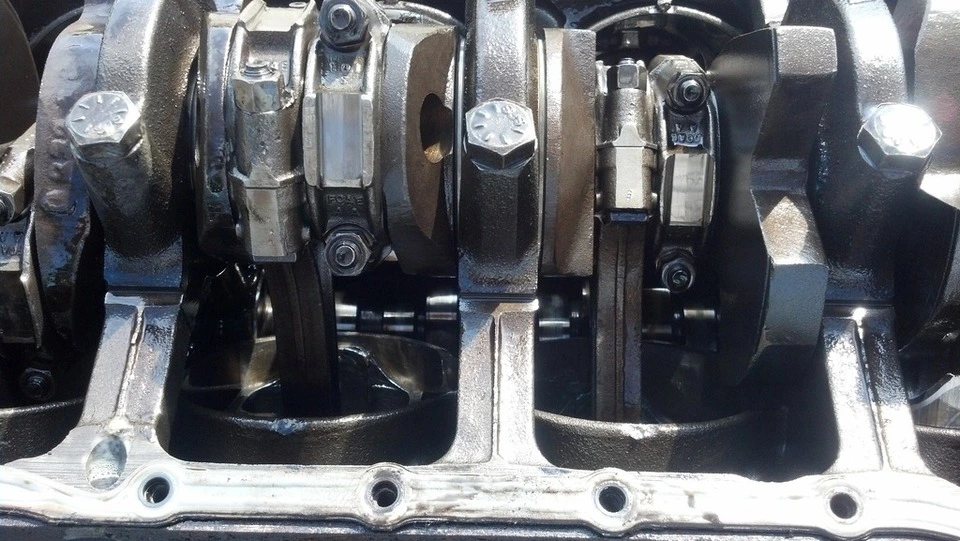

After cleaning out the crap, I bought a gasket rebuild kit for KAS and some odd and ends from Advance Auto.
Come to find out the heads and lower intake had elongated holes and broken bolts in them. So I robbed a set of E7s from a wrecked drag car in the junkyard. Leaked tested them, they appeared to have some work done to them and new springs. Then slapped on my old cobra intake with some explorer injectors.
Leak down check
Had to hone one of the cylinder for extra assurance.
No time like the present to learn
Bearings and oil pump
RL=http://s1087.photobucket.com/user/Black1987coupe/media/IMG_37443575992190_zpsiao0r0ar.jpeg.html]
New timing chain

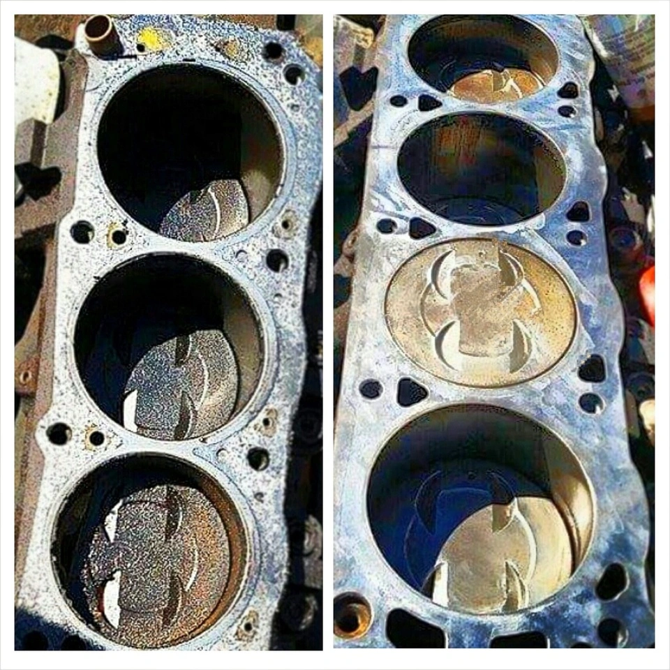

Cleaning old gaskets and carbon off the heads
Before and after cleaning
Head Gaskets
Heads are on
Little pre-oil and gaskets

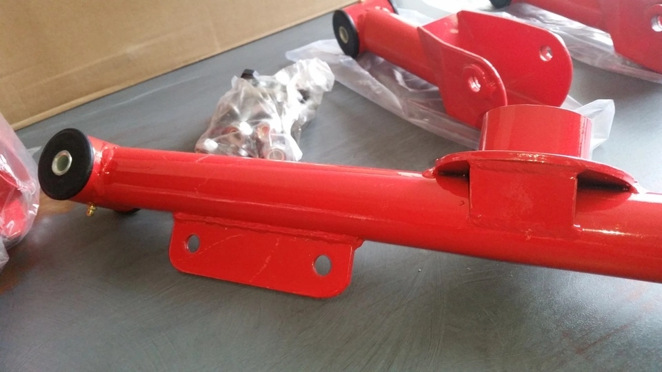

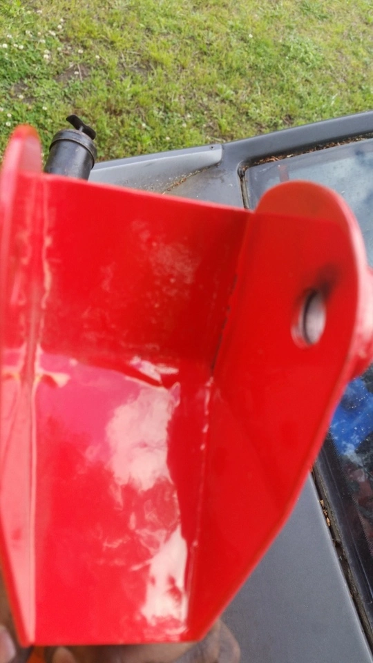

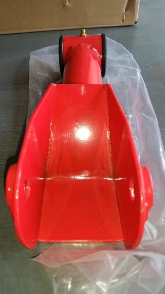

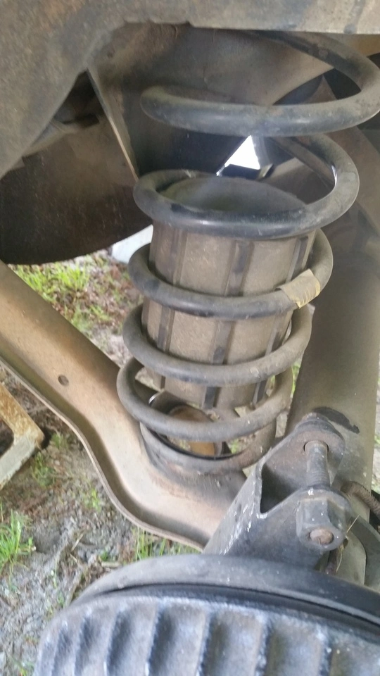

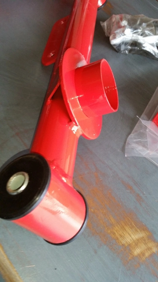

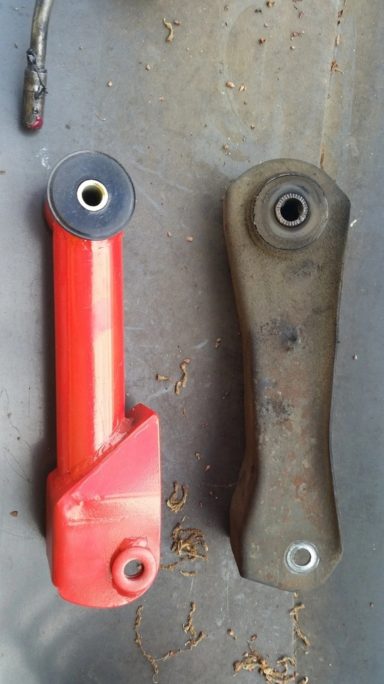

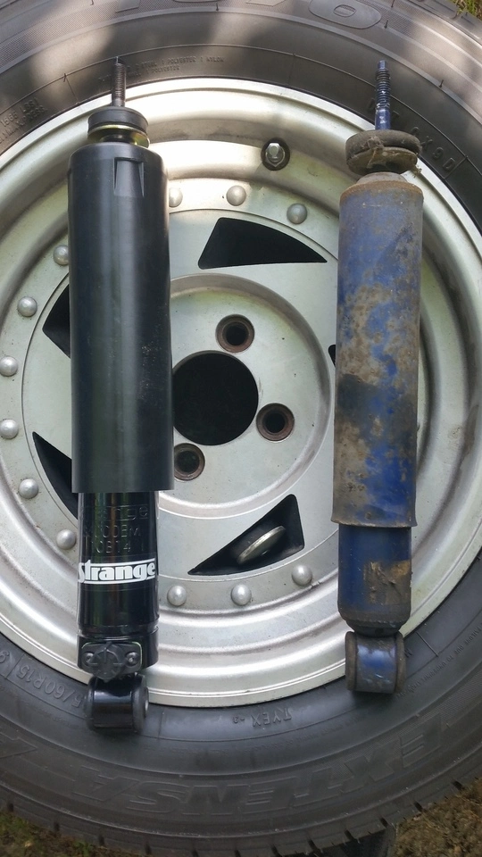

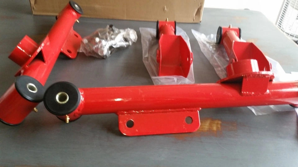

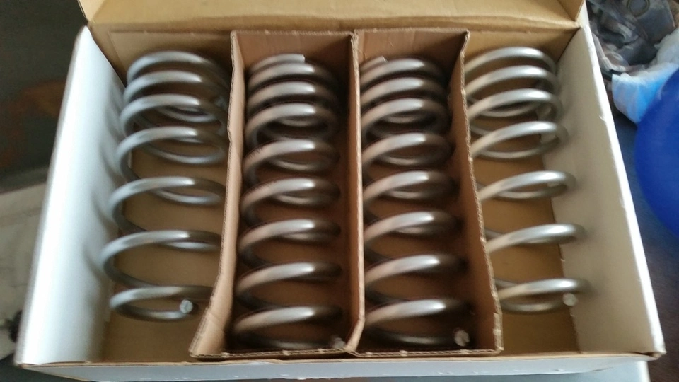

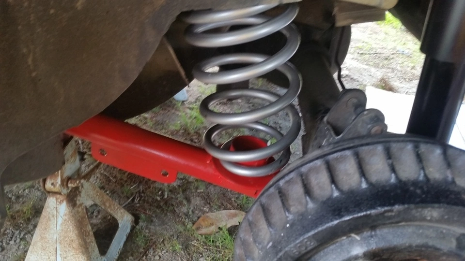

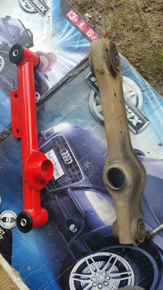

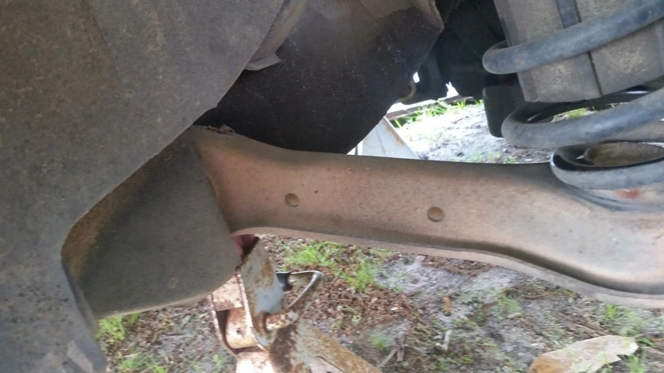

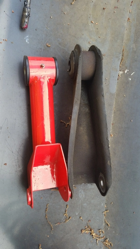

I had some time to update. I purchased the tubular uppers and lowers control arms from our vendor CJPony, Strange 10 way adjustable shocks, and some SVE progressive lowering springs. I took some side by side shots for everyone. However, there has been a revised design of the arms at LMR, but I wanted the grease zerks.
All together
Lowers control arms
Upper control arms

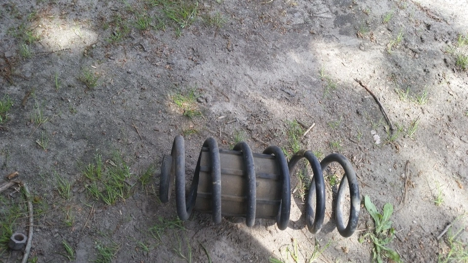

Old set up (4 cylinder springs one coil cut)
Shock side by side
New set up

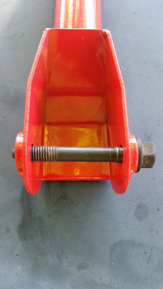

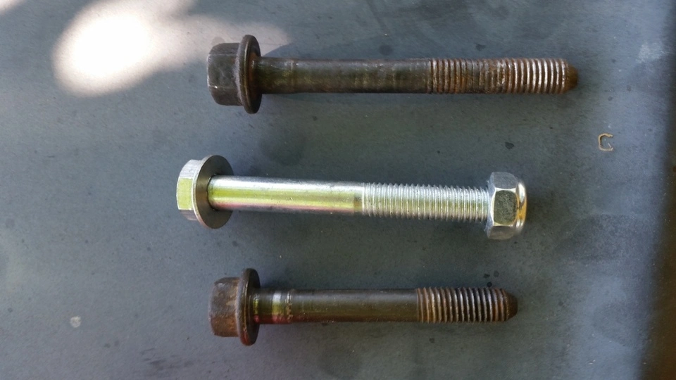

A few key notes if you are doing the control arms. The hardware provided, I wasn’t a fan of. It is stamped grade 8, however it is very soft.
If your old hardware is in good shape, then reuse it. The stock upper control bolts you cannot reuse due to the length (see below). But, you can use a set of stock lower control bolts instead from another build I had or junkyard.
Overall I think the car hooked a lot better on the old suspension IMO, but I still playing with shock rates. I think the progressive springs are way more forgiving on the street.

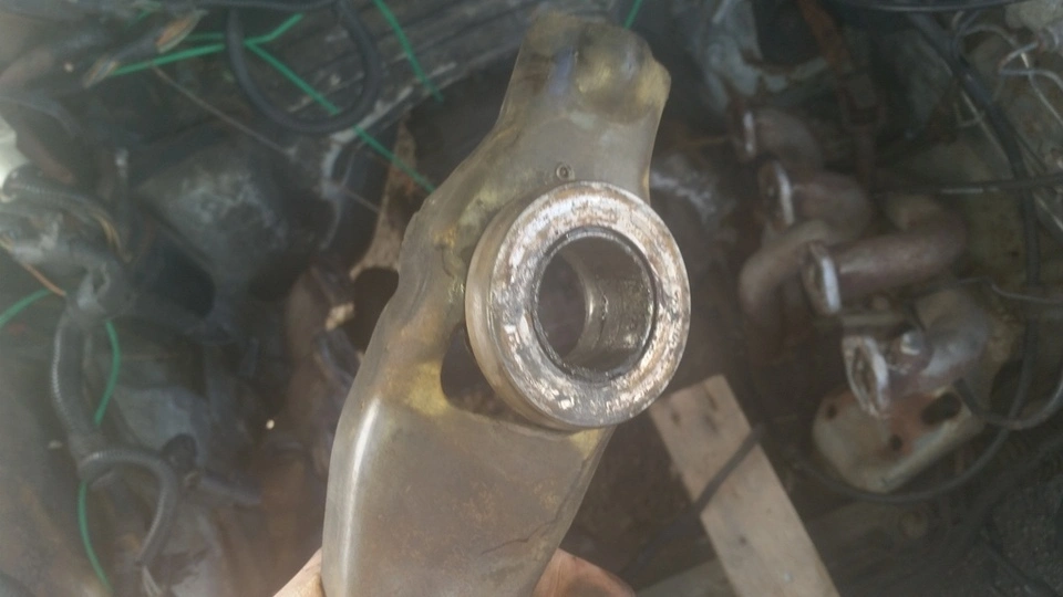

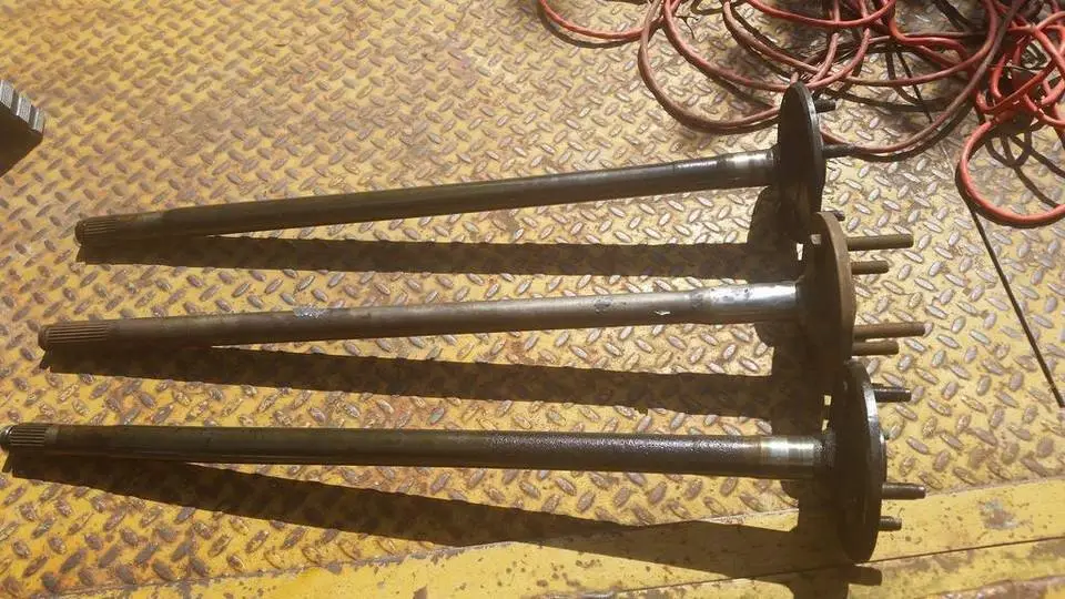

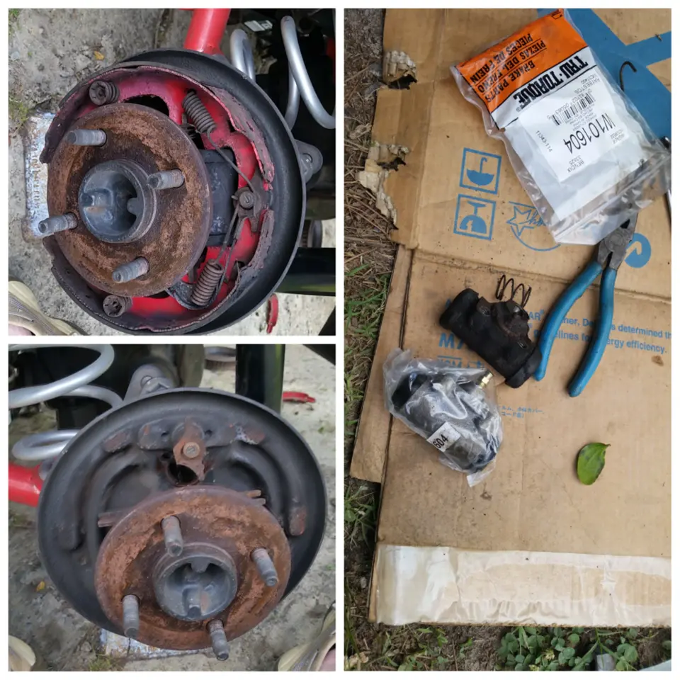

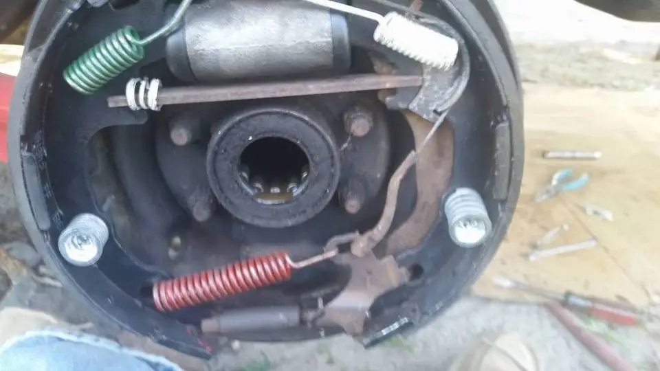

Up next wasn’t much of an upgrade, but needed to be done, was the rear brakes.
http://s1087.photobucket.com/user/Black1987coupe/media/20150412_133918_zpsujnxlmgd.jpg.html

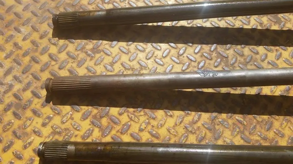

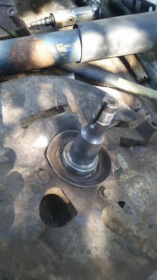

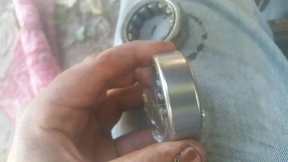

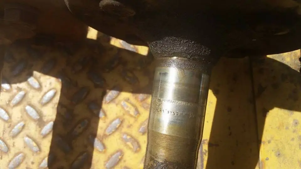

Just trying to make it drivable for now. I also thought I just had a bad bearing in the rear. However I later learned upon pulling the axles, they were pitted and needed to be replaced.
The new to me axles have really long stud and are beefier. They’ll work for now.
The middle one is one of the new ones.
New bearings
So, don’t be dumb like me and wiggle the axles while putting the C clips in…..or the spider gears will pop out. Lesson learned smh

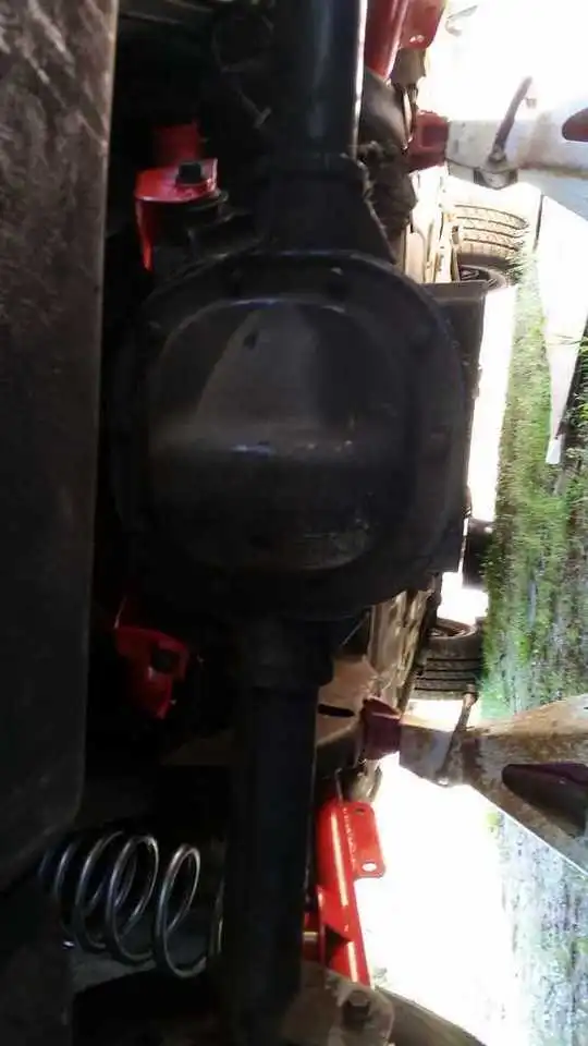

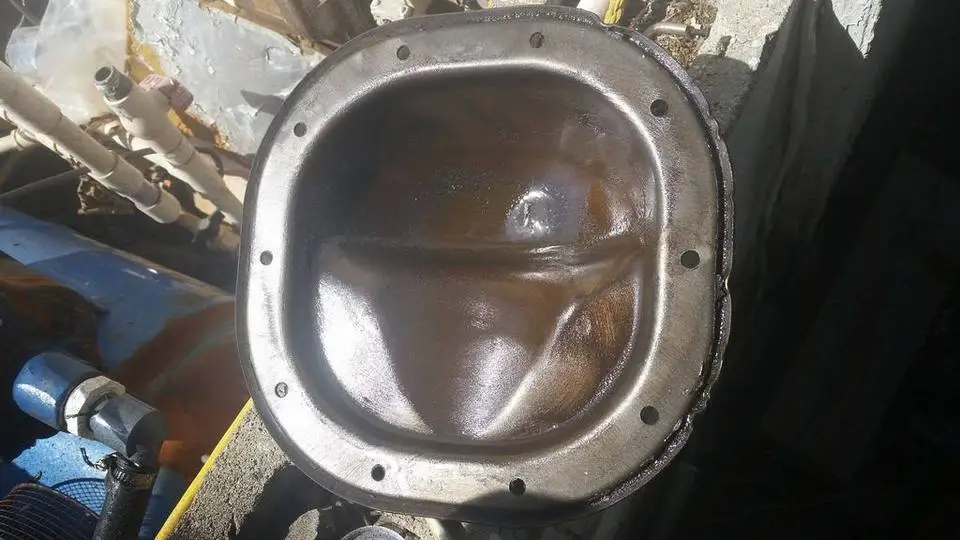

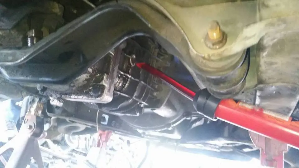

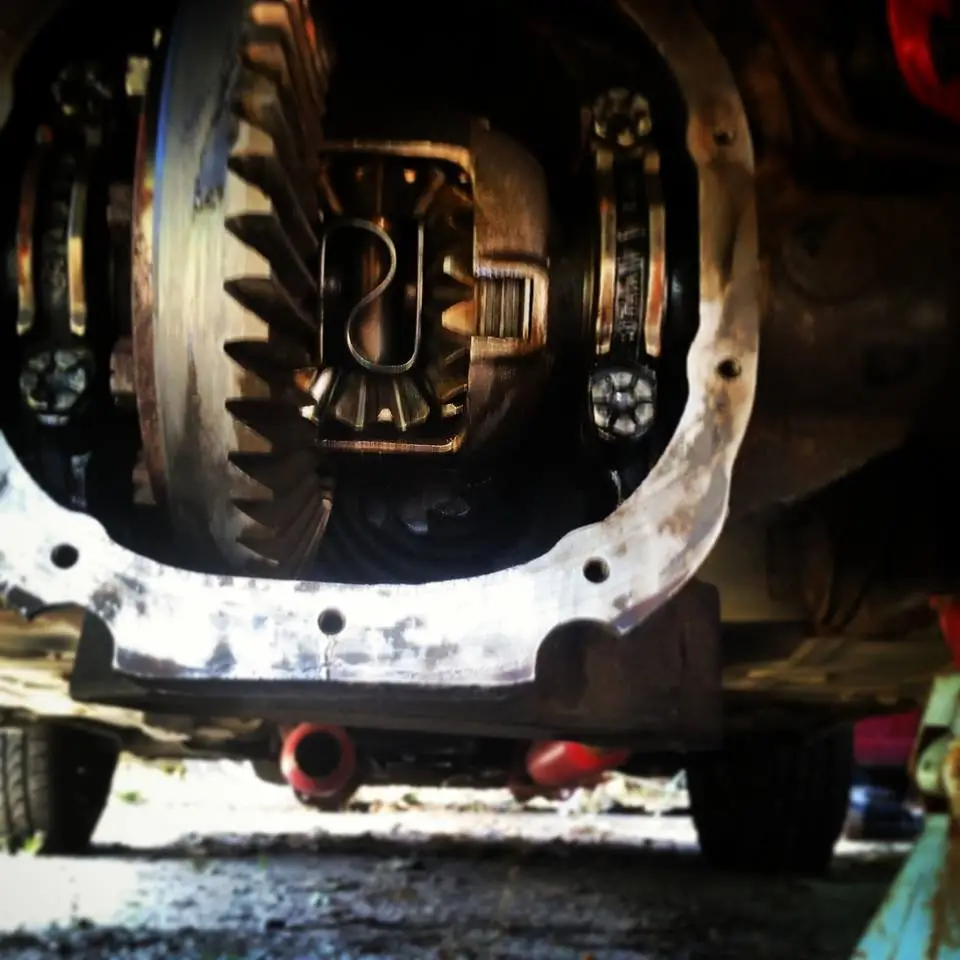

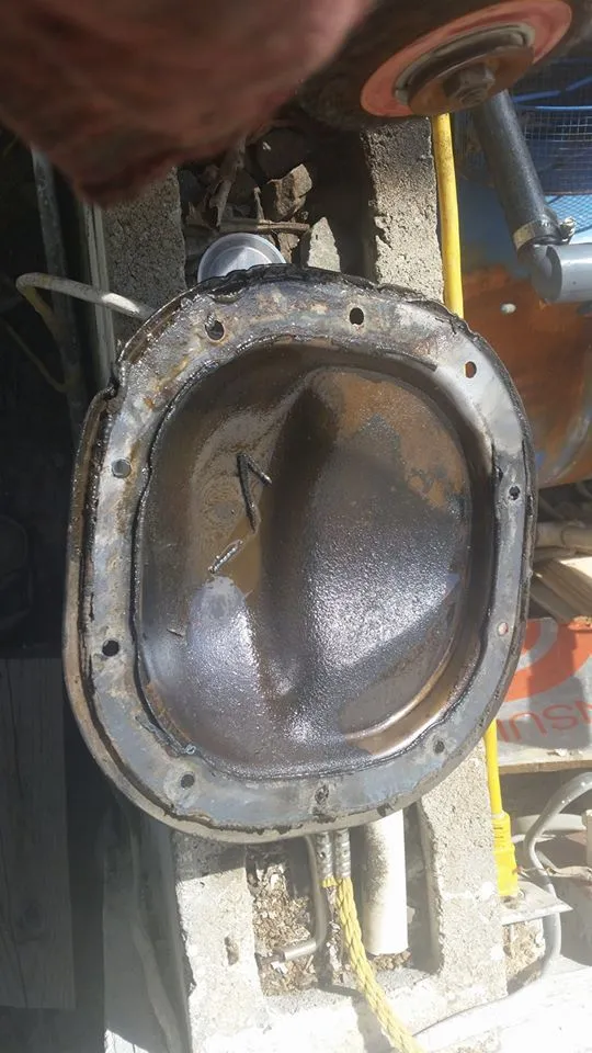

Oh and my diff cover had a crap ton of RTV too. Before and after below. After putting the cover back on, I filled with LMR kit of royal purple.
I hope to get to the front end soon, but being 1.45 hour away sucks and eats into my budget. Well anyone remember this, I found it in my storage

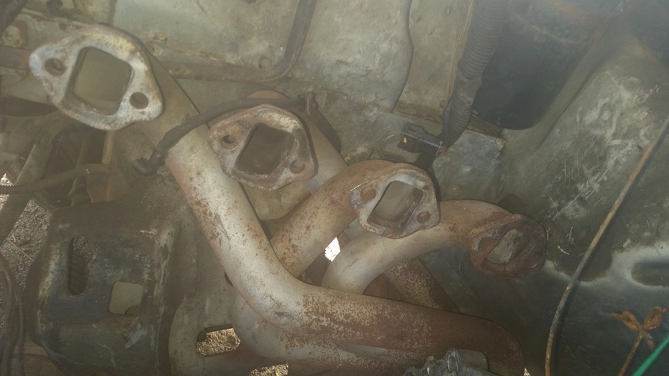

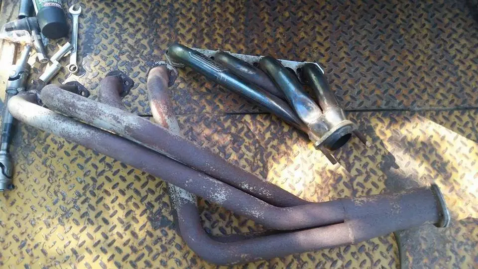

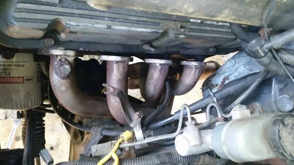

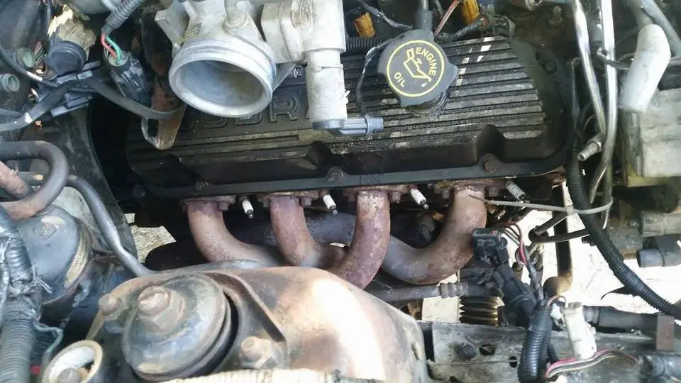

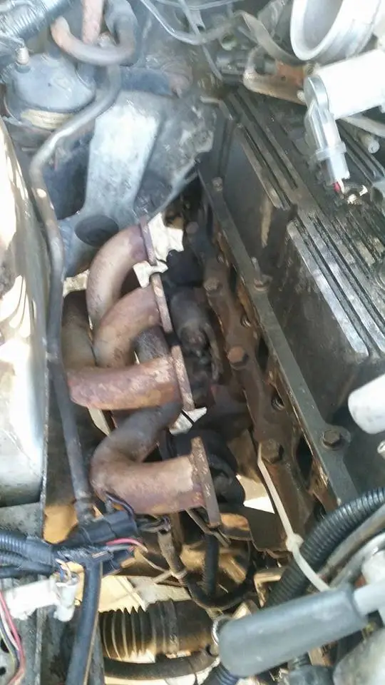

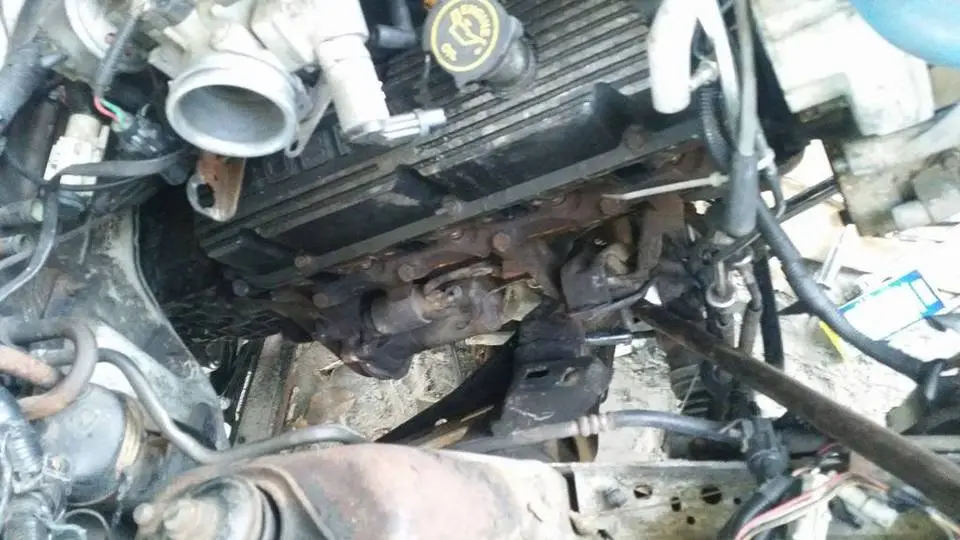

Well when it rains it pours haha. I had a leaking header on number cylinder 4, I thought. However, after a long day of finally deciding to go back for shorties for the time being. I also wanted to finally install a remanufactured cobra rack on this car, which meant changing to the hybrid maximum motorsport steering shaft.
Driver side header
Leaking SOB

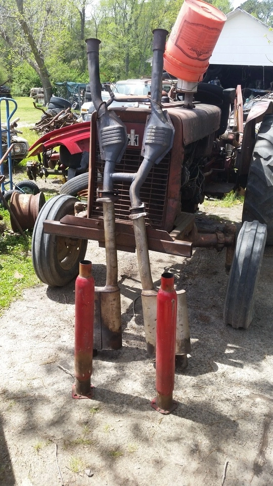

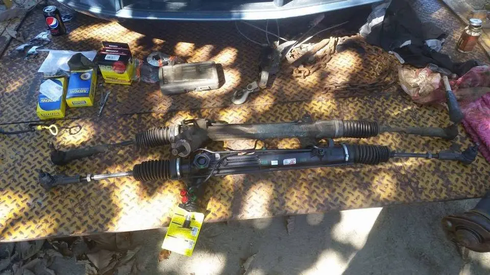

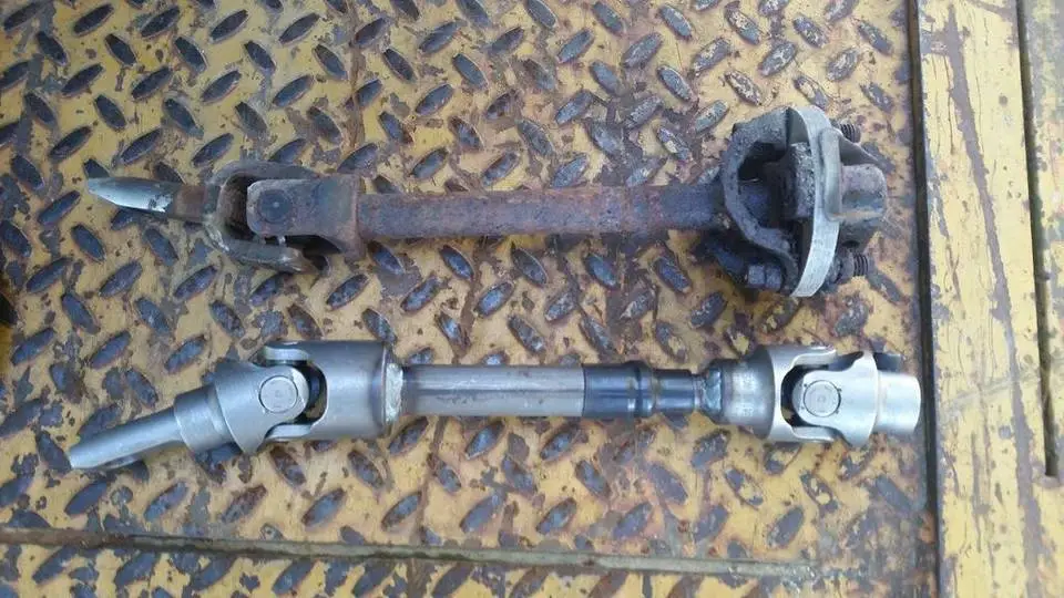

So, I forgot how much of a PITA it was to put/pull these headers. Basically you have to pull the motor almost completely out. That’s when dumb crap happens like the yoke popping out and spilling that cheap old Dextron III on the ground smh. Moving on old rack out, old steering shaft, and comparisons.

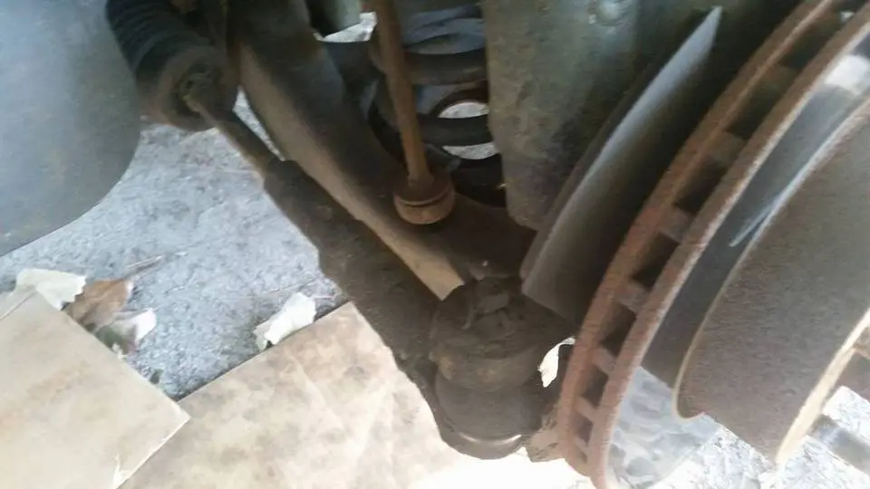

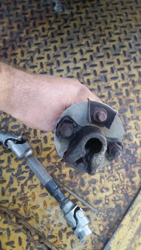

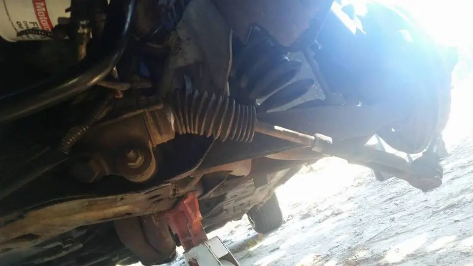

I will say an fyi, if you have a 4 cylinder conversion with the original rack and want to do the 03/04 swap. Then you will have to swap to the 5.0 spindles and hubs or cut the ends. I went ahead and swapped to the GT stuff that was off an old project.
Stock vs Expensive
Headers side by side and an old h pipe off a member here.

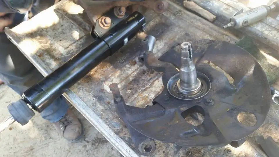

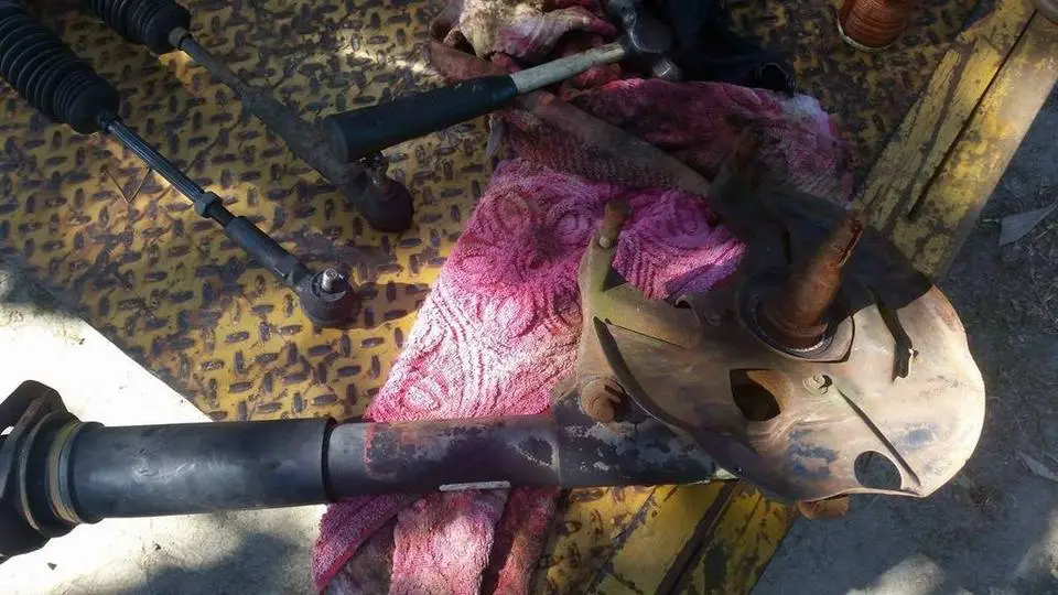

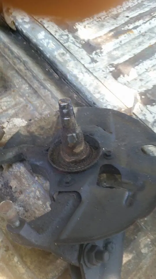

Struts and spindles
20 dollar mistake
Home sweet home

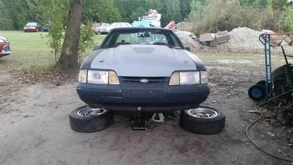

I finished putting the hubs on and its sitting on the ground rolling. Waiting on new rubber brake hoses and pads. Then I have some PowerStop rotors for it. I still have to bolt the catback on. But some progress.

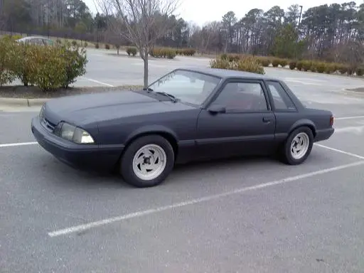

I dig the progress. Love the stance in that tail shot.
Reactions: Black1987
Black1987
my wife Bedazzled my input shaft
Jan 9, 2011
1,064
595
174
NC
Apr 12, 2016
  • Apr 12, 2016
It is actually lower with LMR progressive rears than with the stock 4 cylinder springs with 1 coil cut . It nibbled my tire when I flexed accidentally on my path to the house.

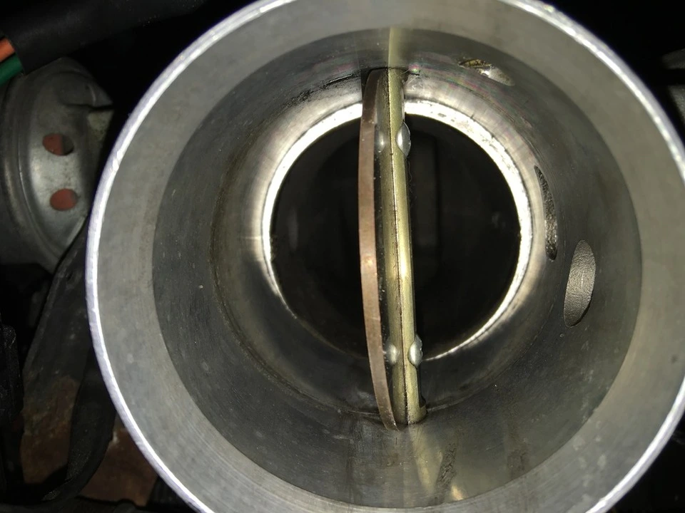

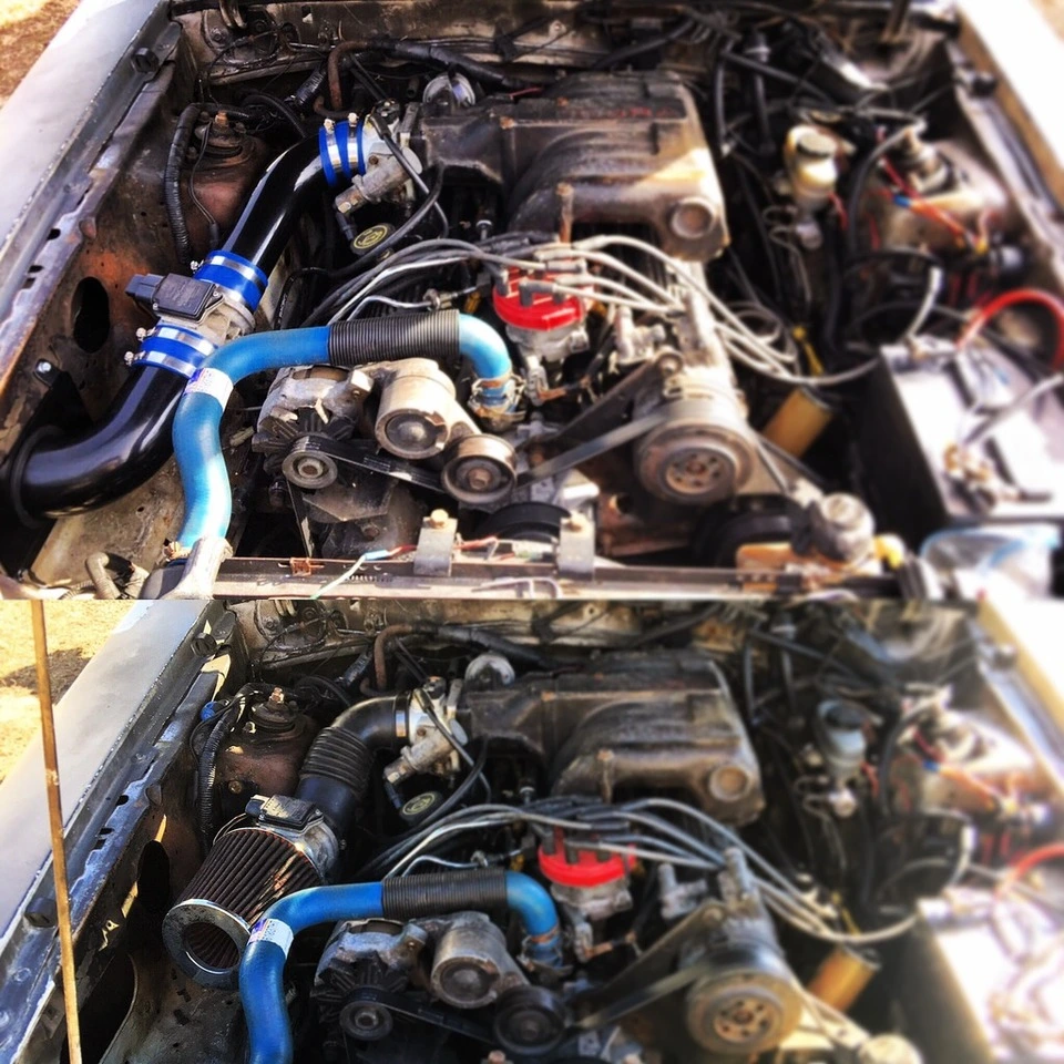

Also, been driving around lately and had a 75mm throttle body laying around from another car I sold.
So I thought bolt it and just see what needs to be clearanced. Not quite what I expected.
It was nice the other day, so I had a CAI laying around

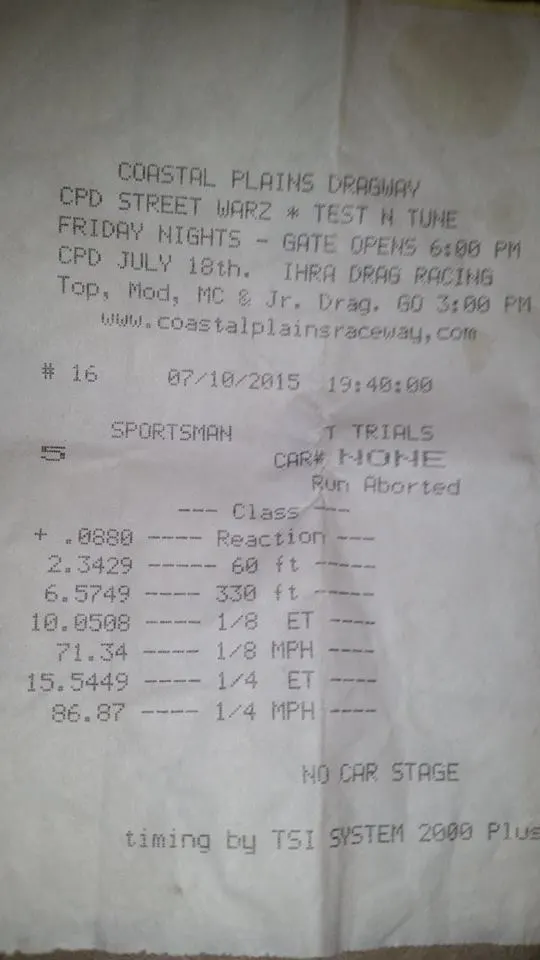

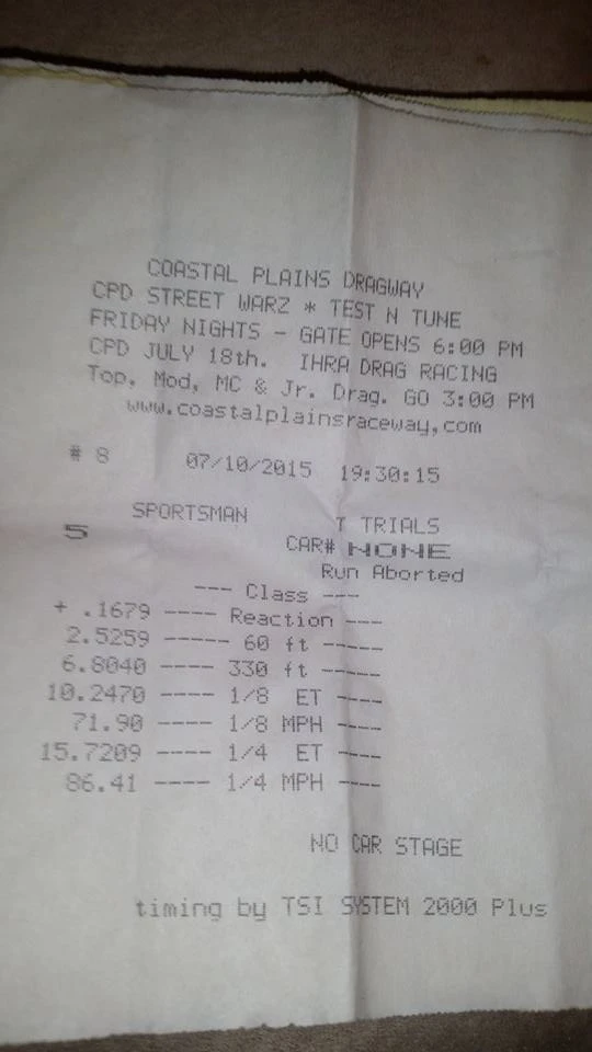

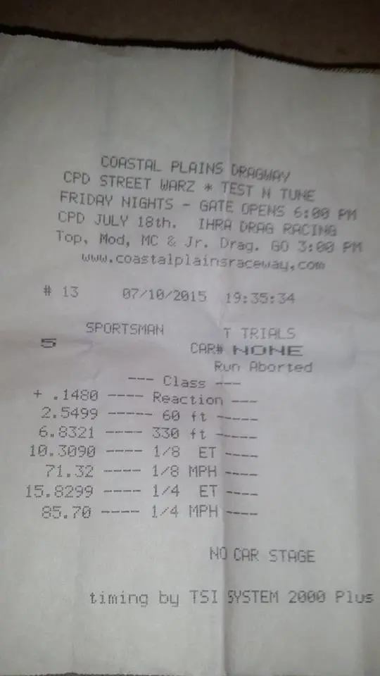

Track was humid as crap that day around 100 degrees, it cooled off a little that night. I had an exhaust leak on cylinder 2 and the plug in the back of head (Check engine light for that and EGR). Tires were Toyo Extenza on 35-30-25-20 psi....the guy kept spraying the burnout box even though I asked him not too (no way to drive around it either). 5 speed, full weight plus the trunk fully loaded with tools and jack and etc.
Best part of the day was no ac, wife riding for 1 hour drive to the track filled up before we left, and got 25 mpg round trip including the 4 passes on 87 octane.
Reactions: Davedacarpainter
Black1987
Jan 9, 2011
1,064
595
174
NC
Apr 13, 2016
#15
  • Apr 13, 2016
  • #15
@84Ttop & @madmike1157 are the mphs low for a relatively stock 5.0 with 3.73s (elevation basically sea level 15 ft)

ah didn't know if you knew relatively. Well I have checked the sticky and google seems to have a wide variability

you said the trunk was full of tools, jack etc., so, without knowing the cars actual weight, and the actual air conditions (you can be at sea level and have 3500' DA) it's hard to say if that is a time representative of a 5.0 with intake/exhaust mods or not. My intitail thoughts are that it's slow but, you are throwing used parts together with unknown mileage/wear/condition...
Mine ran 100mph when it was stock with offroad H pipe and 3.73's, but it was essentially a new car at the time with an empty trunk and it had certainly never been on fire... and we typically had DA of 300' or better.
