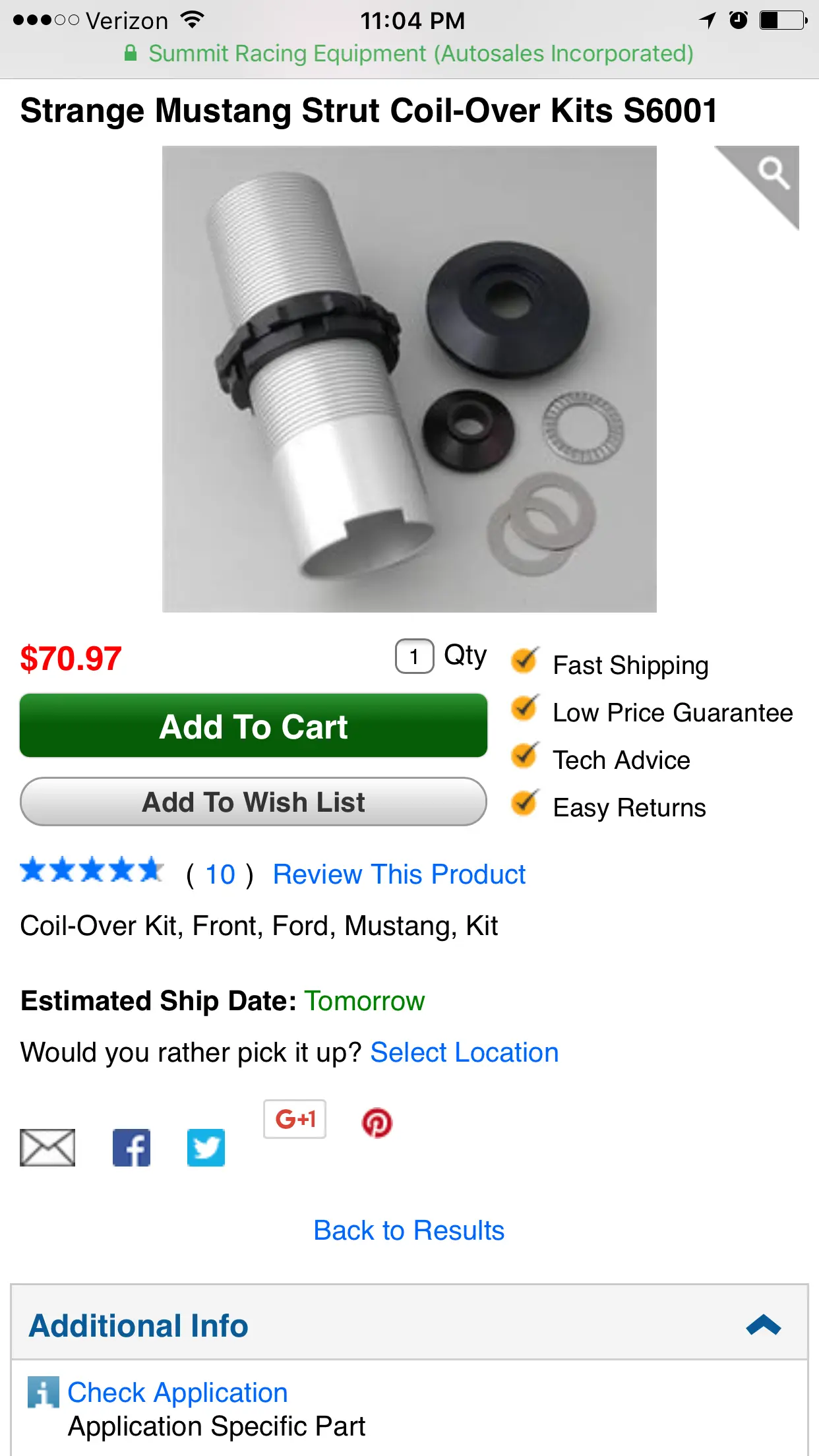

Or interesting:thinking::thinking:
It also appears Team Z fits Stranges :oops:
