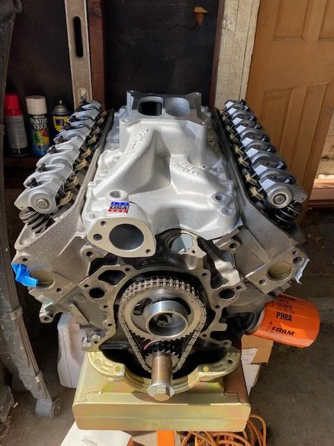

Hi everyone,
I'm starting to piece together my motor for my 65 fastback and was hoping for some input. I purchased a 1978 long block from a friend who abandoned the build some time ago. I'll start by saying thank you in advance for everyone's feedback. The car is not a daily driver and I don't plan to drive it more than a couple of times a month, so, street manners are not an issue. I would like to build the most aggressive engine that is possible without having to trailer it around town, let's say a goal of 300 - 350hp. I've outlined the details of the build as it stands today below.
I'm concerned the cam is not aggressive enough for my HP goal and the heads even with porting could hold me back, thoughts?
Thank you,
1978 Ford 302 Long Block (D8VE-6015-A3A) which I believe have larger main caps
D8OE heads with the following work
STAGE I PORTING
16 IRON VALVE GUIDES
8 11575 MANLEY PERF 1.550" FORD SB EXHAUST VALVE
8 11578 MANLEY PERF 1.850" FORD SB INTAKE VALVE
VALVE JOB-COMPETITION RADIUS-V8-2 VALVE-INLINE VALVE
Crane Valve Springs: 363308-1 (96803-16)
Crane Needle Bearing Rocker Arms 1.6 Ratio
Crane Cam 363932: 4600 RPM, 210int/218exh, .456in/.472exh
VALVE PART NUMBERS: INT 11578 EXH 11575
VALVE HEAD DIAMETERS: INT 1.850" EXH 1.550"
VALVE STEM DIAMETERS: INT 11/32" EXH 11/32"
VALVE SEAT WIDTHS: INT .040" EXH .060"
VALVE SEAT ANGLES: INT 45 DEG EXH 45 DEG
SPRING INFO: PRESS @ INST HGHT = 100 LBS @ 1.760"
VALVE LIFT = - .472" EXHAUST, .456 INTAKE
PRESS @ OPEN HGHT = 240 LBS @ 1.288"
COIL BIND = - 1.130"
MARGIN = .158"
Edelbrock RPM Performer Intake Manifold
Carburetor TBD
Ignition TBD
Short Block
Speed Pro Pistons .030 over
Crower Sportsman Forged Rods
Transmission
Top Loader Wide Ratio
Rear End
9" with Trac Lock and 3.25 Gears
Considering the following upgrade: Lunati 10350703 (.522/.538 lift), 6,200 RPM, 227/233 duration
Considering the following upgrade: Replacing D8OE heads with AFR Enforcer 185cc heads

Back when i had a 302, flat top forged pistons, E7 heads(fox body) that were mildy ported, and I had a performer intake, holly 650 4V carb, comp cam 270H cam 224/224 with .500 lift on both sides, long tubes through dual exhaust, C4 transmission, 8" rear 2.73 read gear...... I wanna say it was putting down like 220 hp to the wheels? ill have to see if i can find my old dyno sheet from back then. heck it couldve been 240....
my current 351 setup is basically a good 302 setup, and im putting 305 to the wheels right now. I have alot of room to grow for the 351. my next setup will put me at about 400 to the wheels.
If you have in your budget to get more power, id prolly go with an RPM Air gap intake and RPM heads. the top end kit from Edelbrock claims 367 HP from their 302 setup, even comes with a matching cam.
the nice thing is you have a manual transmission so it robs less HP than my AOD.
your alternate heads and cam are good candidates but youll need to step up you intake. All the parts have to "work together" to get the most out of them. but if your going to put together all thats stuff that way, id just go with a dyno tested power package that will get you where you already want to be.

Your build with the worked-over 70s heads is really close the the engine in my car.
It put down 267hp on the dyno with a 670cfm Holley Street Avenger that was perpetually out of tune (I hated that thing). The "butt dyno" saw a huge improvement with an Edelbrock Thunder AVS 650cfm (never made it to the dyno with it the first time, maybe this time around) and converting the car to MSD EFI saw no significant change compared to the Edelbrock, and was actually a pain in the ass compared to said Edelbrock (which is why, after five years of the car being EFI, it'll be taking a technological leap backward to a carburetor).
If I was building a 302 now, there's no way I'd do ported OE heads again, in spite of just how good my D5AE castings have been for me. There are so many aluminum heads out there now, with so many improvements, and the prices are so cheap (especially when you can find a used pair), that I'd start there. Even the cheap Chinese-cast "Floo-tek" heads on Ebay have been dyno tested by the mags and proven to make power, so when the bar to entry for aluminum heads is now that low, there's virtually no reason not to.
@LILCBRA has aluminum heads and one of the Chinese intakes and was all of 2rwhp below my engine and made more torque with a nicer torque curve. I'd bet a paycheck his car would kick mine's ass on the dyno with some tuning, that Holley on mine wasn't that far off (for once) on dyno day while his was way out and made damned close to my horsepower number. https://stangnet.com/mustang-forums/threads/so-i-did-a-thing-today.913231/
