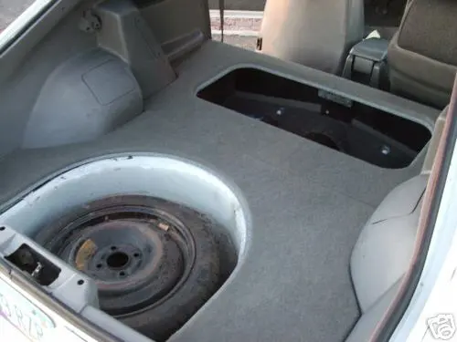

not sure whos car this is in this pic but i liked it. too bad its in a fox. maybe it would give you some ideas.

Here's a quick pic of mine. You can see the black outward hinges to lower the seat back down (you wont do this if you have subs in the seat back) and then the lower partition is for underseat storage. There's a piano hinge under the carpet.

I think that looks good man. I believe I will mix-match when I do mine. I like the storage part in JT's ... and the subs part of Aarons. So I will do both. The only thing is ..... I want to make it so that the subs can be disconnected & removed very quick & easy (for track use). I'll figure something out.
