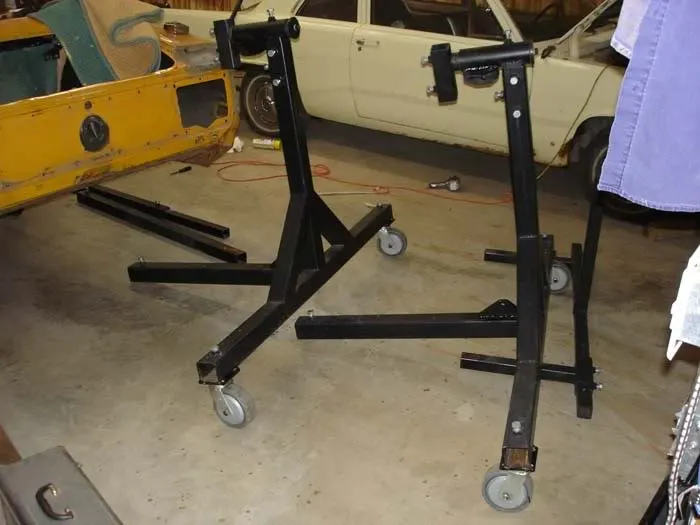

SO I'VE DECIDED TO BUILD MY OWN ROTISSERIE! :nice:
I'VE GOT 98% OF THE STEEL I'LL NEED AND THE WHEELS AND HYDRAULIC RAMS TO LIFT THE BODY HIGHER OFF THE GROUND. I SURE DO LIKE HARBOR FREIGHT, WITH THEIR DISPOSABLE TOOLS AND CHEAP MADE IN CHINA CRAP! BUT AT LEAST IT KEEPS THE COST DOWN. SO FAR I'VE SPENT AROUND $250.00 FOR STEEL, RAMS, AND WHEELS. MORE TO COME ON THE $ AMOUNT AND THE PROGRESS OF THE BUILD. AS WELL AS PICS!

looking pretty good... I can see what steel you are missing. If I were you, Id buy a piece of steel that you can connect the 2 rotisserie pieces together with since they will be on wheels.
Like I said, I only have 98% of what I need. I'm getting some more square and the round tubing didn't make the photo. And yes I'm going to connect the two ends together. I'm planning on having the hydraulic ram height adjustable. I'll try to get a lot of pics. More to come.

just a word of advise...keep the rams close to upright as possible or the front bracket will not rotate a full 360*

I bought the 3 ton, I figure the whole car fully assembled weighs close to that. So a stripped rolling chassis should weigh even less. The wheels are swivel casters rated at 375 lbs. apiece so I'm looking at 1050 lbs. per stand, which is plenty. I'm planning on welding my wy wheels on, but I could also use U-bolts and bolt them on. Anyway I bought all of this at Harbor Freight: $40 Per cylinder, $17 per caster wheel, that equals $182 with a 10% COOPUN. Not including some more tools, which includes a chop saw (love that thing). Which cost $100, but it has paid for itself in time savings alone. I was cutting some gussets from 3/16" stock tonight and it goes through it like butta :D I've still got a long way to go, and getting the time is a pain since my real job gets in the way. And the constant nagging from the girlfriend that "I don't spend enough time with her." But I'm hacking away at it and deviding my time like anyone else. So that's about it for now, I'll put up some more pics when it gets a little more interesting. Thanks to all who have put in their 2 cents and encouragement.

What gauge thickness did you go with on your steel? 1/8??
The main portions are square 2"X2" 11 guage, which I believe is 1/8". The sliding parts that allow raising and sliding adjustment are 2 1/2"X 2 1/2" 3/16". The round tube that I am using is 2" I.D. 1/8" thick. Which I might change to a thicker tube. All is being braced (gusseted) by left over 2" X 2" and 1/8" thick flat steel.
Well this is what I got done this weekend. Not much but it is progress! For those interested I used U-bolts to attach the wheels to the rotisserie. I'm still contemplating on whether I'm going to weld them as well for more strength.
