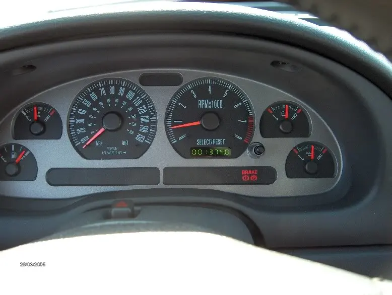

Stangfanatic98 said:
Well, if you do decide to add another personal touch to your gauges, I'd suggest getting aluminum gauge rings, unless it's not your style. I love mine to death even though it was a pain to install :D
Those look absolutly sweet. Custom job? If not, whered ya get the gauges and/or trim?

Well personally, I got the guages because I think they look sweet at night. Blue/green color inverter and dimmer switch under my console so i can make the gauges darker than my needles...oh so sweet. My avatar is a pic of them at night on full brightness.
