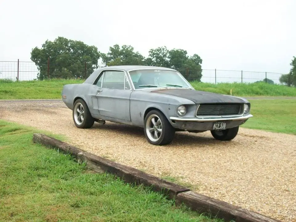

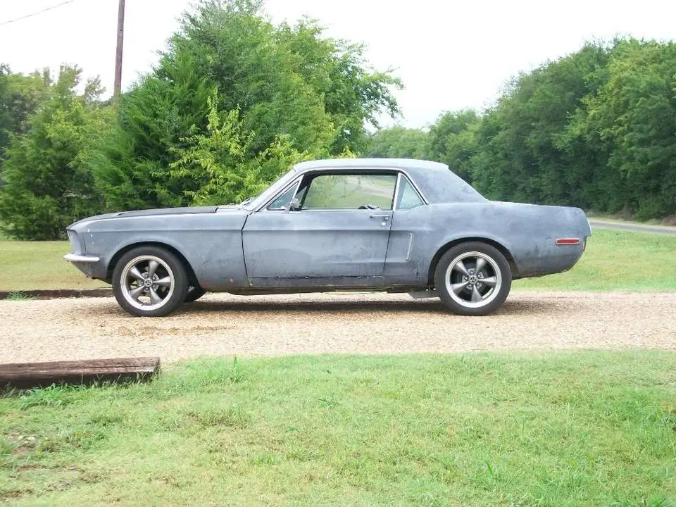

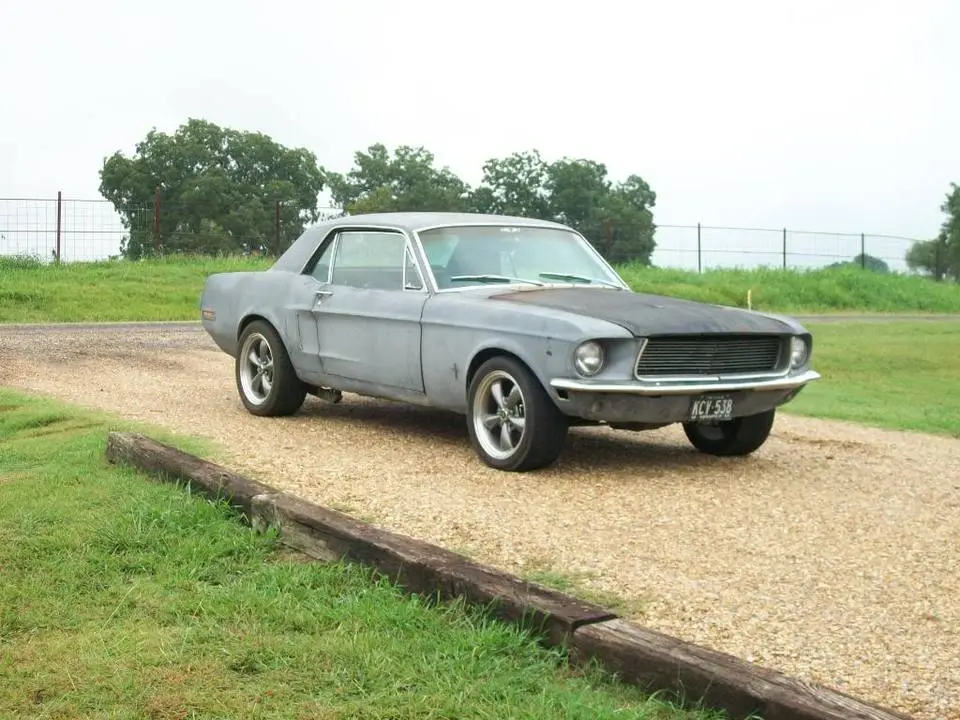

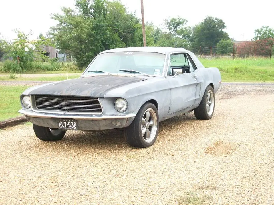

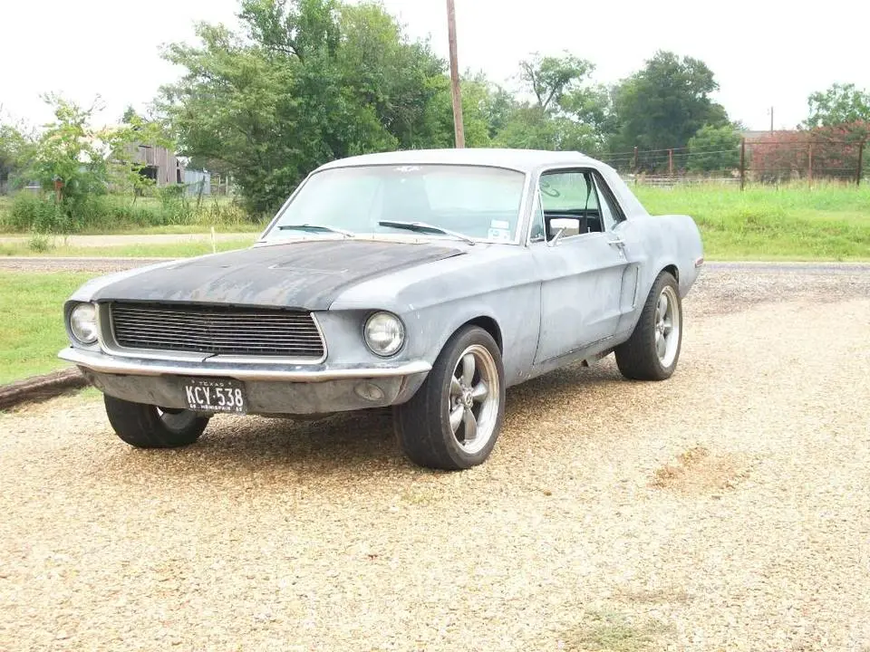

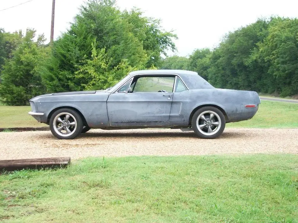

Actually, I went out and looked in the garage, I have 1 inch for the front and 1.5 in the back. You really want 1 or maybe 1.25 in back because mine rub sometimes. 245/45 on all 4. Here's a couple of pics.
