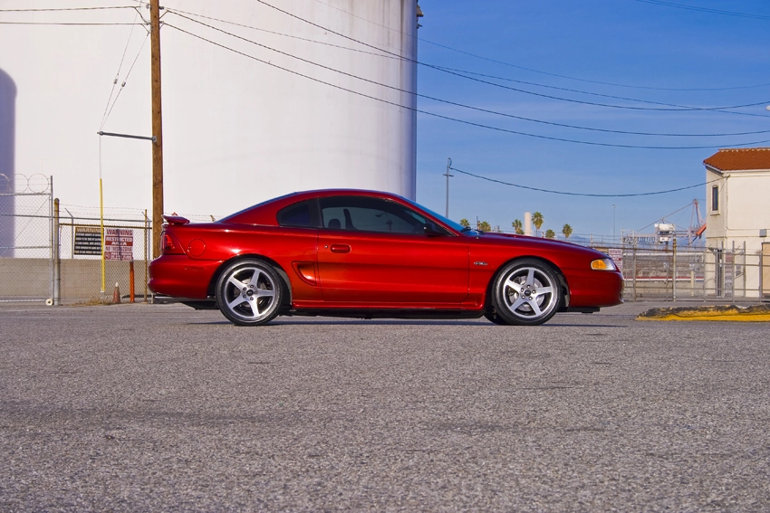

mine is very extreme because my car is REALLY low.

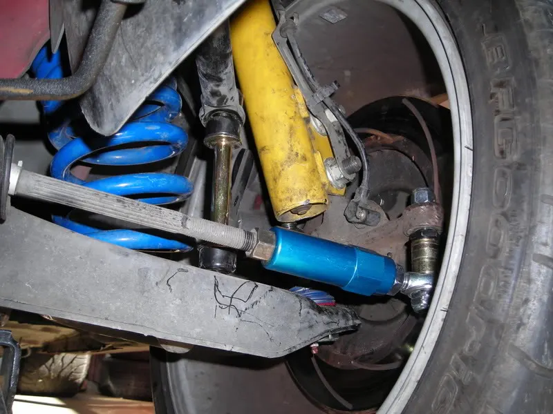

I think the lower the car sits, the more spacers go on top of the tie rod?? Heres a pic of mine, & this was when I still had H&R ss's in front...My car sits about 1/2" lower now...

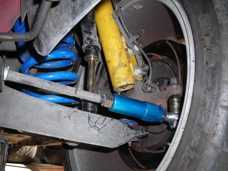

The first thing I did was try and get the tie-rod parallel with the lower contol arm by eyeball to get somewhat close. You will notice in the supplied pic by EPIKGT that is exactly how his setup is sitting. You will have to do this thru trial & error with the supplied shims. MM has very specific instructions using a gauge. I used the board and jack method to get even closer. After getting it as close as I could eyeballing it, I then reinstalled the wheel with the jack stands on the frame, letting the suspension droop. I then placed the floor jack under the tire and began to jack it up towards the ride heigth position, which I had noted when the car was on the ground. I then layed a board or piece of plywood upright laying against wheel/tire. Begin jacking the droop thru the compressed suspension area and noted the movement of the board. What you are really watching is the toe change thru the suspension travel causing the dreaded bump steer. MM wants you to use gauges in their instructions. I only used this method to get it closer than eyeballing it. In the end, I took it to a specialized frontend shop and had it completely dialed in with gauges. It cost me about $150 with a complete frontend alignment. I installed my Sportline springs, CC Plates and bumpsteer kit all at once. Definitely cheaper to do all of this all at the same time. Do not use a typical Goodyear or Firestone place. Those guys can barely adjust the toe. Hope this helps.
