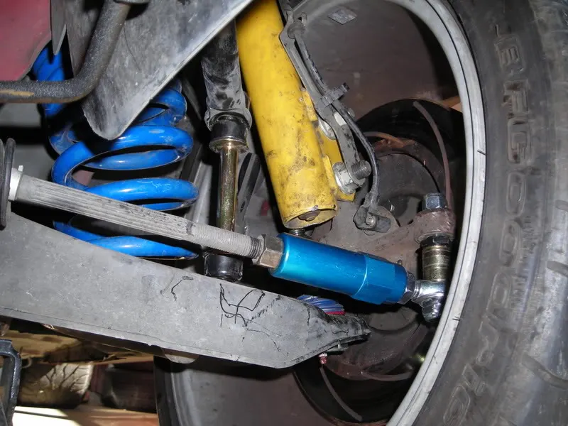

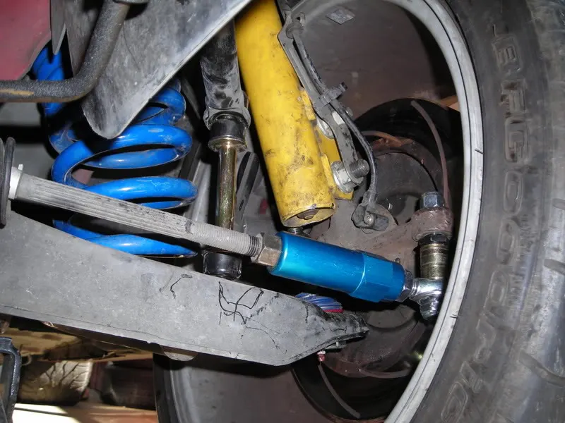

its definitely worth the time & money. I have the steeda kit & the X2 balljoints on my 03 & it made a huge difference in the feel of the front end, & it tracks alot straighter over bumps. My 95 sits about 3/4 of an inch higher than my 03, but the bumpsteer on the 95 is far worse since I didnt do the bumpsteer kit on there when i lowered it...
I think the lower the car sits, the more spacers go on top of the tie rod?? Heres a pic of mine, & this was when I still had H&R ss's in front...My car sits about 1/2" lower now...
