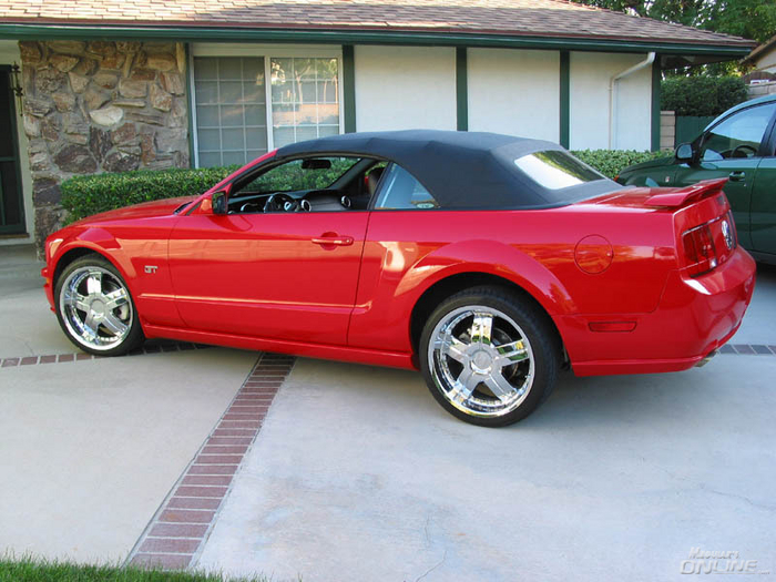

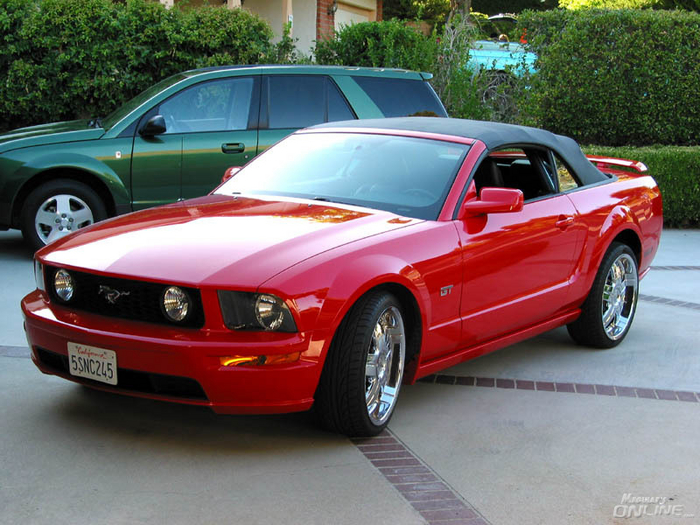

I'm pretty happy with my '05. Relative to the '01 GT 'vert I had before, there are a few things I'm not crazy about, but they're fairly minor...
First, am not crazy about the drive-by-wire throttle... feel too disconnected from the engine & usually over-rev on takeoff. Second, the use of plastic/composite materials in the top mechanism generates a few rattles on rough pavement, tho most of that is due to the 20" wheels. Third, I also am dealing with parasitic power drain on the battery, as mine sits in the garage quite a bit (3rd car). But none of this really deters my enjoyment of the car...
