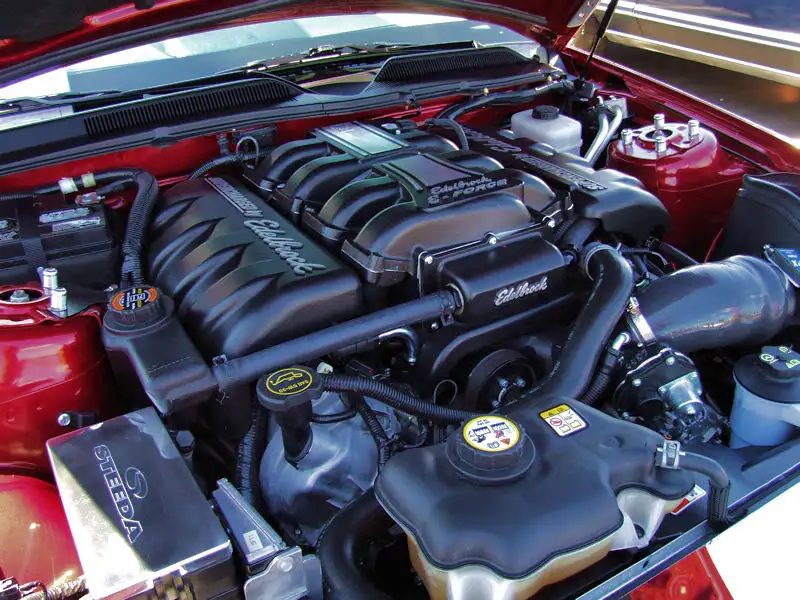

If I was buying new, I would get the Edlebrock. Very nice kit from everything I read.

Edelbrock would have to pay me for the advertising space if I went with the E-force. Come on - four big bold name-whoring ads all over my engine! Are you kidding me?
