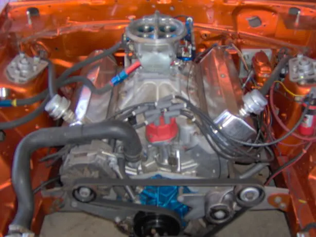

powerglide
I switched my car from a pa super comp c4
to a bte powerglide and I picked up 2 mph
and lowered my e.t. My combo makes roughly around 700 hp
and my car weighs 3100 with me in it.I would go with the glide as long as you can turn some high rpm. I am also running a 8" converter.
View attachment 4951917/radialkiller/IM000118.jpg[/IMG]

Hmm,pretty nice there RADIAKILLER.Mind sharing your set-up,I got something simalr and would like to know what your runing.
Thats pretty impresive you picked up 2mph by switching to a glide.
