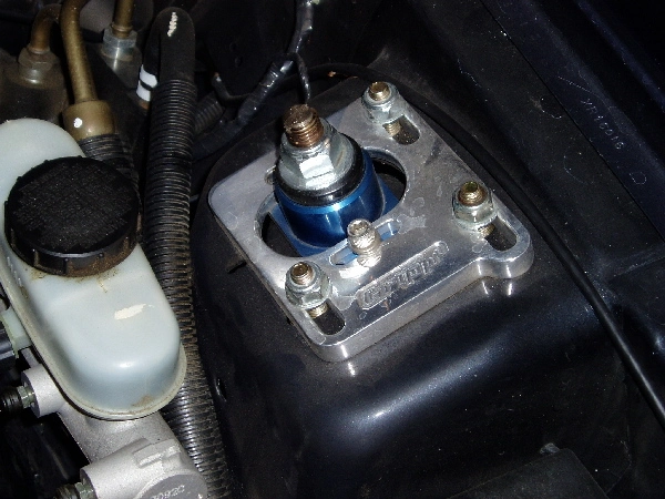

I used the Steeda CC plates on my Mach1 and the J & M's on my Son's GT. Both are 4 bolt design and both are great functional units. The install was easy and both kits had very good instructions.
Here is a photo of the Steeda's, note they did not come polished as in the picture, I did that before the install.
