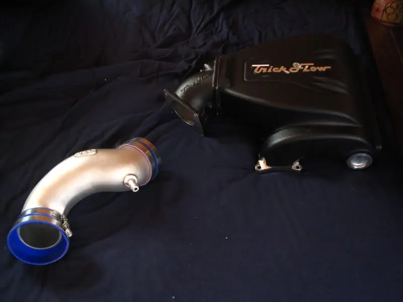

I am about to install my NX nitrous kit on my '89 GT and I want to do away with my stock intake tube. Is the C&L TRUEFLOW 76MM MAF SYSTEM better than say a BBK/Mac cold air intake kit? I plan on using this intake in the future with a 331 stroker and a 150 shot of nitrous. Thanks for any help.

You dont have to run the C&L Mass air meter. You can just get the True FLow Tube and run whatever meter you want and the filter. Acts as a CAI
Just to give you an idea. Elbow adaptor, then throttle body, then true flow tube, Mass air meter, then the filter.

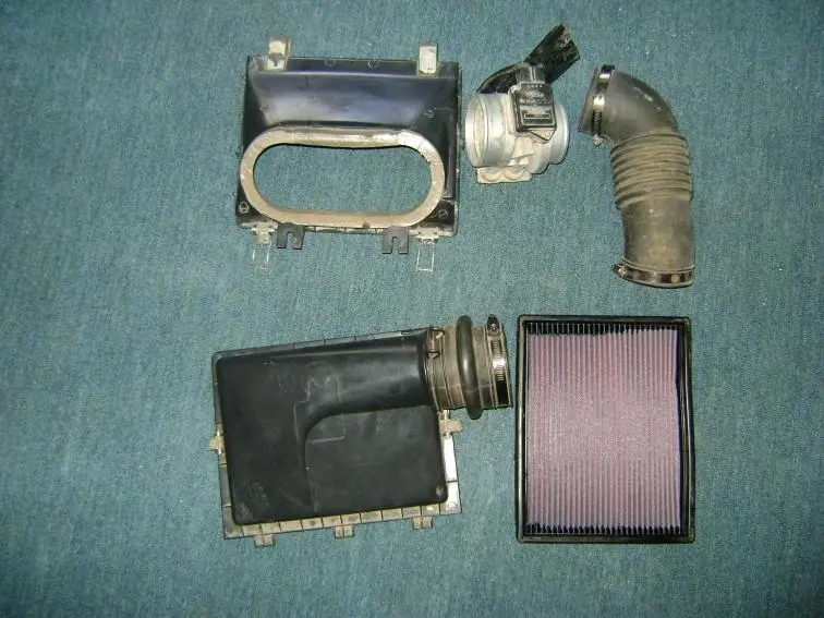

Think about the difference in heat absorption between plastic & metal air intake plumbing. Metal tubing will be hotter than plastic. The stock airbox is very efficient cold air intake once you remove the air horn on the fender side of the air box.

Thats what he's talking about, chances are the air horn/air silencer has already been removed by a previous owner. Once you get rid of that peice of junk the stock airbox and tube with a K&N flows just as well as a CAI, but it doesn't look as good.

I just put my stock air box back in with a K&N panel filter. I replaced and engine bay filter. MY Intake air temp sensor has been relocated to my C&L intake tube and I noticed about 20 degree cooler readings on my PMS on the air tems comming in. Obviously sitting still doesn't do much but barely moving its a ton different. Not as pretty and doesn't leave me room for a MSD box under the hood but works great for free.

Don't know about bigger TB with 19lbs injectors, but just a heads up with cone filters as I have one with a C&l. It sucks in hot air and I have idle surge issues, it's fan wash into the mass air meter. Idled good hood open, like crap hood closed. C&L recommended using stock air box or a shield for the cone style filter, or extend filter past altenator. I have a stock air box, MAF meter tubing etc if you need one as my car seemed sluggish with the stock box installed (dyno tuned with cone filter)......Still haven't found a shield for mine.
