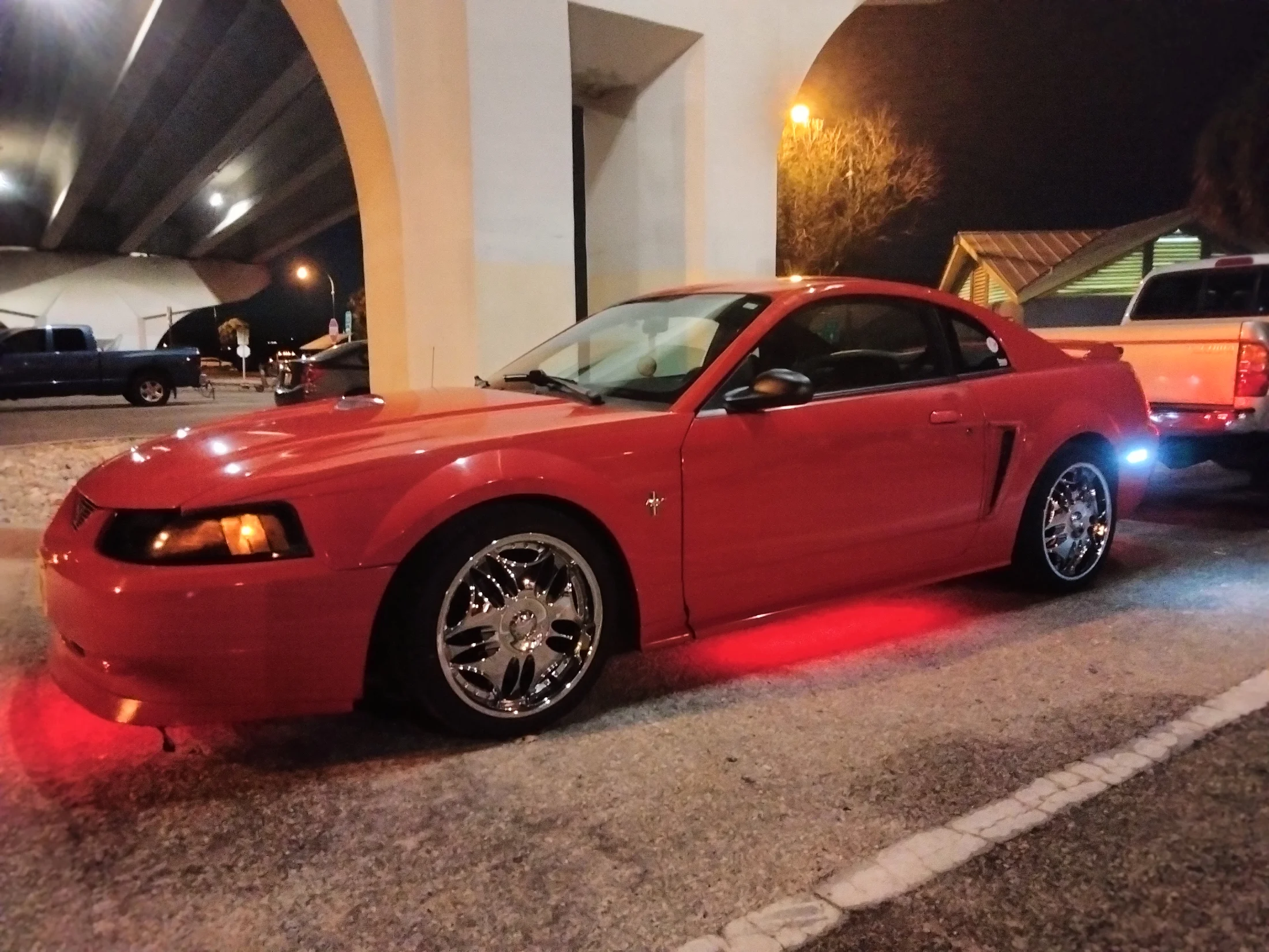

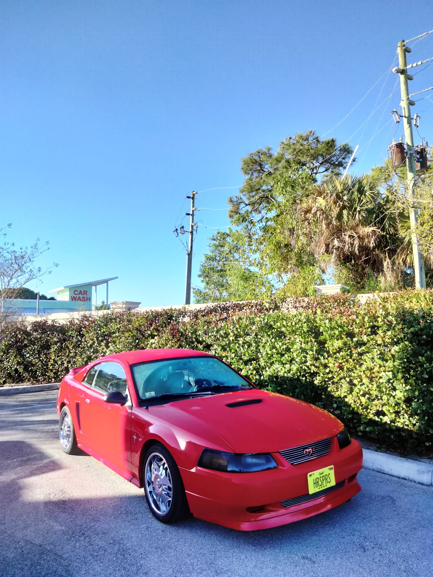

I seen so many people talk about getting a pro charger, turbo, or blower for the 3.8 l V6, but that stuff is insanely expensive. Like title says it's my first car and it's definitely a good intro to mechanics, though I want more power. I have that common aftermarket cold air intake with stock MAF sensor, completely redone exhaust with BBK shorty headers, catless xpipe, and Pypes Street Pro true dual mufflers (over axle setup). Stock injectors but I have a screaming demon coil pack, and .060 spaced copper spark plugs. I also run an oil catch-can with a 4 mm orifice in the line from my PCV to intake to limit the blow-by vapors decreasing the fuel octane. As well as 5W-40 Castrol edge Euro car oil (good for old & hot engines). and 93 octane tunes from Bama, street, performance, or race with datalogs in process. I've heard a lot about changing diff gears, cams, rockers, and even adding nitrous being one of the heavy hitters for power. Any recommendations or easily budgetable ways to add power?
