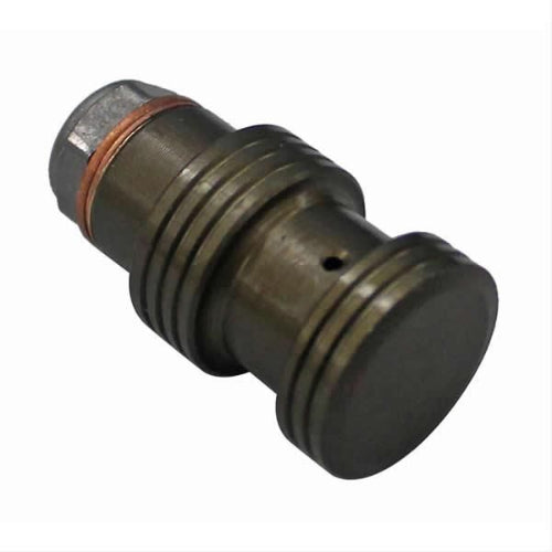

I have hydroboost, but I never upped my pressure. I did buy a pressure relife valve for the C2 pump that will output 1600psi, but I always thought that might be a tough to high so it sits on my bench.
