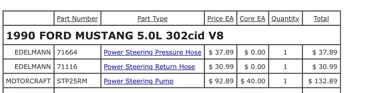

I just replaced my pump (and complete steering system) and i bought a remanufactured Motorcraft pump from RockAuto and shipped them back my core. Works like a charm, no whining whatsoever.

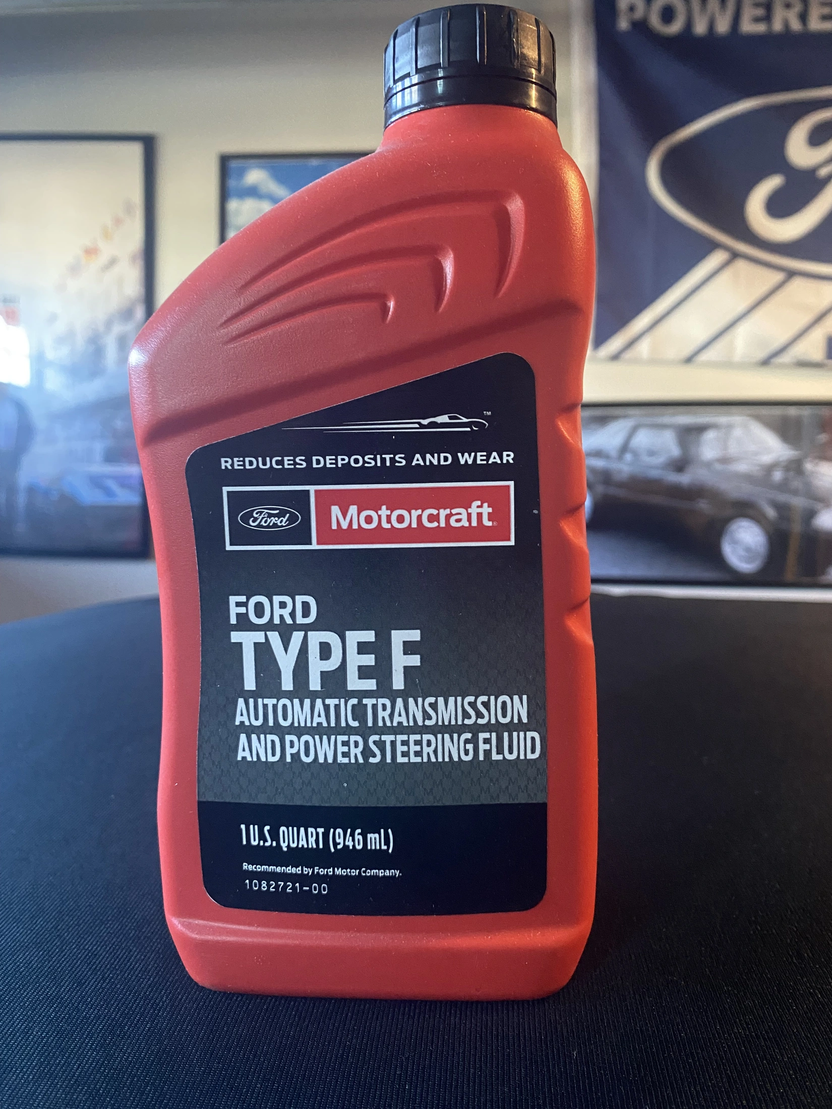

I used the Motorcraft Type F proper PS fluid. I'd have to go search through my thread for the exact P/N, but it was a red bottle of Ford specific power steering fluid. I bought a case of like 5 or 6 quarts, I could ship a quart or two to you if needed. They are buried in my garage at the moment during my home remodel so it might take me a second to get to them.

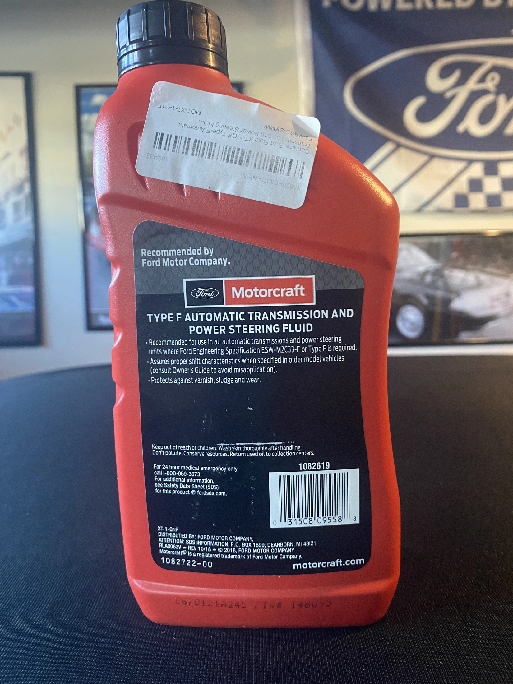

Found it (had to dig deeeeep in my thread):
