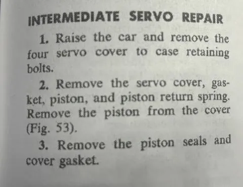

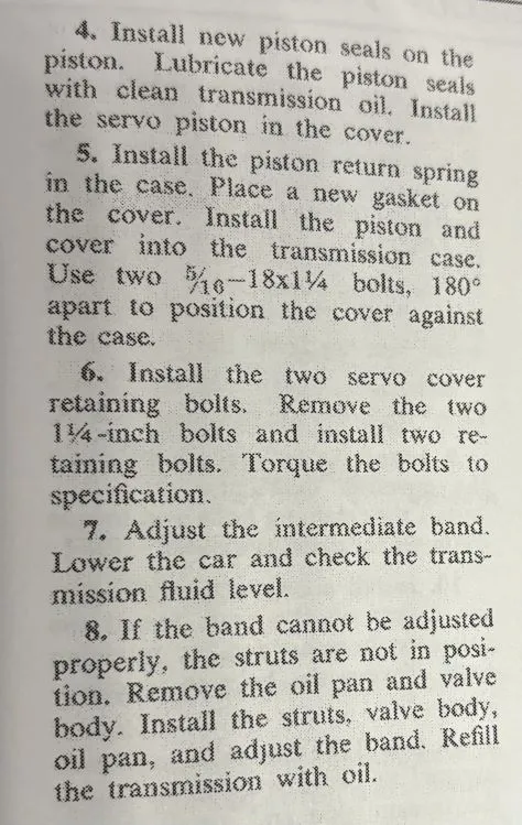

Sure can, here is the procedure:

Thanks so much for responding!
The transmission is running fine and shifting very well, ideally I'd love to just change the gasket for the cover to stop the leak. I have seen a lot of chatter about a spring or a band adjuster falling back into the pan or something (which i really do not want to have to remove again)... any concern there?
I'd love to keep the piston and everything in place and just fix this cover leak.

I don't have a lot of experience with C4 transmissions other than doing a band adjustment and changing the fluid and filter, but I've never heard anything about parts falling into the pan.

Hello Justin has you reach to change the cover gasket without any problem, I need to do the dame procedure and I've fear that some parts can be falling back into the pan. Let me know please.
