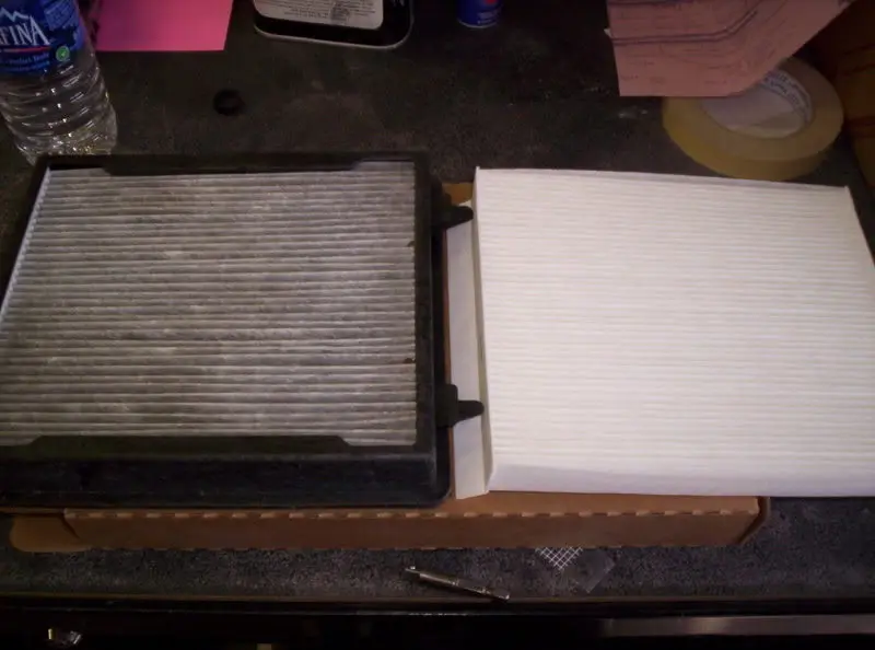

i changed mine this week and it was filthy. i only have 20,000 miles and it was really needed!
i took pics along the way, so if anyone wants real pictoral installation instructions other than the brief instructions from the link above, let me know and i can put something together.

one other thing i recommend is to check inside the cowl for debris. on older cars, stuff gets down there and collects moisture. then it causes a huge rust hole. :mad: so while you are looking in ther, clear out anything that may be inside. i had nothing, but just look to be sure so your car will last a little longer. :nice:
