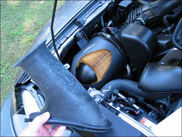

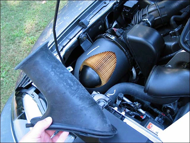

To answer your other question, the silencer is located on the airbox and sticks into the fenderwell through an access hole in the fender liner. It looks like this:
(NOTE: Shown is a Mach 1 setup. The opening in the airbox on a GT actually faces the passenger side fender...) The silencer itself, what the guy is holding above, is pliable rubber and slips into place in the airbox.
It already does a good job of pulling cooler air from the fenderwell but can sap a horsepower or two due to minor flow restriction.
