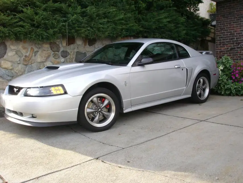

This is the $15 brush on Duplicolor kit, but i have used the $7 VHT caliper spray paint can as well with good results on my other Mustang
The Mach 1 calipers looked too plain

I did mine with the Duplicolor engine enamel - Ford red. Lots of masking, and a goodly amount of wire brushing, followed by plenty of Brake Kleen to prep the surface. Seems to be holding up pretty well, and I've been driving the car a LOT this summer.
