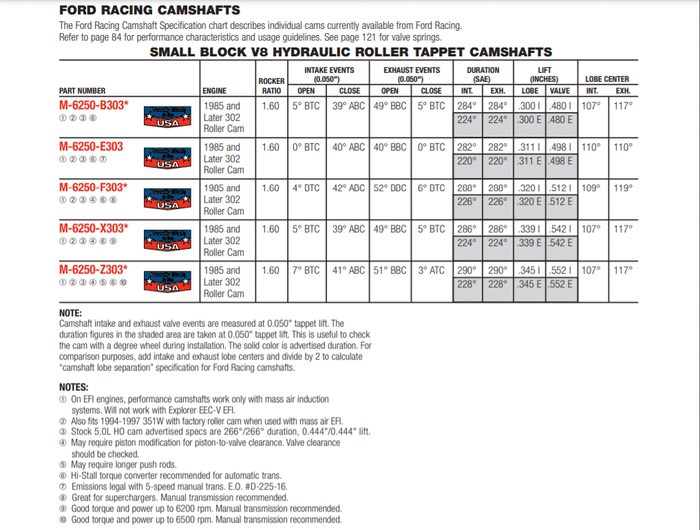

I am glad to hear that you got it running, I don't have much input from Stangnet about the X cam. Check the lobe separation data against the figures for the stock cam The less lobe separation,, the more lumpy the cam will be at idle.
See https://performanceparts.ford.com/download/pdfs/FordRacingCamshaftSpecs.pdf for some input directly from Ford.
