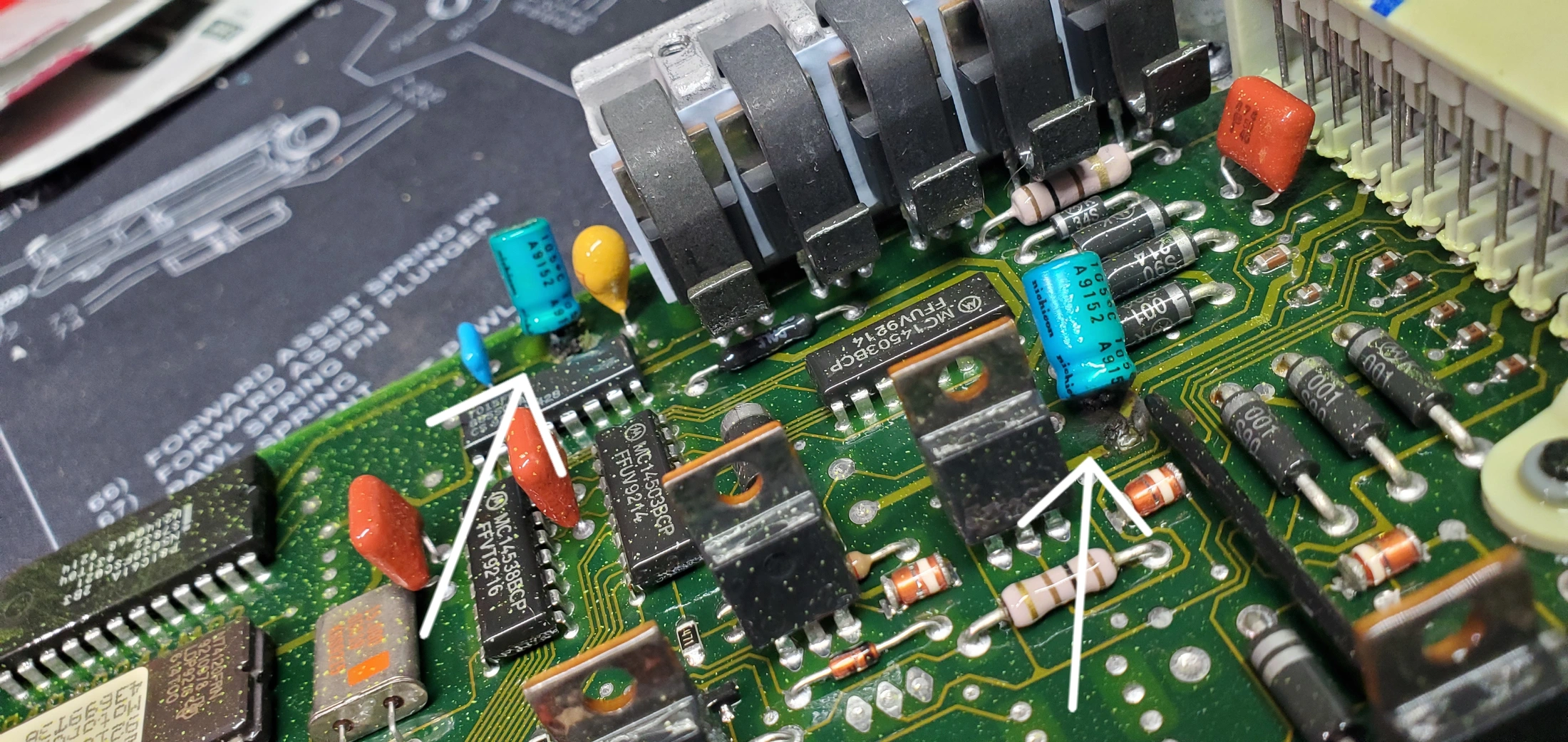

how is the ECU ? did you check the caps?
I haven't checked the computer but my battery wasn't holding charge so I changed it and now it revs up but it still has a "cut" when i keep it at certain place, so now maybe it's just a misfire?
I would check the Ecu it might need a repair .
Open it up post a picture of it and Send it here if it does need a repair best place to repair it.
Ok thank you, I'll take it out and take a picture

We are seeing all kinds of issues with these processors as they age. Right now an ECU out of a 1993 car is literally 32 years old. Some of the components are aging out and failing. Some are just sending them off to ECau Wxchange to have them go through it for a piece of mind. I had mine done about 20 years ago (bought a bad one when I swapped the car) and it’s still rock solid. Something to think about as a winter project if you are lucky enough to park the car for the winter.
This is my ECU I swapped out couple months ago. Just an example of what to look out for. The issues this caused made me rethink my entire life.
