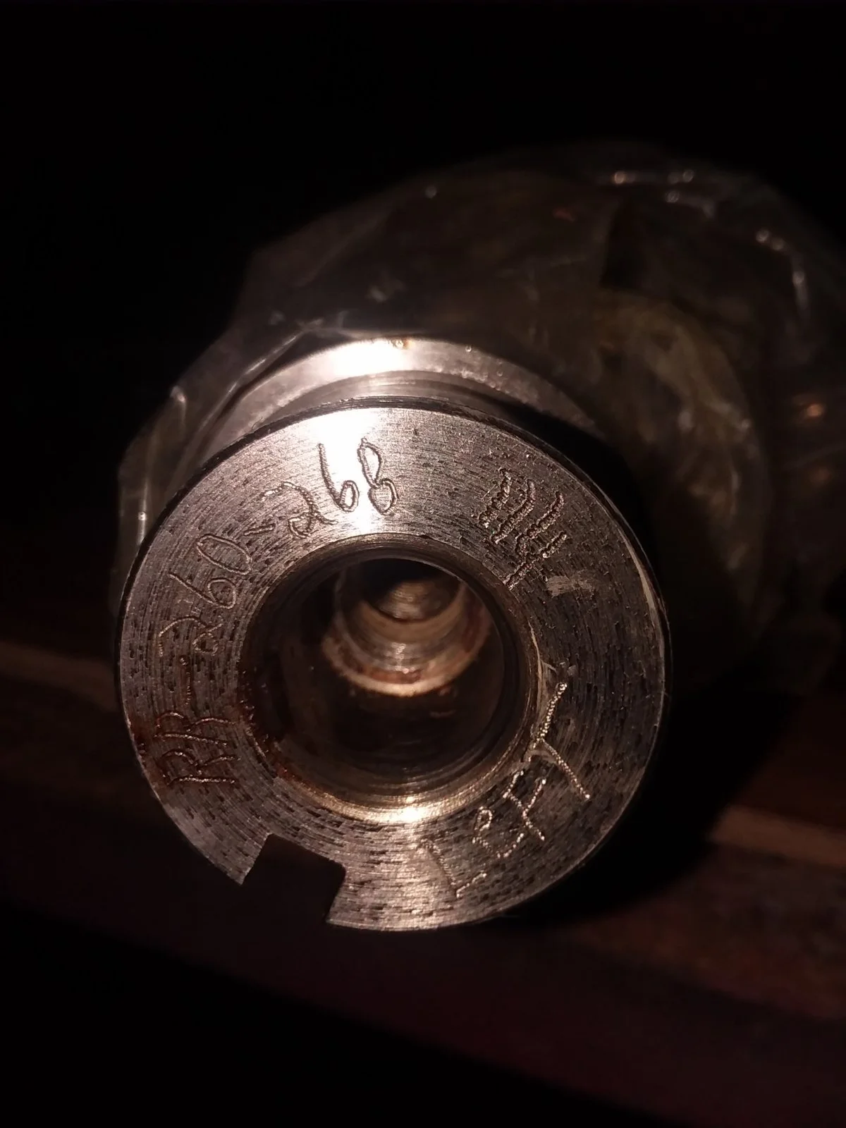

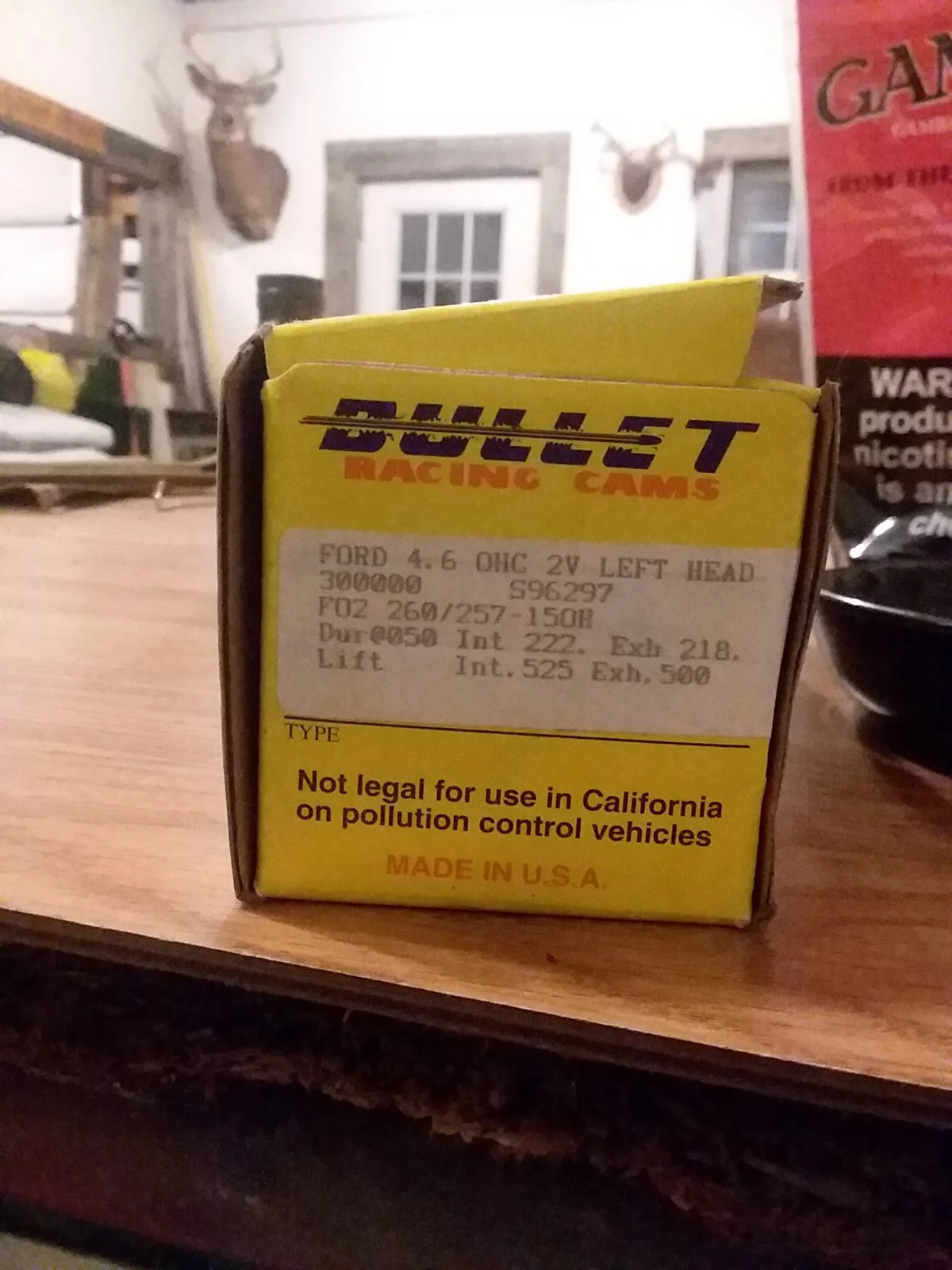

Can someone tell me if these cams I got with a stock 01 4.6 engine I purchased will work with it, new to cam changes so any info would be appreciated

Values correlate on the box with those engraved on the Cam, advertised duration being 260 degrees Intake, 268 degrees exhaust, 114 Degree lobe separation angle. Valve lift & duration @ 0.050 .525/222.&.500/218.
No rocker ratio listed, yet as they were usually 1.8:1, take Advertised lift & divide for lobe lift..
0.500/1.8= 0.2777(0.278),
0.525/1.8=0.2918(0.292)
Will they fit? Yes. Recommend a clay test, as there’s unknowns (extremely remote there’d be an issue). Idle to 5,000 I’d guess. Very streetable Cam, FI or NA. Bullet does a lot of 4.6/5.4l grinds, take a look at their site.
The OE 4.6l 2V cams spec out at 0.512/0.540 lift, with duration at 0.050 of 200/204, had a very wide lobe separation angle, 116-118Deg.
So, less lift than OE. Not unusual with aftermarket 4.6l 2V “drop in” Cams as motors didn’t have lots of room for high lift, duration is the other way to go for HP. It’d be a notable bump over stock, not crazy. Have the Cam Card or any other info given when you purchased them?
Looks a lot like an XE262AH grind in regards to duration, with less lift.
