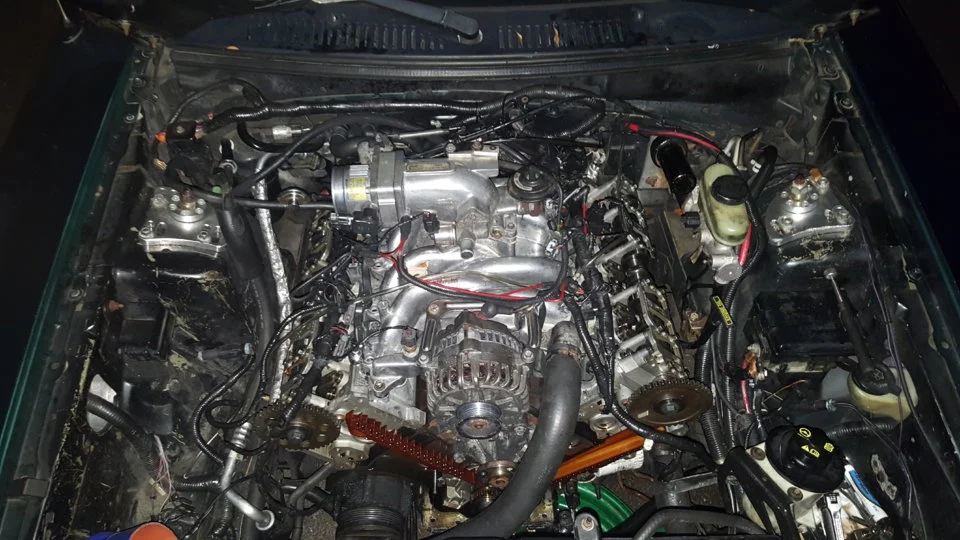

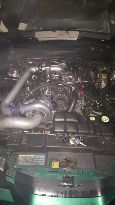

I have been meaning to start my cam install a few days ago but with work and life I just couldn't get it underway. I was planning to put it off for another few days but this morning I just decided to up and just do it. So at 615 am I went out and got started. I called it a day at about 1030 am...gotta get some things done for the day. Thus far I got both valve covers off, the timing cover off, and the crank keyway is set at 12 o'clock. If I have time later today or this evening or tonight then I'll go back out and pull the stock cams off. That way I can start fresh with putting the new ones in tomorrow morning. If all goes well I should be up and running by tomorrow night or Sunday afternoon. Here are some specs on my car...
03 Mustang GT convertible automatic. 4.10 gears. Built trans with upgraded internals. Transgo Transpak. 2400 rpm stall converter. Stock PI bottom end. Patriot Performance stage 2 heads. Stock cams (for now). Stock exhaust manifolds. UPR HF catted X-Pipe. Cherry Bomb cat-back. PP intake manifold/upper plenum/75mm TB. Vortech V2 S-Trim supercharger non-intercooled with 3.33 pulley (approx 12psi boost). Steeda power pipe. 60# injectors. Sniper Bazooka MAF...also have a SCT BA 2400 MAF.
The cam going in is a custom grind from Comp Cams. Specs are 234/234 @ 050. 545/545 lift. 115 lsa.
See pics below!!

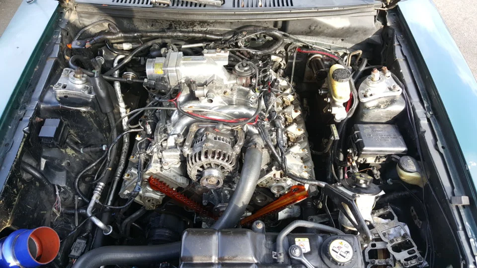

This is how I started off...

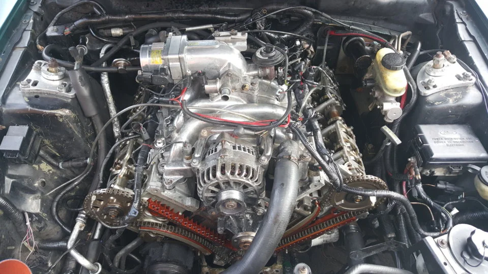

This is where I left off for the day.

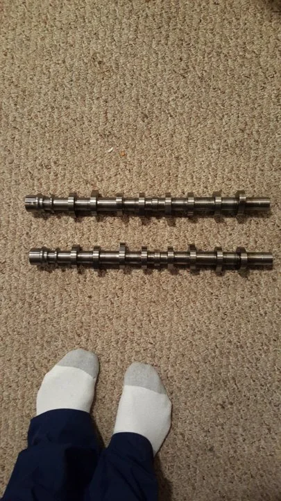

And these are the cams that will be going in...

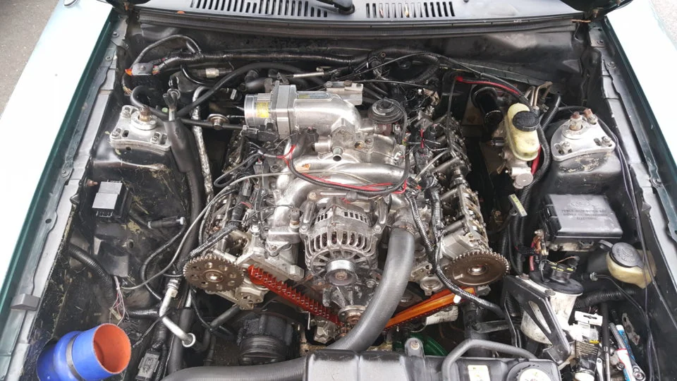

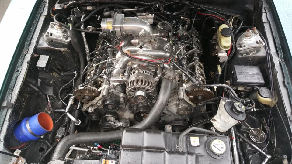

So I got back out there and took the old cams out...
Got the new cams in but the sprocket retaining bolt I have is too small. Gotta hit up the dealership real quick to see if they have the larger size bolts. If not then this will be on hold until Monday...

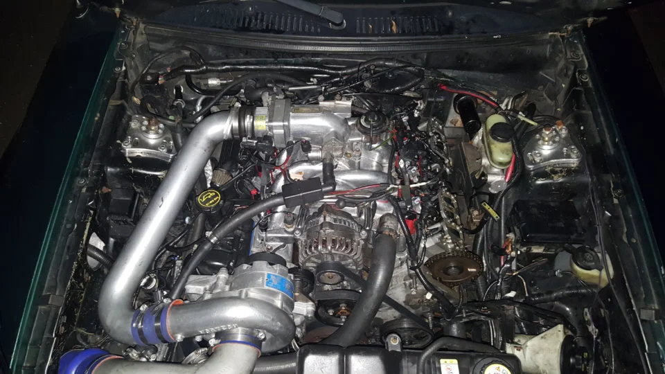

So here is where I'm at. Cams are in, cam cages are on but not torqued. Cam sprockets/bolts are on but not torqued. Tomorrow I will button everything up.

Almost doe! Taking a break due to the weather...got some rain. I'll finish it up in a bit!! Should be up and running tonight!!

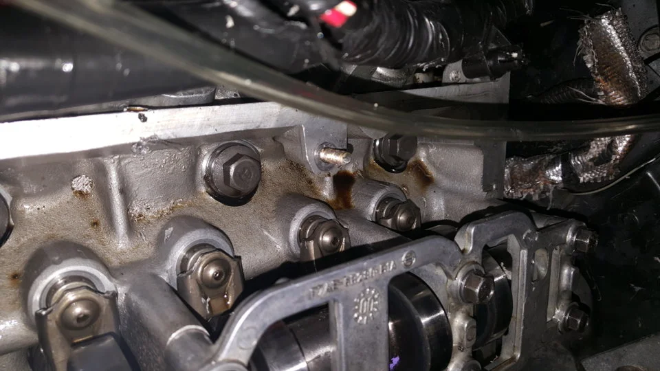

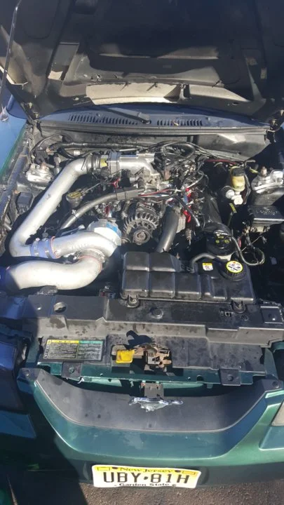

Got held up by this here. A valve cover bolt broke off in the cylinder head. So I gotta get it out before I can go further. Hopefully Home Depot or Auto Zone has a bolt extractor I can use. I already tried vice grips and channel locks with no luck.
Despite that I still made good progress. I got everything bolted back on. Once I get the broken bolt out I can get the valve cover and power steering reservoir back on, tune it, and fire it up!! Stay tuned!!

Ok so she is up and running. I extracted the broken bolt by hammering a 5mm socket on it and using a ratchet to get it off. Got everything put back together and fired her up! She started right up! Now I just gotta go tighten things up and tidy her up a bit!! I recorded the first start so I'll upload that video in a bit!!
