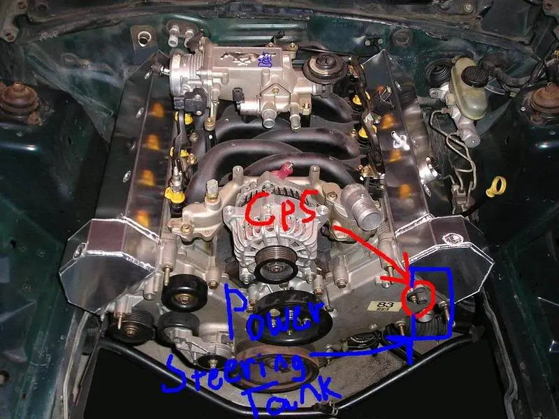

my car is throwing p0340 code, where is the cam position sensor? If this isnt the problem what else could it be? i read something about checking the regulator but i dont know what or where this regulator is... any help is appreciated

A bad diode in the altenator can also throw that code.had it happen before.Actually if the diode gets bad enough it will throw all types of codes.

The CPS rarely goes bad.
For some reason, a faulty diode in the alternator causes this code to trip as well. Most often, it's usually the alt.
