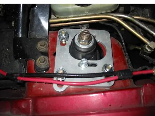

Alright, this is sort of a repost but with more info...I went to get an alignment yesterday and the shop said that the drivers side camber can not be adjusted any farther because the camber kit hits the fender well. Could i just hit that part of the fender well with a hammer and dent it in? I know i would get the camber all the way correct then.... But anyways the camber was -2.3 and the caster was 2.6. The car has caster and camber plates on it and i have droped it 2 inches. Oh and it also has brand new tie rods. Here a pic of it, BTW does the plate look installed correctly from as much as you can tell? Anything i can do to get these numbers looking better? Please Help!

I don't think your alignment guy knows what the hell he's doing if he can't bring it into spec with camber bolts AND c/c plates.
My car is lowered 2" and is spot-on with only camber bolts.
Either somethings installed way wrong or theyre idiots. Likely the latter, since they should be able to spot if the plates were installed wrong.
