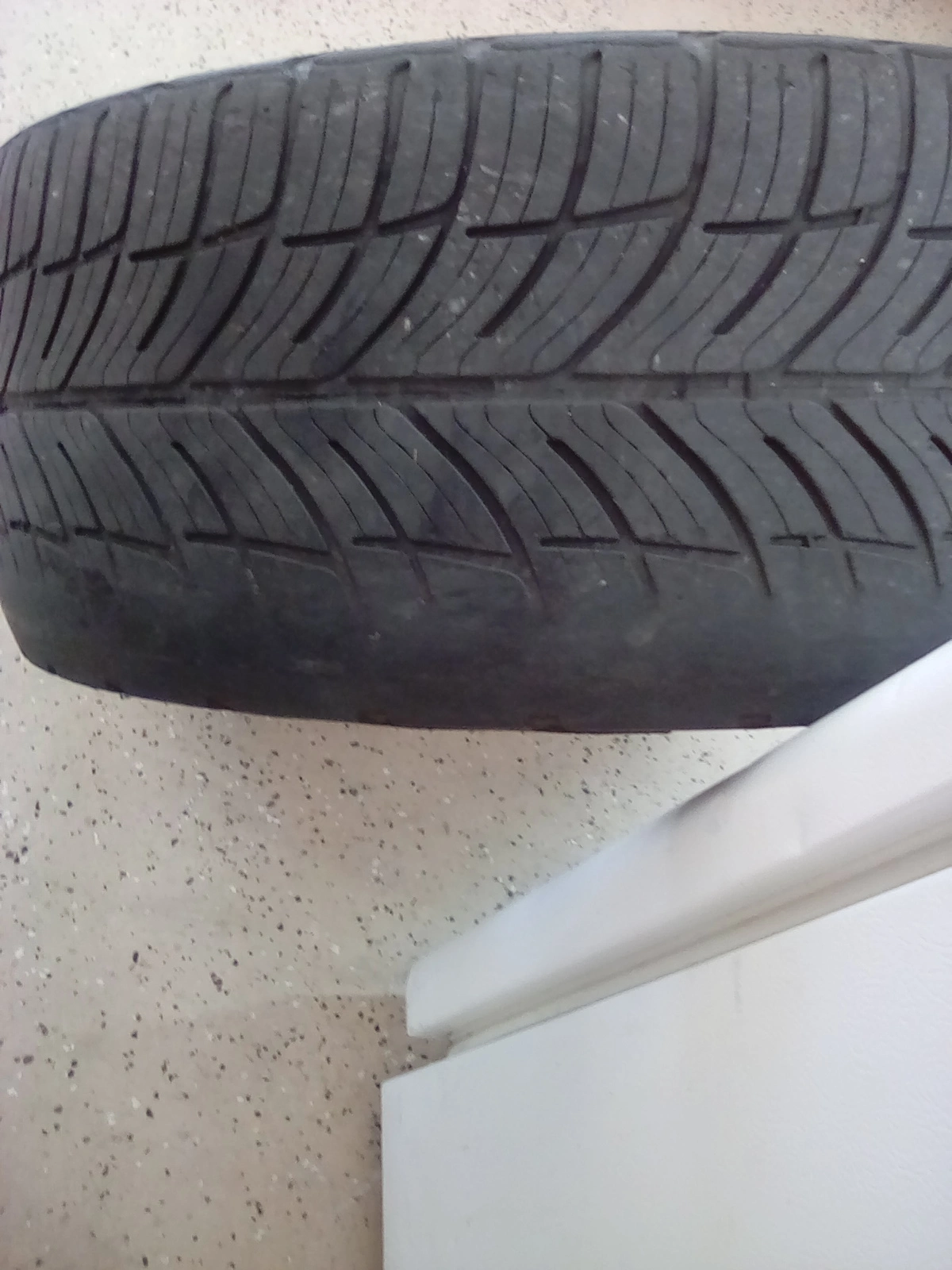

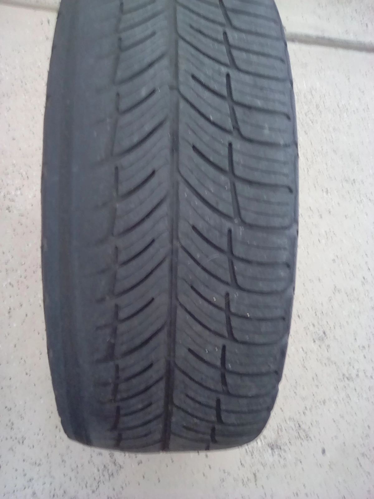

I noticed some inside wear on my front tires about two months ago.
I just don't have the energy or drive to work on my baby, pretty depressing as I feel soo f 'ing old..(61 this month) 4 surgeries in the last year.
Took off today so I could swap front to rear tires,and buy sometime till I install my caster camber plates and get an alignment.
I'm hoping this weekend I can install them and get her alignment, then I can buy two more tires.
Ya think they'll be o.k. On the back till then?

Ahhhh, maybe.
When it comes to tires and damage failure is gonna happen, it's not if it's when. Scrubbing or tearing of the rubber outside edges will put a lot of heat in that area resulting in separation of layers of tire. That said, around town cruising short distances and no smokey, sideways burn outs and you'll likely be ok.

I don't like the look of the thing. The moment you see silver poking through...
Especially if you have rims that you like.

I think you'll be alright for that. No burnouts tho O_o

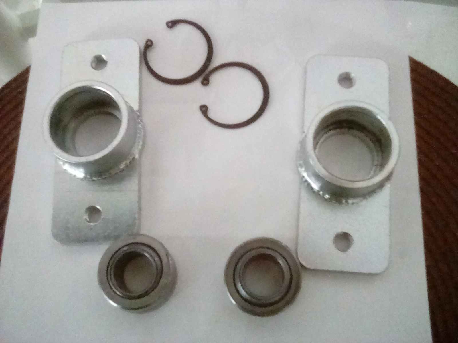

I installed team z caster camber plates I got from lmr on sale a long time ago. I removed everything top and bottom of struts( all bump stop rubbers)
Tightened the nuts on struts and took her out for a test ride, I get a knacking sound so I re tighten nuts and same :poo:.
Gonna take struts off top and install bottom bump stop rubber I don't know if this is gonna make a difference but we'll see.
All said and done I'm fubared. The team z caster camber plates spherical bearing on drivers side has 1\8 inch play in it , so hitting bumps sound horrible.
I'll need to replace that before I get her aligned, so no car for work tommarow. Tried latemodleresto not open, tried team z not open. Left messages, don't expect response till monday. Fuggggg.

In my OCD state of mind last nite I tried to get a replacement bushing( only UPR had em and wouldn't get to me till Wed.),
I didnt want to miss the whole week of work , so I ordered a cheap set of caster camber plates from Amazon cause they overnighted free.
This morning I removed and replaced the team z with the DNA motor ones. ( I'm getting faster at this :poo:).
The bearings were a tighter fit ,less play, almost none really. And test drive went well.
Is it noisier then stock rubber yes.
Does it sound like it's gonna fall apart no.

and Team z is sending me replacement bearings and one sleave/cup. Should be here Wed.
I'll keep these cheap ones on for awhile then give the Team z ones another shot, just sucks I got to get it aligned again.
