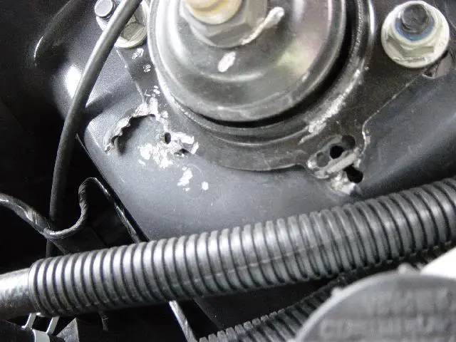

Yes you can...
BUT, if you mess it up, there is no turning back for repairs. Get the aftermarket plates for a cleaner install and less chance of really messing everything up.
Pic below is an example of a mess up... not me though.

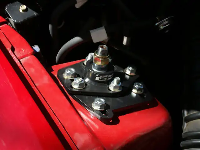

Done right, it can be beautiful...
Mine...
you can but it would be easier to install the plates. plus you dont risk doing some EXPENSIVE damage to your strut towers by taking out too much material and making them weak.

I ended up going for CC plates becasue it is done correctly, with no problems.
Sorry to sound like a broken record, but you really might as well spring for some plates....
