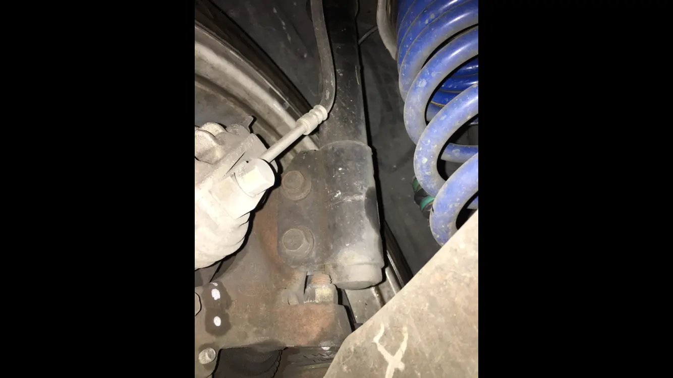

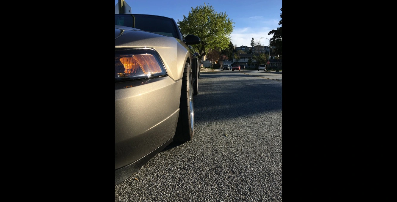

CAMBER(S) - FRONT

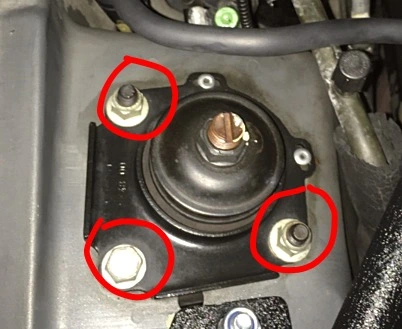

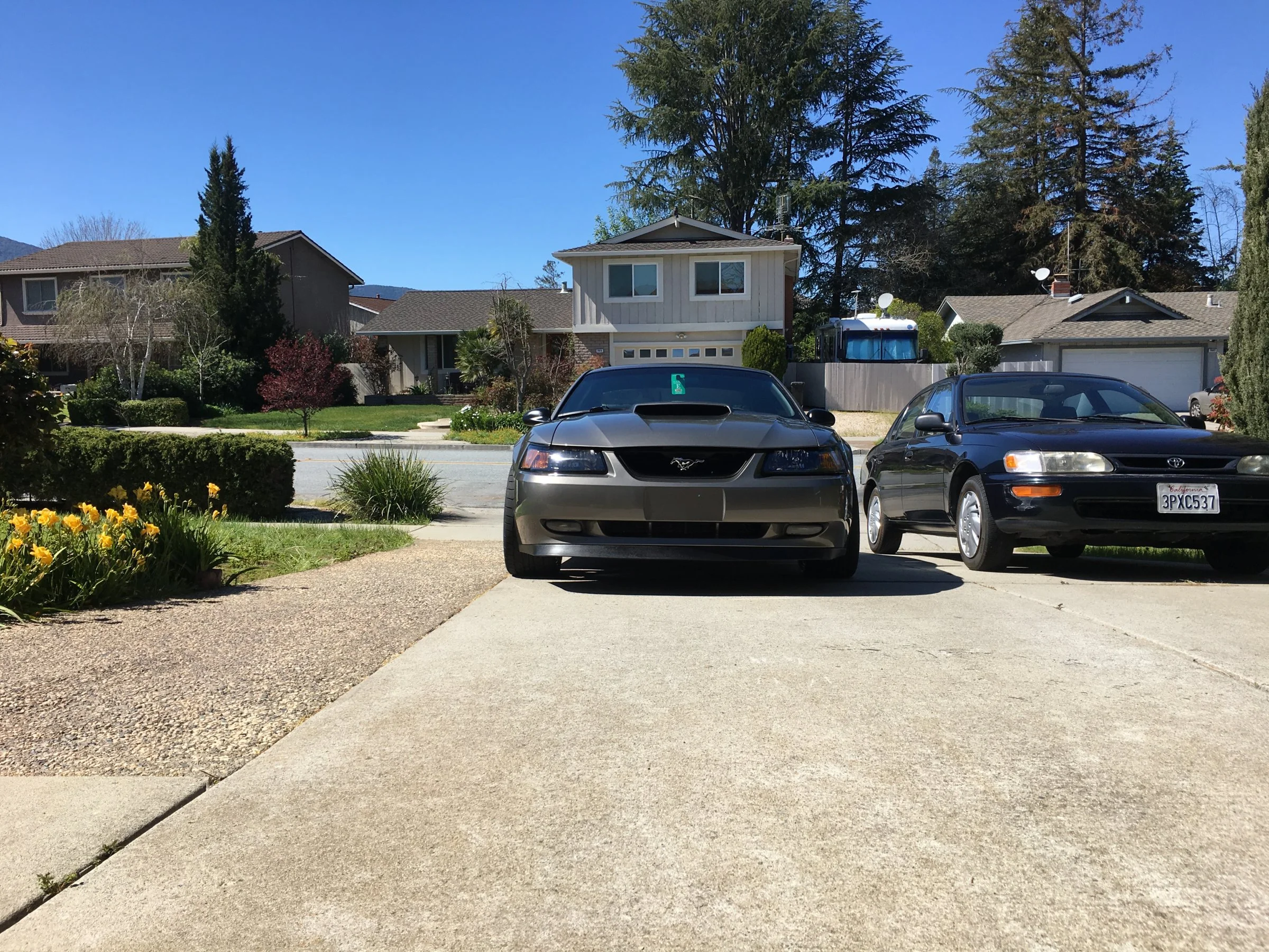

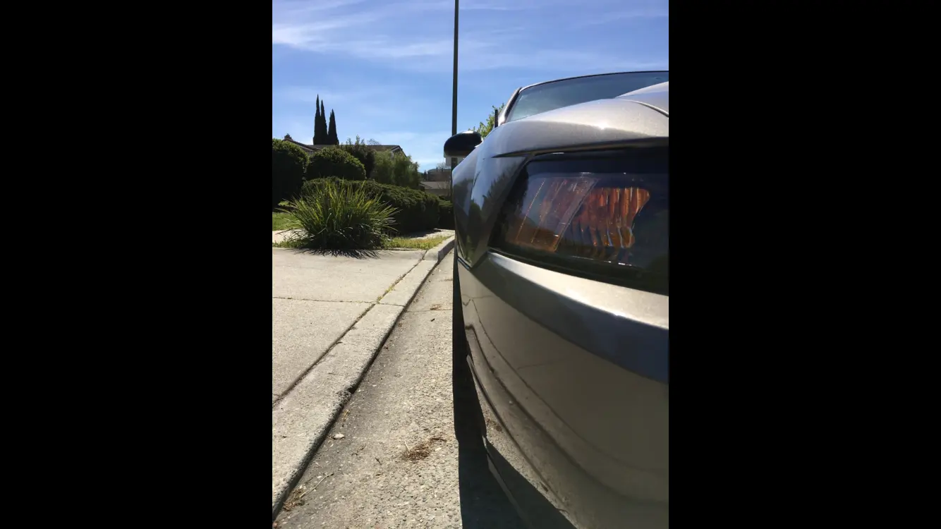

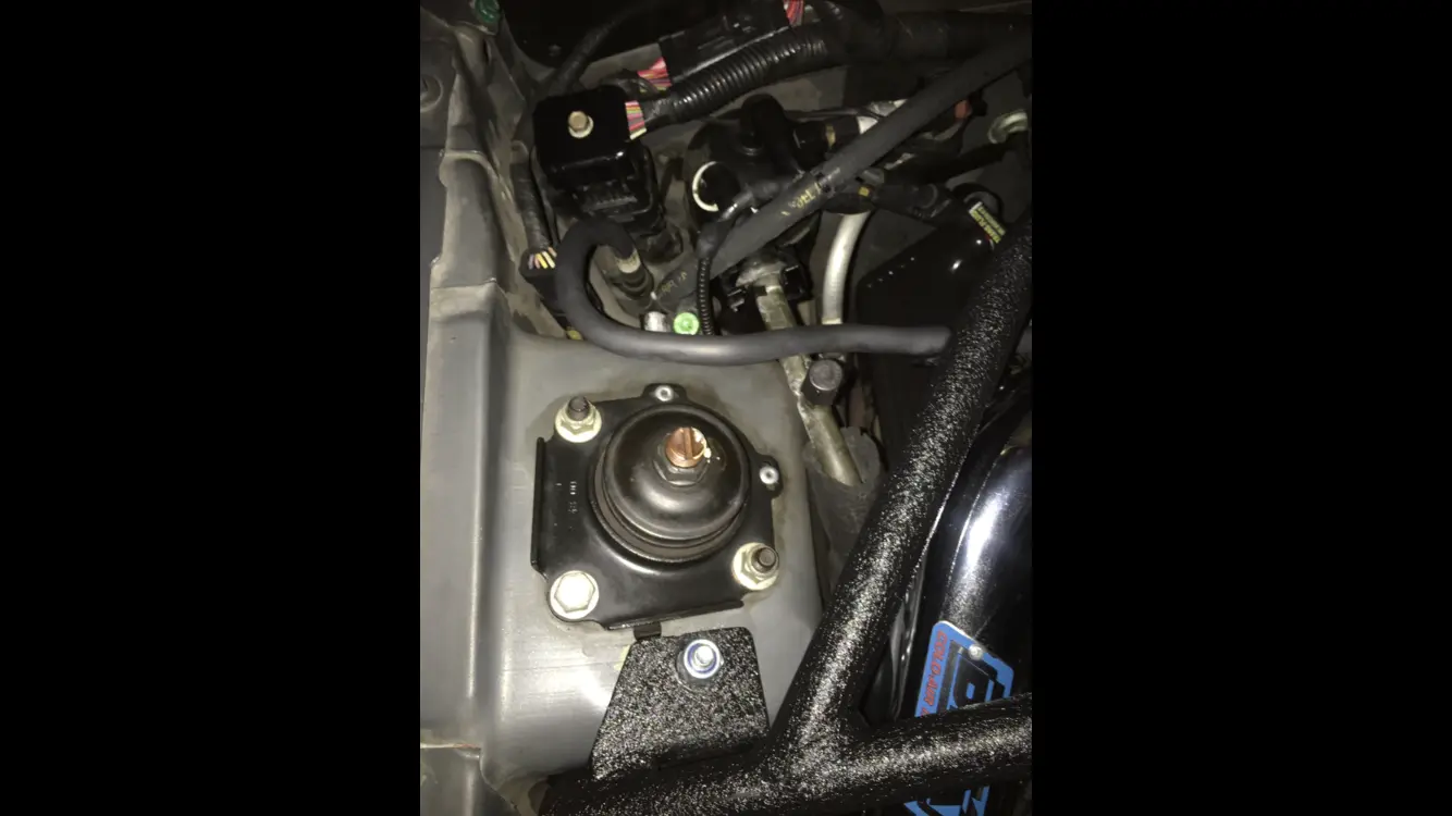

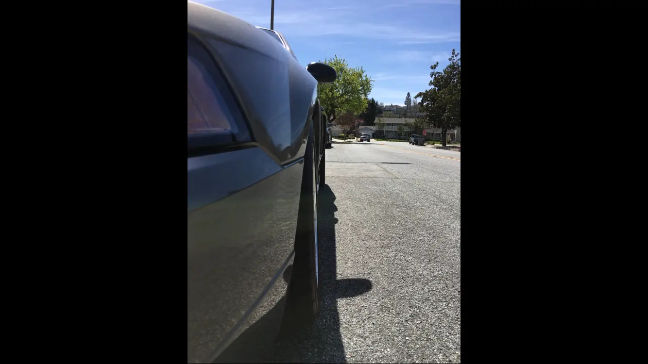

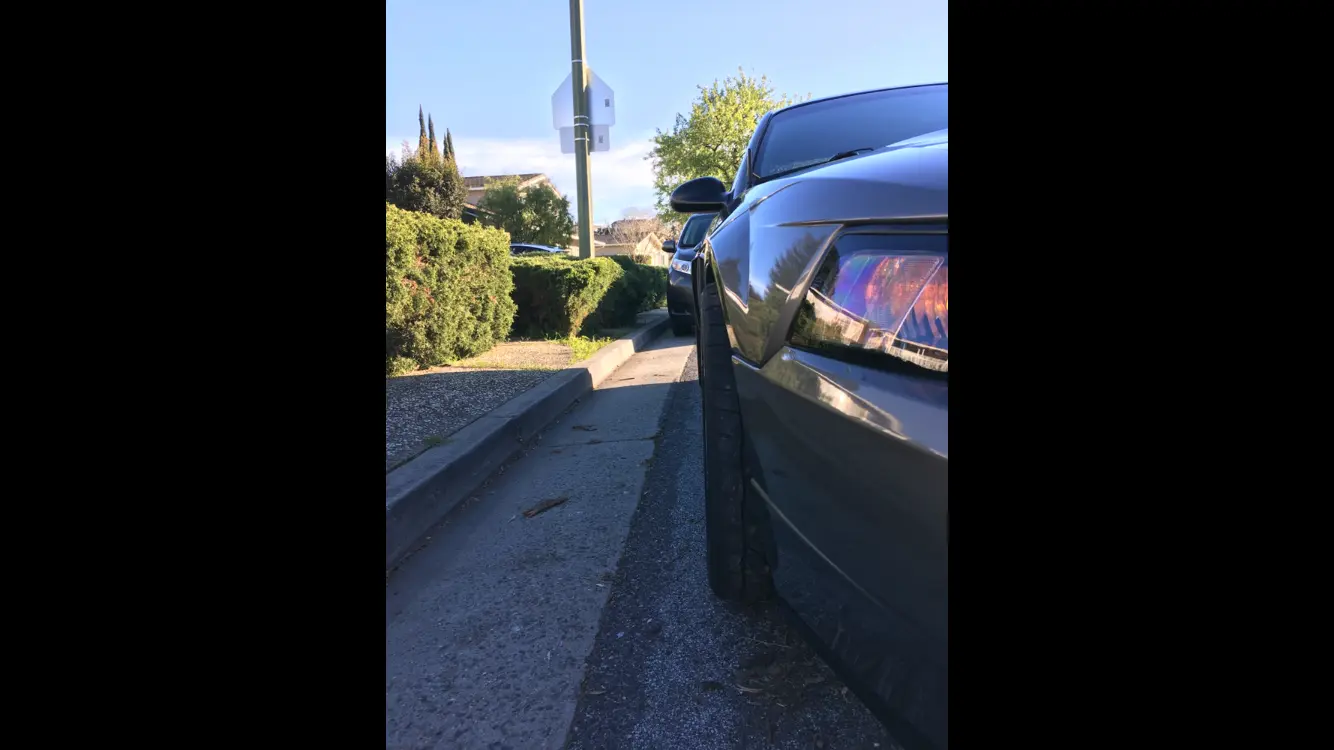

The camber on the front driver side is more negative than on the front passenger side. Purchased hubcentric spacers and that became clear. Considering that the driver side is close to flush with the fender and the passenger side isn't, (1) I'm wondering what could cause such a difference in camber, and (2) how would you go about getting the passenger side camber to look more like the driver side?
What's not/on the car:
• H&R Springs
• 3 point strut tower brace
• Previous owner mentioned it had "camber" at the time of purchase
• I don't see any signs of camber plates or bolts
Thanks in advance,
Evan

Welcome to Stangnet.
See the nuts and the bolt around the top of your struts?
You use these to adjust your caster and camber. It's not terribly hard, just takes a little bit of measuring.
Look around our '96-'04 subforums, you'll get lots of help there for your mustang. Fact is maybe start a new thread in the Tech section there about this subject. Make the title something like, "Need help with camber adjustment".
You'll have lots of people chime in to help you out.

Thank you for the direction Dave. Although I wasn't able to match the driver side exactly, I was able to get the wheel and tire under the fender with your pointer.
I will peruse through the sub forms to see how I can get them to match (either with plates/bolts/etc) with percision. Glad I joined!
