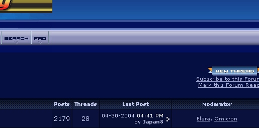

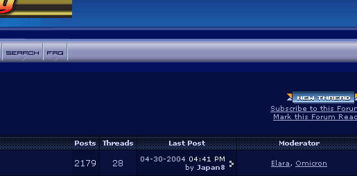

Because the 94/95 PCM is a faster processor over all, it's just more picky with cams. Also in order to run the fox computer you pretty much have to run an aftermarket ingnition system, they tend to miss/break up in the higher rpms (about 3500+rpms). The money you end up dumping into the fox swap is about the same price for a self tuner like the PMS or twEECer. Thats why nobodys does it anymore, back in 96 this was the mod to do but we're not in 96. Do a search in the 94/95 forums we have cover this subject quite a bit.
