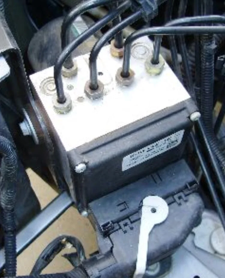

Pop the hood and look in the engine bay near the radiator fan on the passenger side. Don’t see a large rectangular “motor” with 6-8 brake lines going in/out of it.?
Looks like this mounted low in the engine bay
