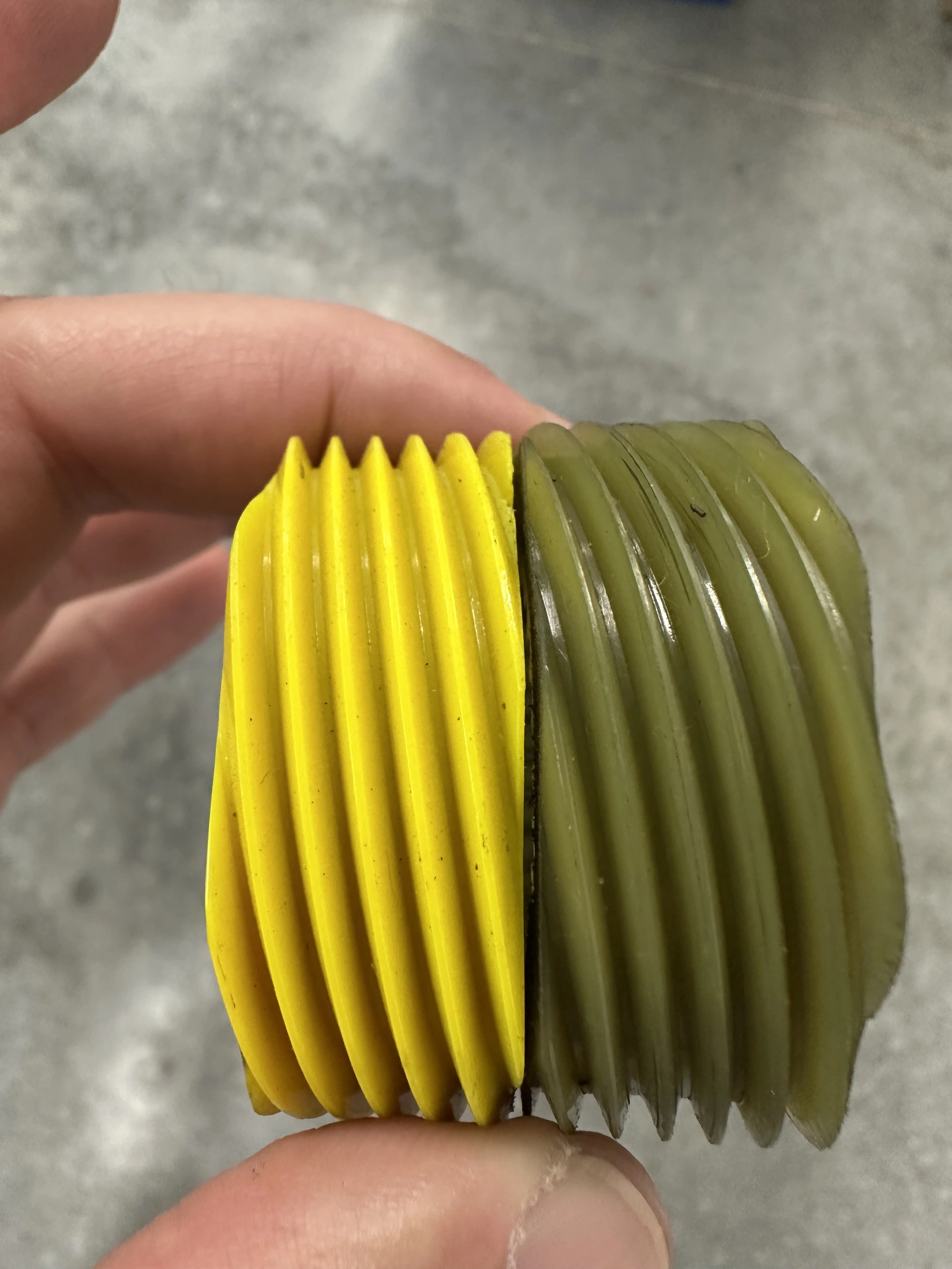

Went out in the garage and took a picture of the 7 & 8 tooth gears.
I pulled the 8 tooth out of my T5 and went to a black 6 tooth when it was gone through back in the late 2000’s. This was so I could run a driven gear that was below 20 teeth. Just for longevity as it seems the ones that are 21 tooth and up do not last.

Agreed. Don't trust my memory, just use the calculator on LMR, but I think you need a 23 tooth, which has really thin teeth that will tear up every couple months if daily driving, and will be off by a few mph at some point in the range. Extend their life by ensuring a lubed up cable with very smooth bends, but they'll still tear up. Or, you could put a 20 tooth in, that will last and at least have a reference that's 20% higher than actual speed.
