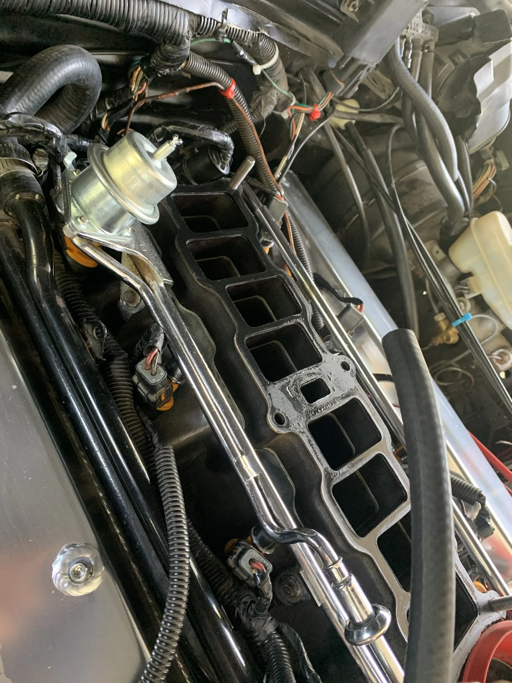

A vacuum gauge is almost a required tool to own these vehicle with all of the vacuum hoses. You had to disconnect lots of vacuum hoses to replace the lower plenum, so you could check each hose to see if maybe one is disconnected. The fuel regulator, with low vacuum, will cause high fuel pressure at idle, so it will not run well. Get the gauge, and you’ll be able to test the individual vacuum lines.

No it’s not that in this situation. I have the spacer. Another thing I didn’t mention in this post is I’m getting fuel in between the upper lower. The fuel pressure regulator is like 2 weeks old. I’m this pic you can see it’s a little wet that’s the fuel
