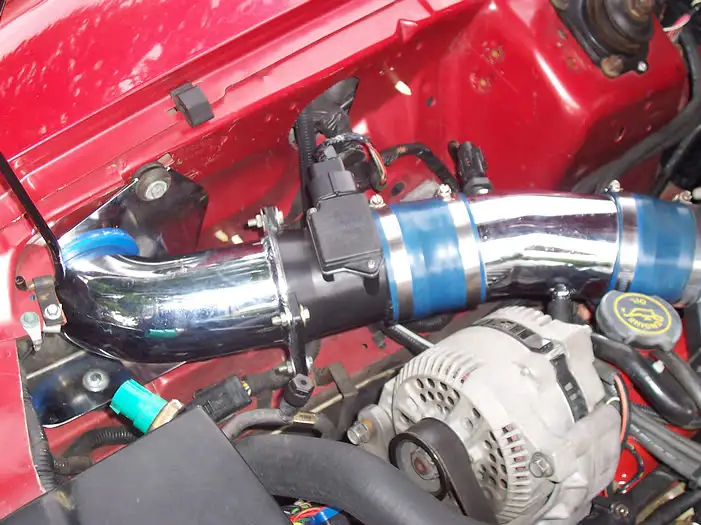

Mine friend have stock MASS from his 01 Bullitt because he get 95mm PRO-M , he wanna give me his to try , so I wandering can that fit on mine ,I mean fit with bolt pattern and with conectors
First you'd need a PIGTAIL that connects his wiring to your wiring. (Pro-M has them). Then you'll need to recalibrate the meter. It costs 100$ from Pro-M. Not worthes IMO. Its better to get a Pro-M 80mm that comes with a big air filter for 200$ shipped, brand new.
99 GT+ have 80mm and they have 4 prong just li we 94-95 GTs have , color of wires is same except we have one wire different name than 4.6 ,they have "REF" I think
Tonight my frined supposed to bring MASS , so I will let you know if that works
Hey guys guess what Bullitt MASS air meter works , tube fit except MASS meter (4.6 have different connector than 5.0 but soon I will find that connector from 4.6)
