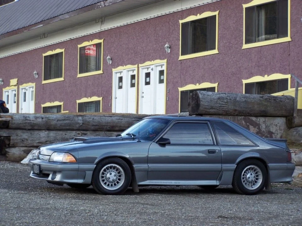

spot putty put on with your finger,worked into all the little holes and marks,sanded smooth,check for imperfections,any noted,do it again untill it's smooth as a baby's bum,apply grease and wax remover ,apply primer then duplicolour oem satin black and you'll have saved yourself about 400 bucks
Did mine on the 88 and also did the mirrors and bumper cover on my 81
